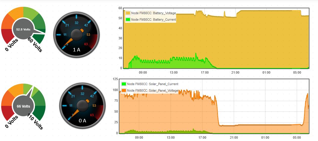

Hi guys,
Seeing you guys are doing wonderful work here. I have no php knowlege but will be happy if you guide me. I have a csv file that gets generated every 20 seconds. I have installed emoncms but cant upload the data.

I need to build those beautiful graphs guys.

The 'address': 'A' would be an issue for emoncms as it only accepts numeric data so I have simply excluded it, if it is data you need then you will have to fashion a way of converting it to a number and send that instead.
So I have altered the matecom.txt to send a json request to emoncms so that the field names are used, otherwise all that code would be useless too, The data is actually received from the controller in a CSV format and the original script converted that CSV to a key:value json-like dict, applied some scaling and appended unit strings, You then removed the text from the strings (that continued to be appended) and converted the dict contents to CSV, to be written to file.
You will need to edit the script below for your own emoncms domain/IP and apikey, you can also change the node id, I only set it to 30 so as not to clash with any frequently used node ids. The node id is used in emoncms to group the inputs as a single source/device. thinking about it now you could probably even use `nodeid=ā€œOutbackCCā€ rather than a number.
This isn’t intended as a finished item, there is no error checking or handling, but nor is there in the original script, if a non-float slipped through to one of those lines containing calculations, it would crash, likewise if the serial connection wasn’t successful.
Currently if the request send fails it will crash, if it is a successful send but the response isn’t ā€œokā€ it will not try and resend, so there is plenty of scope for improvement. You could also break out the domain/IP, apikey and nodeid to variables etc.

I hope this works for you, it will at least get you going in the right direction.
@pb66
I am extremely grateful for your assistance. I will try it out and give you a feedback.

@pb66 It worked flawlessly. I am grateful.
@pb66 @Bill.Thomson @RobertK @Robert.Wall
So guys, I feel it will be incomplete if i dont share the beautiful graphs from my solar setup. It is simply amazing. I am grateful to all of you. I now have real time graphs and a good insight into my 3kw Solar Setup.
