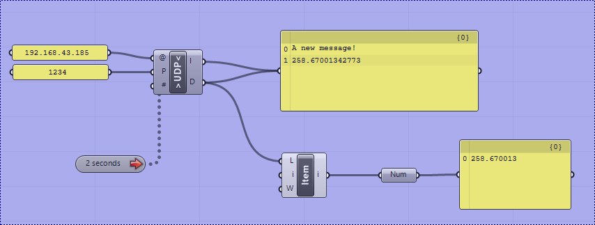

grabbed from emoncms every 10 seconds, posted via UDP…
done:
import requests
import socket
import threading
print("simple code to grab data from emonCMS and then UDP broadcast it every 10 seconds")
#requests code
response = requests.get("https://emoncms.org/feed/value.json?id=USERID&apikey=APIREADYKEY_APIREADYKEY_APIREADYKEY")
data = response.json()
print("data from emoncms server:", data)
print()
#socket code
UDP_IP = "192.168.43.185"
UDP_PORT = 1234
print("UDP target IP:", UDP_IP)
print("UDP target port:", UDP_PORT)
print("data to send:", data)
sock = socket.socket(socket.AF_INET, socket.SOCK_DGRAM) # UDP
sock.sendto(bytes(data, "utf-8"), (UDP_IP, UDP_PORT))
print ("first data sent", data)
#threading code
def printit():
  threading.Timer(10.0, printit).start()
  print ("data sent", data)
printit()

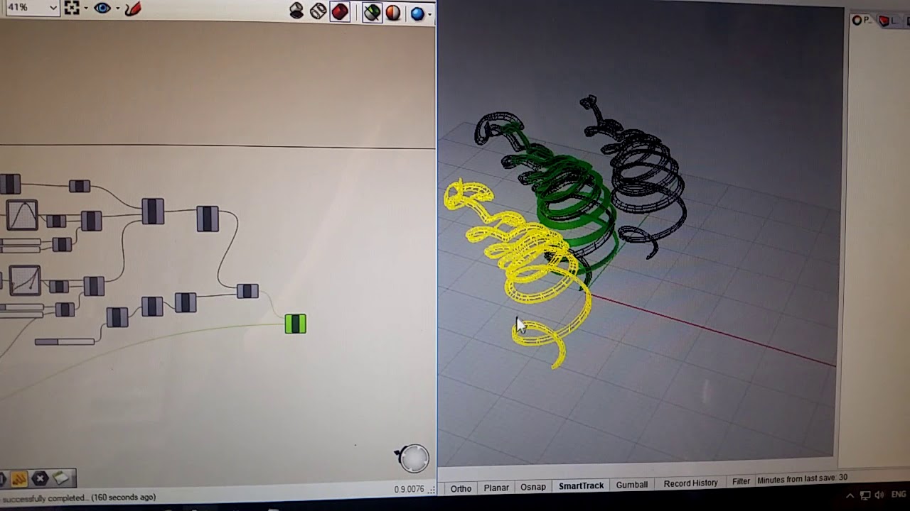

Python’s ace.
Real-time 3D modelling and visualisation from emonCMS next :wink:

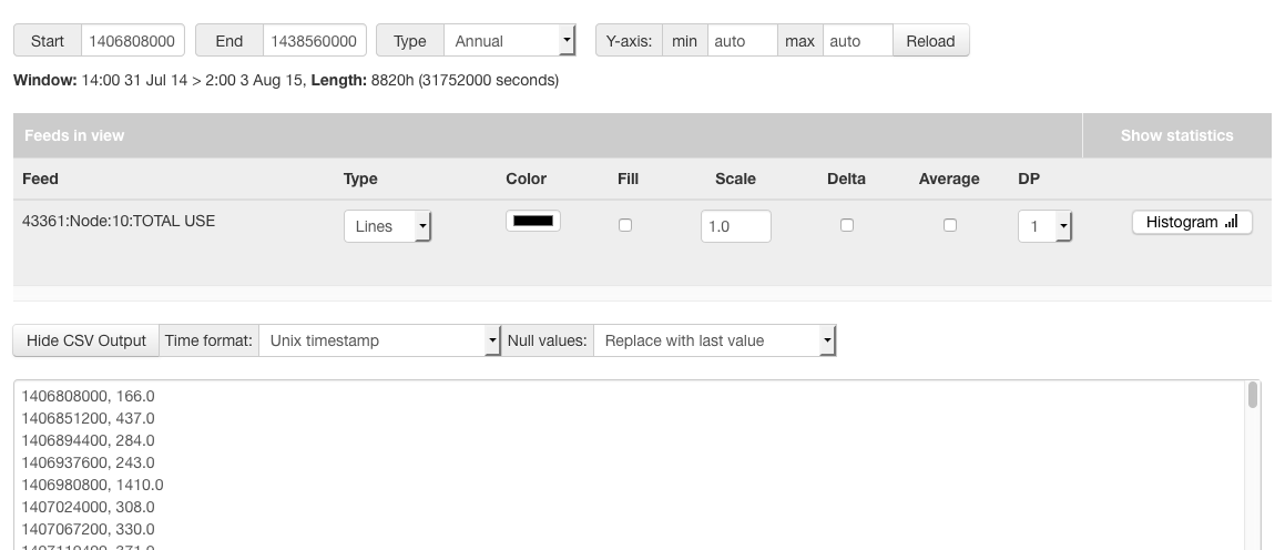

I tested this out of interest. Do you know the exact format? I’m not having any success with it.
I’m using this to get historical data:
response = requests.get("https://emoncms.org/feed/data.json?id=43361&start=1446624000&end=1446824000&interval=10&apikey=b9033cf185b17ea192d3****60b9dca2")
And I get returned this in python:
data from emoncms server: []
Do I need to format or parse the data in a particular way?
[Edit - Apikey part-obscured (RW)]
When I recommended the “fetch” api I believed you were running this continuously and that just the latest data from several feeds was required to keep it updated. The “fetch” api won’t return historical data.
All the feed and input api’s are documented on the pages accessible via the link at the top right of the feed and inputs pages of emoncms. or at Emoncms - site api and Emoncms - site api
The issue with the example you give is most likely the timestamps, I believe they need to be unixmillis
response = requests.get("https://emoncms.org/feed/data.json?id=43361&start=1446624000000&end=1446824000000&interval=10&apikey=b9033cf185b17ea192d3****60b9dca2")
The response you get from this will be a list of timestamp value pairs eg [[1446624000000,100][1446624010000,101][1446624020000,101.9876]..... and so on, I assume it will need parsing but what that might entail will depend on what you need or want to do with the data after it’s landed.
I have two aspects to my project.
To use ‘fetch.json’ or ‘value.json’ or ‘timevalue.json’ in realtime, then post to UDP.
To use ‘data.json’ in to get historical data.
Using ‘data.json’ or ‘average.json’ in python hasn’t worked for me, the unix timestamps I’m using in the script are identical to the browser csv export unix timestamps. I’ve toyed with the interval, no change.
Perhaps it’s a datatype issue… Perhaps the ‘requests’ lib I’m using is not the correct one? Or there’s some small user error I haven’t found yet. I don’t know.
