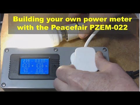

Teardown and review of the PZEM-022 here:
(according to the video-clip creator the CT is at line voltage! (8:55 into the clip)
From what I’ve read, the -022 doesn’t have any form of output other than the display itself.
Bummer…
At the risk of further advertising my ignorance, is it practical to try and see if the display signals can be used for this puporse? Or is it possible to see if using JTAG will provide something like that?
Thank you for the link. that was helpful.

Is the insulation on the CT cable rated for mains voltages? It’s hard to tell in the photos but it looks a bit lightweight.
if all else fails you could try PZEM-016 or - 014
Good question. I’ve no idea. But you’re right, it does look rather wimpy.
