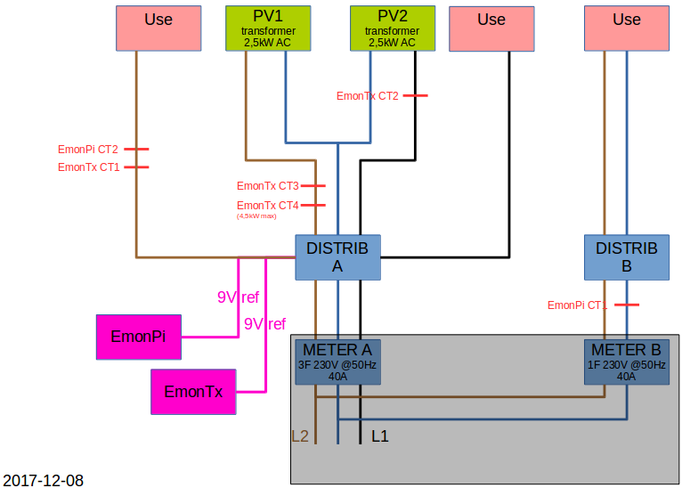

I’m on a grid with 230VAC @50Hz. The local grid has two phases (L1 and L2) at 230VAC referenced to ground. There is also a “neutral” wire which is 0V referenced to ground.
I have two meters. Meter A is connected to both phases and the neutral wire (2F+N). No fancy stuff for meter B, this one is connected to one phase and the neutral wire (1F+N). The schematic shows the phases (black/brown) and the neutral (blue) wiring.
With a volt meter, I do not measure 400VAC between L1 and L2 (as would be the case for 3F+N systems). The volt meter measures 0V difference between the two phases. So quite surely, they are not 120 degrees apart. So, I was inclined to think these two phases are actually “in phase”.
After measuring these phases with an oscilloscope, I saw they are not in phase, and neither are they 120 degrees (6,6ms) apart. They are about (3,3ms) apart, i.e. 60 degrees.
I have an EmonPi and EmonTx with 9VAC reference on L2. This happens to be the phase the wall socket is on. On L2, I normally get a positive consumption, unless I activate an induction cooking plate (connected to both L1 and L2). If I switch on the induction plate, the measured power on emonpi current transformer 2 goes negative.
Anyone has an idea why this faulty measurement occurs? Something wrong in the way I’ve connected CT2 of the EmonPI? Or anything else in the setup?
I’m quite sure the CT’s are connected on the phase wire, not on the neutral. Perhaps real vs. apparent power has something to do with the (inductive) load?
Something there is not correct, because you cannot have two waveforms 60° apart, yet measure 0 V between them. Your oscilloscope picture does show a voltage difference - it is the vertical gap between the two traces. Are you absolutely certain that 0 V was the true voltage, and not just a bad connection with your meter?
I can understand the 60° part. That will come about if you have a 3-phase, 3 wire system. Then, treating one phase as the reference, the other two will indeed show a difference of 60° between them. But I’m not aware that Belgium uses that system. [Edit - Further digging reveals that this configuration was used in Belgium, and might still be present in very old systems. Is that the case for you?] As far as I know, only Norway uses a 230 V 3-wire system, but there, each line is 132 V to earth.
The 60° also does not make sense for your induction cooker - unless there is also a neutral connection and the two phases are treated as two separate feeds.
I shall believe for now that you do have what looks like a 3-phase, 3-wire system, but with one ‘phase’ being the neutral. (I cannot call it a 2-phase system, because that would imply 90° between phases.)
Your error is using the voltage of L2 for the reference for L1 current. That will never give the true real power reading because of that 60° difference between L2 and L1.

I repeated my measurements between both waveforms: I now measure 230V AC between both phases. It was indeed a bad connection with the probes of the meter. I could also measure 11V and 25V depending where I touched the contact point with the probes. This confirms your analysis: I have a 3-phase, 3-wire system with one phase being the neutral.
I also verified earlier measurements with reference to ground. L1 and L2 are obviously at 230V. The “neutral phase” (sounds really contradictory to me), is not at exactly 0V as I would expect it to be. I measured 3.7V AC. I wonder if that 3.7V AC is also 60° out of phase with the “real” phases. But I digress.
The induction cooker came with instructions on how to connect to 3F+N (400V) and 1F+N (230V) system. Since it has a total combined power of 11kW (48A at 230V), it’s too much to connect to just one phase. My main circuit breaker (40A) would blow at maximum power draw.
Lucky for me, the cooker is split into 3 zones. You can see at as three separate cookers. Each zone can draw a maximum of 16A @230V. If I recall correctly, I connected 2 zones to one phase (and neutral) and 1 zone connected to another phase (and neutral). So I treated the two phases as separate feeds.
Pure and utter laziness :slight_smile: Or just eagerness to connect things and start measuring. The wall sockets nearby all happen to be on L2. I would have to install an additional wall socket connected to L1.
For your information, in my initial setup, I had all CT’s around the same stretch of wire (L2). Just to verify the whole system was measuring and transmitting these measurements. Good thing I did, 'cause I learned that for the EmonTx, you have to flip the CT’s in the “wrong direction”. For the EmonPi, the arrows on the CT’s point in the same direction as the current flow.
Shuffling around the CT’s a bit would result in this design (yet to be implemented). EmonPi is referenced to L1, EmonTx is reference to L2.

I think that will give you the correct answers. But why two c.t’s on the same cable?
Absolutely agree! That’s exactly how I go around when working on electricity. Even if there appears to be no voltage on the wires, I will even switch on the breaker first to see the voltage drop when I switch it back off.
For historic reasons :slight_smile: I initially connected a bunch of CT’s to the same wire. Just to validate measurements and a basic accuracy test. I have already moved a CT onto another wire and i will move another as soon as I see fit.

This is the situation since yesterday around noon:
As you can see, I disconnected the voltage reference for the EmonPi. Simply because I don’t have a wall socket with L1+N near the EmonPi yet.
After disconnecting 9VAC reference, EmonPi is giving me 0W reading on both CTs. I already rebooted the EmonPi to no avail. But that’s another issue.

Correctly summarized. Everything should be connected to N and another phase (L1 or L2).
I just tested the socket of the washing machine by measuring between earth and both poles. You guessed it already: I get 230V in both cases, so this socket is not connected to N and another phase, but to phases L1 and L2. Works electrically fine off course, but causes negative readings. So next up is to fix this in the distribution box. I’ll do that when the sun is out again. Makes life a bit easier :slight_smile:
I’ll probably have to review/measure the induction cooker as well…
We’re getting there…
The only ‘problem’ with the washing machine wired as it is, is you cannot, unless you put a separate monitor on it taking a voltage reference L1 - L2, or generate a delayed voltage reference inside the emonTx, read it’s real power directly. But I repeat, adding together the powers from all 5 c.t’s will give you the correct total power.
