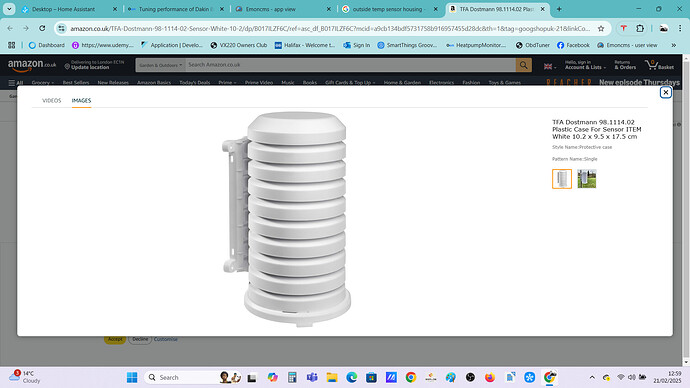

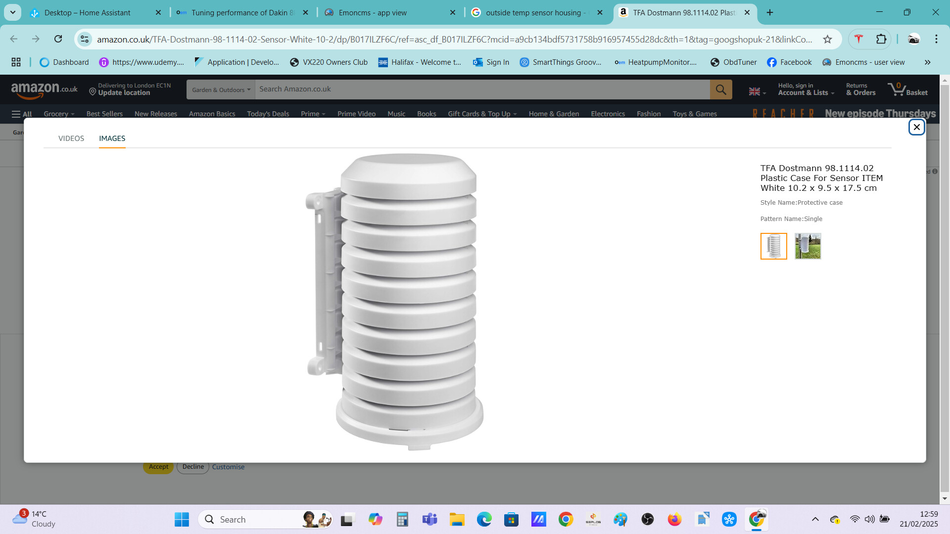

I have mine outdoor temperature limit set to 30c!
I had to, because my remote outdoor temperature sensor is on a NW facing wall and at one time of day it gets some sun on it and records a much higher outdoor temperature.
I found this out when my heating suddenly turned off one day, it was about 10c outside but the temperature sensor was showing much higher and had exceeded the heating off threshold.
It took me a few minutes to work out what had happened as it was early days with lots of other issues.
can you add a sun shade to the sensor so the sensor is always in shade and dose not get affected by solar gain ?

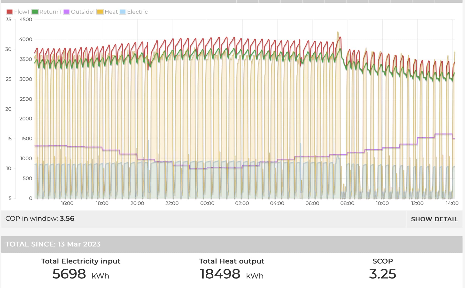

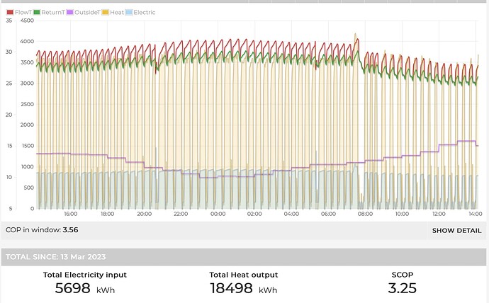

As you can see by this chart I am having trouble with the HP and outside temperature ( current outside temp is 16°C:
Reading comments it would appear ( if you are running LWT and WC ) you have to adjust the settings for outside temp in the MMI and this should turn off the pump when upper limit is reached. Would the problem be deciding the upper temp limit, be a bit hit and miss as this time of the year as we do not get many warm days, so have to keep changing limit. Otherwise you have to manually turn off the HP through the Onecta?
Am I thinking correctly on what is happening.
You believe you have found a steady solution to running your HP and it throws something else at you.
No. Just don’t set it too low!! It’s unlikely you need heating at 20C external, given people, cooking, DHW cooling etc, so anything less than that that suits you. You could try to find the equilibrium temp, where the house is neither cooling nor warming given the usual inputs, it’s usually 15-17C.
What’s the internal temp you’re aiming for? It’s not on your graph here. If you’re above that, then you might consider setting the max external temp for space heating to 16 or 17, because you don’t need it, and then it won’t cycle madly.
At some times of year, a simple boost button that turn on CH for an hour with fixed flow temperature is likely to be best option.
our home has raised to 23 degrees today but dont want my flow temp any lower than the current 29 , so i have put the setting to shut off the heat pump at 15 degrees C and see how we get on
Thanks. My wife is not very well so I am aiming for 20/21°C in living room and 18°C in bedrooms.
