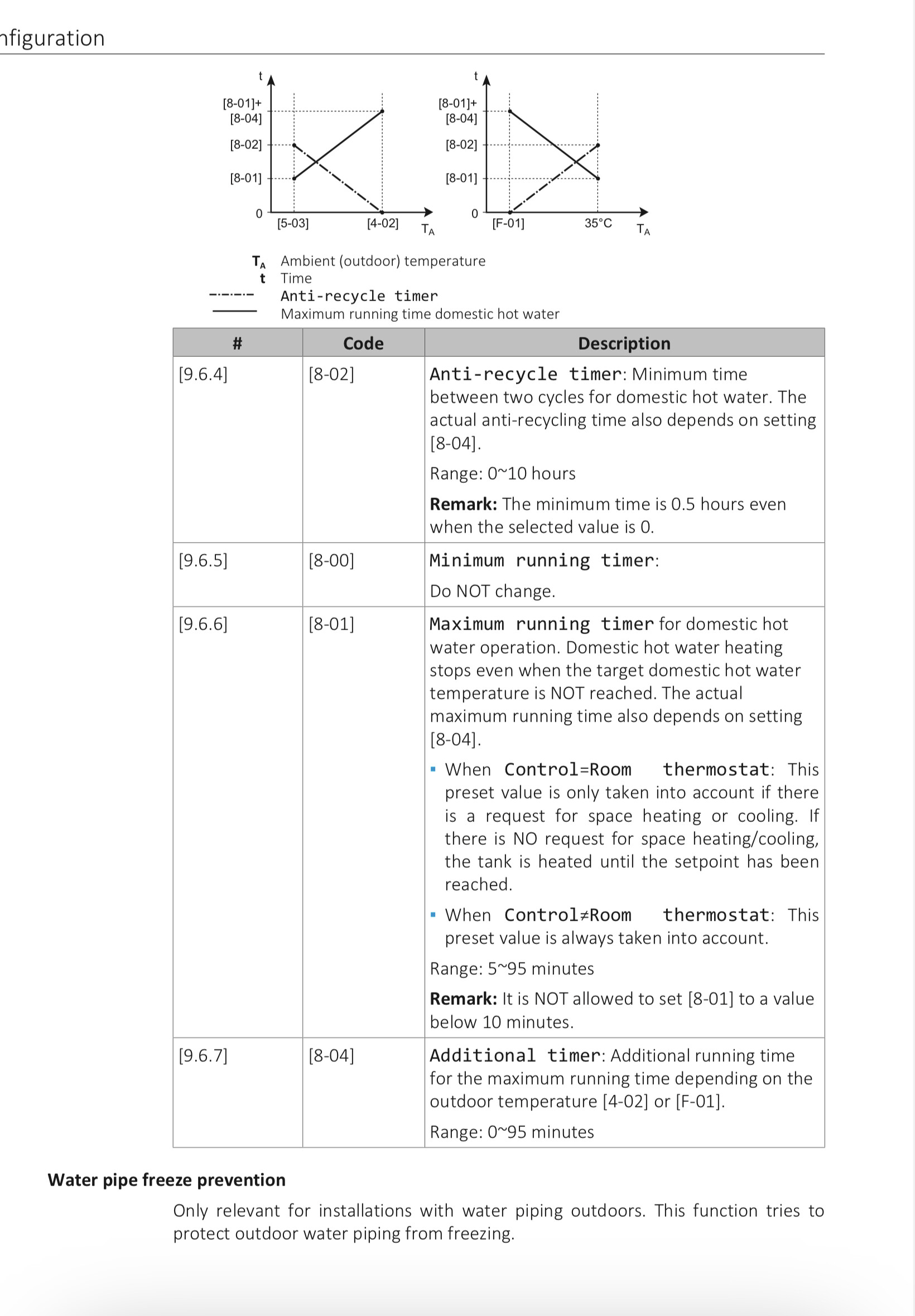

have you tried increasing the maximum run time for the hot water cycle
The schedule was for up to 3 hours.
It got to 40C and went back to heating the house after about 1.5hrs.
Plenty of time I would have thought left not to scare it off.
As a compromise for now, I set the Comfort temp down to 45C.
It pulled that up no problem in short time and went back to heating house.
Will see how we get on with 45C for now.
Would like to get COP friendly ECO setting working though.

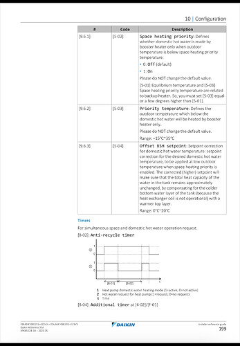

You may need to check the below setting
Space heating priority, Maximum running timer, Additional timer and Anti-recycle timer.
I had a issue where sometimes my DHW would stop heating before it got to temp at radium times and temp. this was down to max run time
