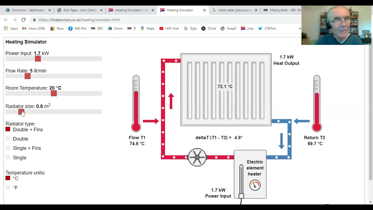

Although this doesn’t answer your question, I found John’s video quite informative:
thanks @MyForest - that is helpful background!
