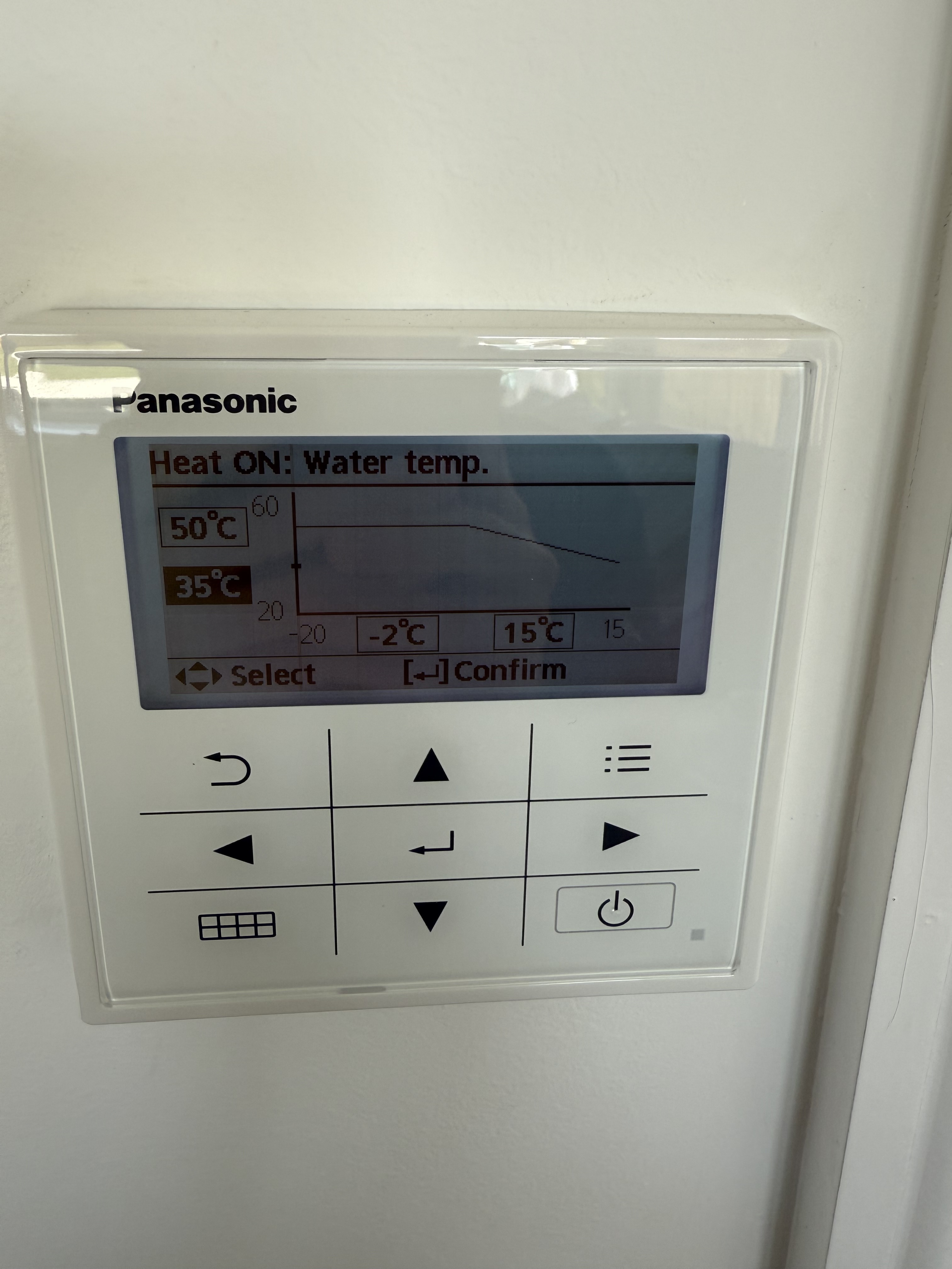

Hi, new user of a heat pump in a new build. Been using it for the last two months always set to the same temperature between 20 and 22. I still feel cold at night and in the morning. How to set up weather curve on my heat pump which is a Panasonic WH-MDC05J3E5? Please help! I would be very appreciated

No i dont think its achieving those temps.
I have been tweaking the settings and i think i messed up. I really need help to set up compensation curve and whatever needs doing.

  1. I’m not familiar with Panasonics, but can you not ask your installer to help you with this?
  2. Your operating manual https://webshop.kinnan.dk/upload_dir/shop/Brugsanvisning_-WH-MDC0579J3E5.pdf seems a lot more user-friendly than some other makes (e.g. my Samsung manual didn’t survive translation from Korean too well). It appears that (I’m looking at p30) once you are in Installer mode, under Heat settings you want to start with something like X1 = -2degC, Y1 = 50degC, and X2 = 15degC, Y2 = 35degC. These appear to be very easy to set using the left/right and up/down buttons. Once you have this setup operating OK you can slowly reduce Y1 until the heat pump keeps your house just warm enough even when it’s sub zero outside.

Hi, thanks for your reply. Is this what you mean?
Yes, that’s it exactly. :slightly_smiling_face:
The “equation” those particular values gives between -2degC and 15degC ambient temperature is LWT = 48.24 - (0.882 x ambient temperature). Below -2degC ambient LWT will be 50degC; above 15degC ambient LWT will be 35degC.
You can test that this is being correctly applied by looking at the ambient temperature and the LWT on your display at any time the HP is running. The actual LWT you see should be the same as you can calculate from the above equation.
