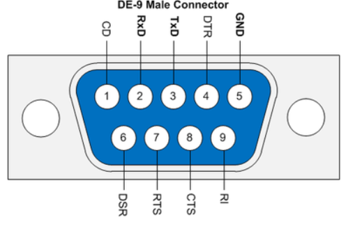

Hopefully a silly question: you did count the pins from the correct end?

Pin-check and double check;
Using the image below for pin numbers on the MALE connector on the TI-M12 side;
I double checked if the contacts on the female connector correspond to numbers 3-4-5 on the male one using a multimeter to see if the screw terminals were connected to the correct pins and they are.

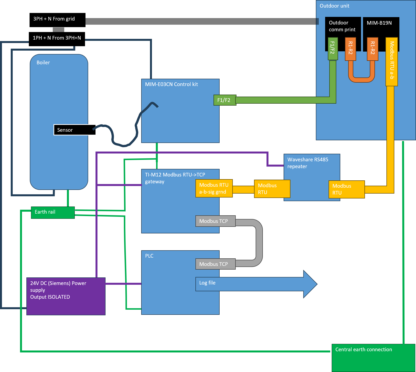

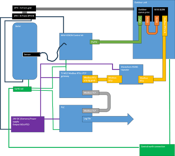

Going back, the data connections are in the image on post no.29, but you have now changed the details by adding the RS485 repeater. Could you provide a drawing as it now is – or will be with a good data isolator, and add the power supplies, whether they are isolated or not, the zero volts connections, cable screens and all the earth connections and show whether these are connected to a common earth point (and whether buried metal or provided by your electricity supplier).
I have my own buried earth connection (some pin rammed into the ground at ~20m cable length from the sketched setup.
As the waveshare repeater got burned up it is currently not present but this is what it would have been had it stayed in good condition.
Is this sufficient or is there anything else I should illustrate?

Now with my DC power supply being galvanically isolated from the 230V net I would think that essentially my RS485 should be totally galvanically isolated.
From the 230V net via the DC power supply
From ethernet and chassis ground via the Trendnet.
Am I correct?
Yes, but the galvanic isolation is in the wrong place. With Ethernet you normally get galvanic isolation at the point of connection with miniature coupling transformers, so I guess that is what they are describing, everything else inside the unit is electrically connected together. So while your power supply is internally galvanically isolated interference can get in through the wiring or the PLC. Ideally the galvanic isolation should be at the RS485 transceiver so interference injection can easily be controlled. This is the idea of the isolating repeater, you haven’t got an ideal device in the T1, so you approximate the ideal.
When in the dim, distant past I used to design hardware for distributed industrial control systems, the gold standard for EMC was 3 port isolation. The power input is galvanically isolated, the inputs are galvanically isolated and the outputs are all galvanically isolated from the internal electronics. You have imperfect single port isolation, on a compact system it would probably be OK.
So personally I would still try the isolating repeater, that would at least confirm the theory (guess?) it is conducted interference.
