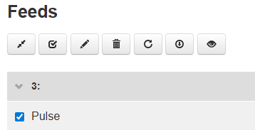

I have an 2016 emon system (emonpi, 2xTX, emonth) with six years worth of data (100+ feeds) on the current SD card which is looking about full.
I have purchased a new preloaded SD from the shop and am in the process of thinking how best to transfer over (with a bit of much needed cleaning up along the way).
The system is used for monitoring and control of a completely off-grid property and has become somewhat indispensable. Historical data is important for decision making on a daily basis as well as a useful tool for monitoring the health of individual bits of the off-grid set-up.
I had imagined I would simply have to download csv data to date for reviewing and start the new card with no history. However the trim data feature that has appeared at some point suggests I could trim the data before back-up to something smaller (say 2-3 years) and transfer over. I have found no confirmation of whether this actually works ok other than a couple of queries a few years ago questioning it.
Can anyone confirm it does work for my purposes and is this a sensible way to proceed anyway?

Best way is to use the USB transfer method.
Update & Upgrade — OpenEnergyMonitor 0.0.1 documentation
You can Trim or Downsample the Feeds.
Trim is hidden under the Delete icon.
Yes the trim feed works and seems sensible way of doing it before you transfer the data.
As ever, backup first :slight_smile:
You might decide to keep the old SD as the backup, transfer the data (might take a while) the trim/downsample the data on the new system.
Thanks Brian
I have had a look at the trim feature and was unwilling to actually start doing anything before checking as I assumed a mistake or malfunction would lose that data. I will try it with a feed I no longer have use for - there are quite a few of those as my housekeeping is not that good.
Join the club.
I’d take a backup first, but as I say, if you are running out of space that may not work.
Doing the upgrade and transferring the information will means the old card will act as a backup and you can trim from there.
The data is just held as a text file & meta data file so restoring individual feeds is possible.
