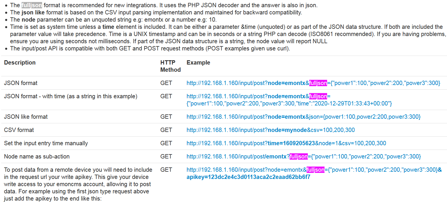

This is the first thing that came to mind. It may not be what’s causing your problem, and if it’s not,
then if nothing else, you’ve eliminated one source. :wink:
There are two variants of the API that handle JSON. One handles “JSON-like” strings, the
other handles valid JSON strings. Here’s a screenshot of the emonCMS inputs/api page

Can you also post where this input is coming from, The Raw JSON being sent to emoncms, and the debug log of the sender, please?
Can you check the value sent is not in quotes - numeric values in JSON should not be quoted.
