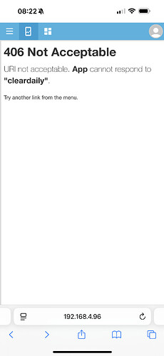

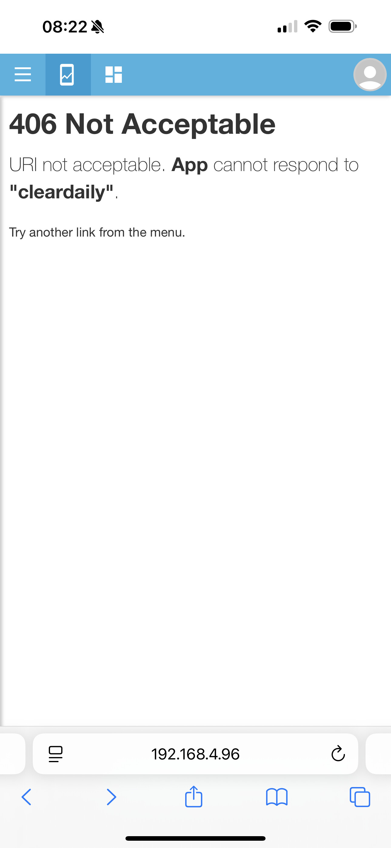

Thanks Tim – I am not seeing an option in Heatpump app to enable the daily pre-processor. And I get an error when replacing view with cleardaily
Okay, so it’s not that then, as you’re on an older version of emoncms that doesn’t have that feature.
