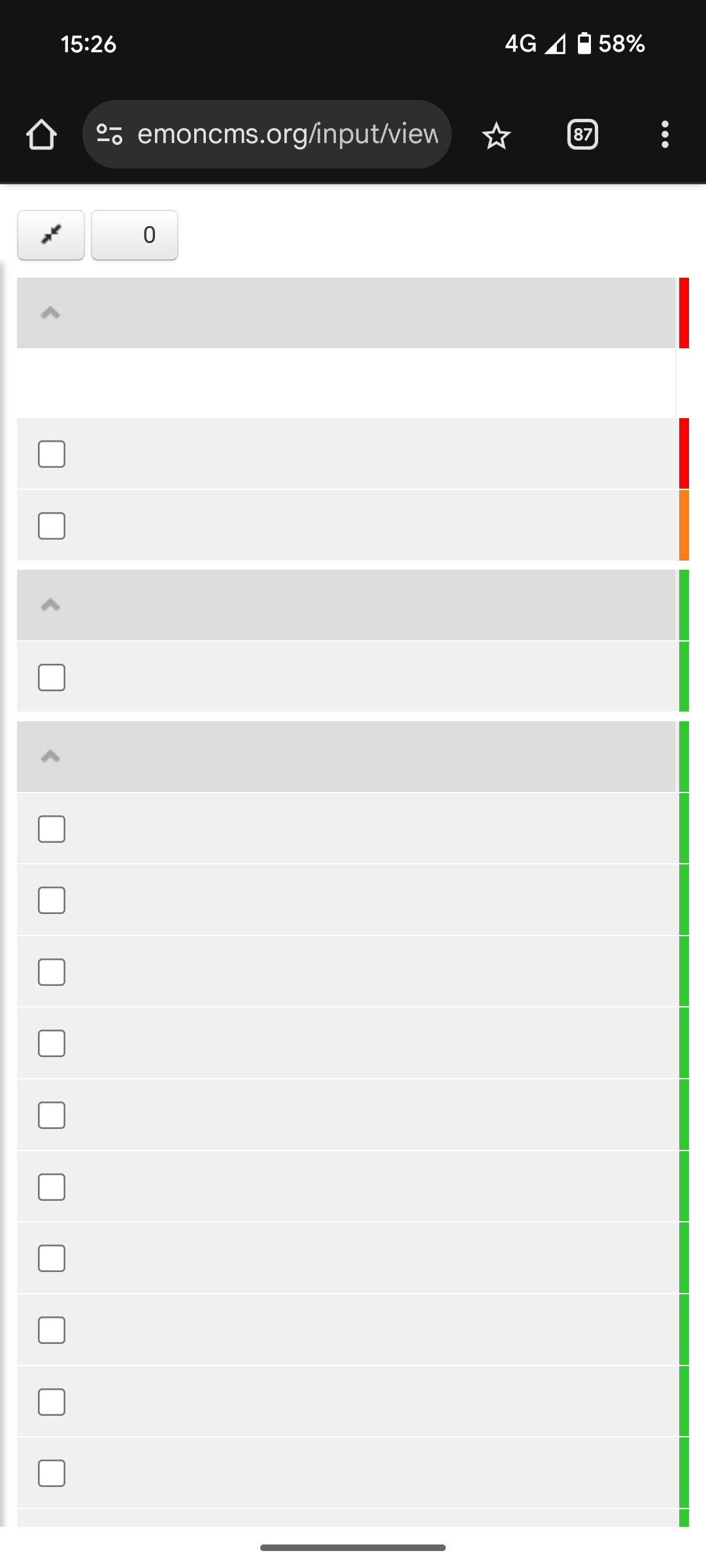

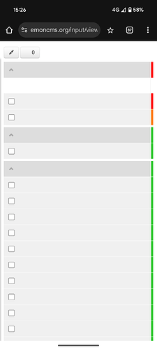

Ive still had no luck with HA → emoncms even if I rename the input node to an integer like 19 it still doesnt work. :dotted_line_face:
I’ve tried altering my HA config to specify an input node id that doesn’t exit on emoncms and this then gets created by the first write, so something else is up with your settings.

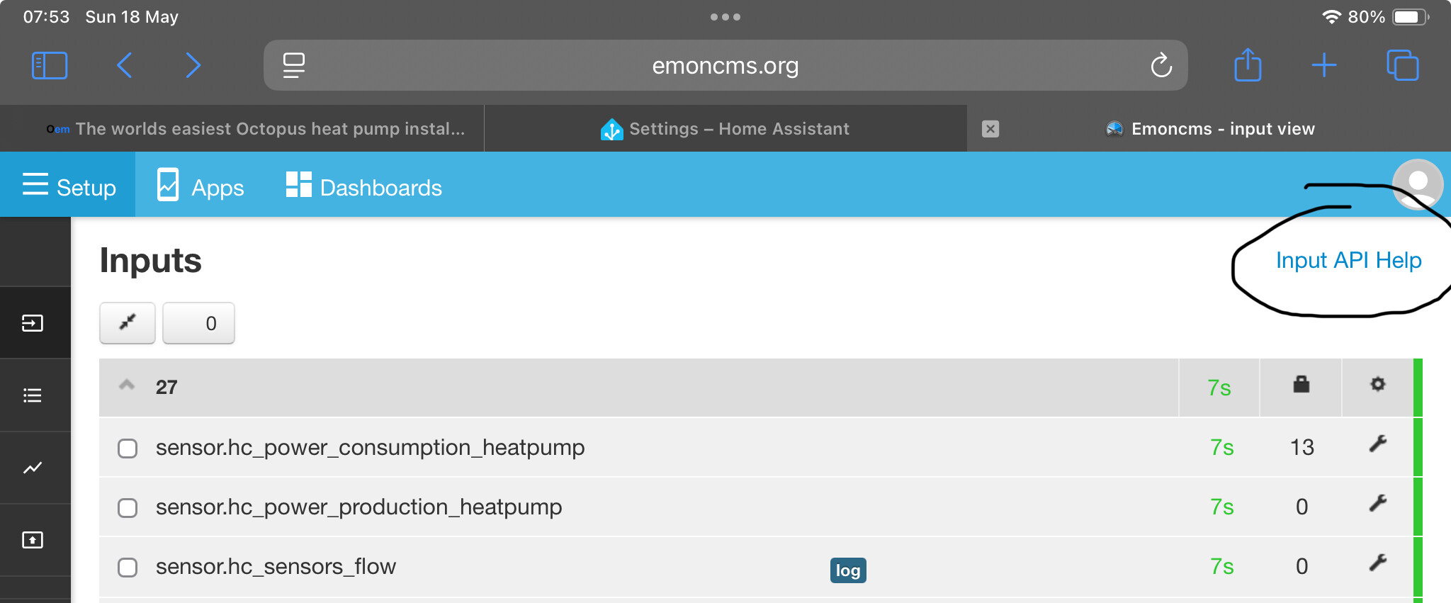

Can I check you are using the read/write key listed under input api help?

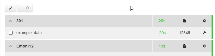

Thanks for looking, I did a manual get via browser and it added the test node ID I used (301) like you described. Yes i’m using the right read/write API key.
https://emoncms.org/input/post?node=301&fulljson={"example_data":12345}&apikey=************************)
chrome_8jRbV9Cl67
I’m not exactly sure how to get debug logs from a core HA component, but i don’t know why its not working.
The sensor looks valid to me also.
I’m quite impressed with the heatpumps performance. It seems to have a 3 minute heavy start up, then takes about 10 mins to get to a target return temp, then modulates very nicely. Its not cold enough here to try it for long though. If they can sort the vibration ill be well impressed with it.
Ok I found how to get debug logs.
2025-05-18 02:55:22.624 ERROR (SyncWorker_17) [homeassistant.components.emoncms_history] Error saving data '{sensor.octopus_energy_heat_pump_00_1e_5e_09_02_ba_5a_f0_live_outdoor_temperature:11.3}' to 'https://emoncms.org/input/post.json'
Looks to me like the core component is not formatting it into valid json?
payload = ",".join(f"{key}:{val}" for key, val in payload_dict.items())
Its using string formatting looks like and forgets to quote the keys.

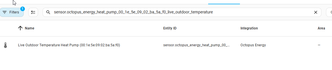

Maybe the colons in the sensor name or the length of it also looks quite long. Can you remove it and for a test replace with another sensor with a short name?
You’re getting closer :grinning:
I have a hazy memory that there is both a length limit for the name and a restriction on the character set. Sorry, but I can’t remember either when or where I saw it, or even whether is was sending to or receiving by emonCMS.

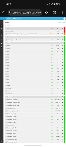

Ok I shortened it and something happen. :joy:
Desktop mode success!!!

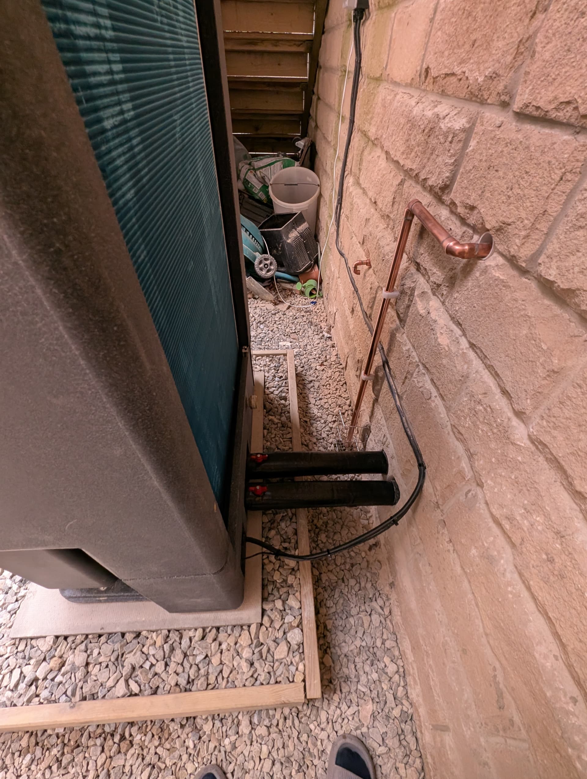

If the unit were hard mounted to a concrete mass (not free to vibrate on what looks to be a paving slab over rocks) and they piped it up with “hard” pipe but in a “Z” dogleg you might get away with hard pipe.
As installed it appears that you have a washing machine on a loose wobbly base (paving slab on top of some rocks? or is that actually a concrete pad that the unit is hard bolted to?) that’s anchored to the inside of your house using hard copper pipes as the only restraint?
If it’s fan balance or unstable airflow - shedding vortices off something in the vicinity would do it - try lighting a BBQ nearby and watching the smoke patterns - that’s something diffrent entirely. The fact it transfers upstairs suggest pipe borne noise though.
It’s layers of MOT1, then postcrete then the slab, the rocks are just decorative ontop, it’s then through bolted.
It sounds like a resonance upstairs somewhere 70-80Hz.
If needs be I could tie it to the retaining wall toe, but I don’t want to do that encase it couples it even more.
