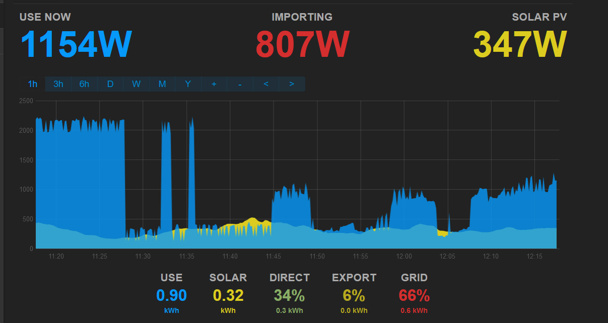

Would you please show me a full screen of the graph from MySolar? So I can see the figures at the top and bottom. It might help me understand my ones.

Here’s a snapshot for the last 24 hours. It’s dark out, so no solar right now.
(this isn’t an accurate representation, as I also have a battery, but that’s not shown here)
Thanks Tim. Especially for the prompt reply. Unfortunately, I do need some solar on the image. I would like to compare the relationship between your 3 figures at the top to mine. I can’t do one of mine at the moment as it is dark here too!

Thanks Tim. Here are my graphs. use is yellow, solar is blue and import is red.
I am sure import should not follow the solar reading in that way.
When your generated solar is greater than your household consumption, I’d expect to see the import power to go negative, and yet it is not. I would suggest double-checking that the CT clamp is installed and configured correctly. Maybe @TrystanLea can advise?

This is mine. My ‘mysolar app’ seems to graph Use and Solar, where as yours seems to do Solar and Import/export.
There is an odd discrepency between the two graphs on the right hand side, the top one looks as I would expect with the import line dropping as the solar generation increases . However on the bottom one, when drawn with a fill the import blocking is following the use line, is there a use block still there behind this import block? This effect looks very similar to the solar app screen, though the titling is different.
Perhaps reboot and see if that fixes the processing (Left hand column > Admin > System Info)?
This is because the ‘import’ is stacked on top of ‘solar’, but the import isn’t dropping to (or below) zero as one would expect. The ‘use’ feed is derived from the other two, so will always follow the sum.

Success!
I now have the two inputs separated. I have yellow!!
Many thanks to all who helped with their advice and particularly to those who shared their screenshots to illustrate what it should look like. Your generosity with both your time and knowlege is much appreciated.
The problem turned out to be, as some suggested, that CT1 was not on the correct lead.
