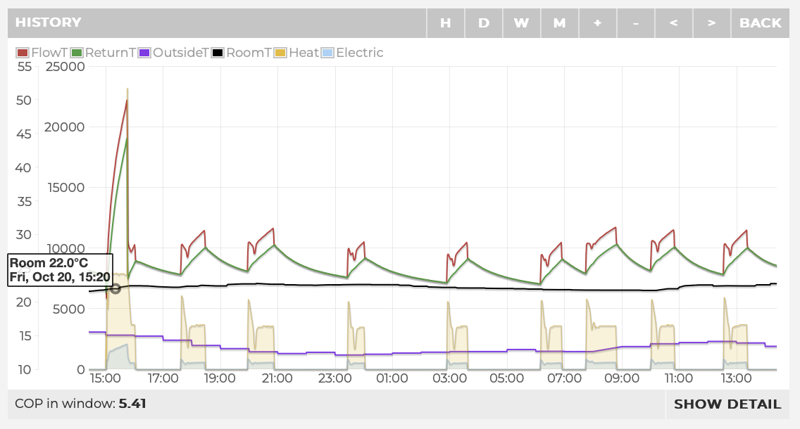

For very similar operating conditions *8 degC out and a positively tropical 37 degC flow temperature) the 7 kW seems to edge out the 9 kW unit at lower outputs:

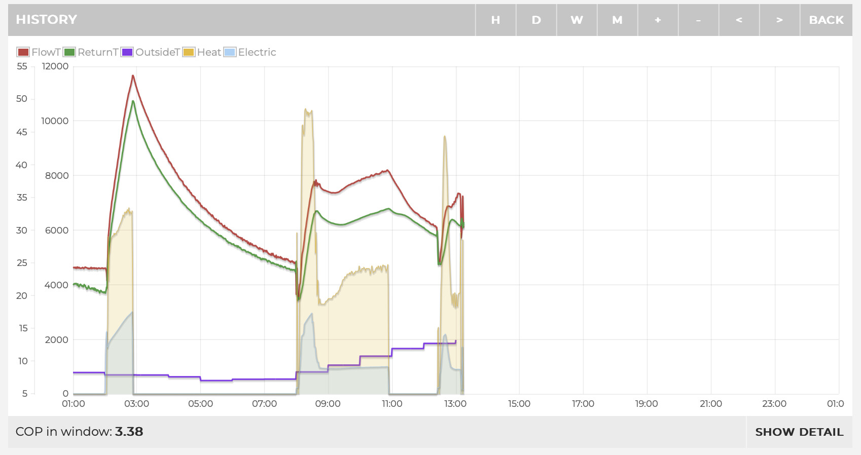

This one is fun.
https://emoncms.org/app/view?name=MyHeatpump&readkey=bfd97700dd78658dedd70ff6670b453c

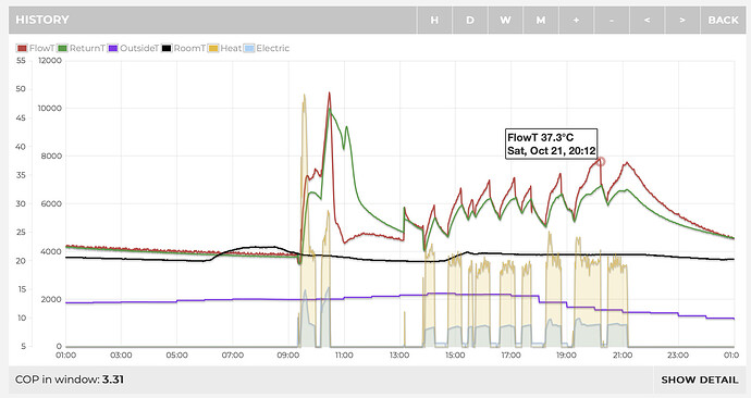

Big nigtht setback (so hammering the unit hard in the morning at poor COP instead of letting it tick over all day) and charging up DHW at the coldest part of the day instead of the warmest part of the day when the sun is shining etc.

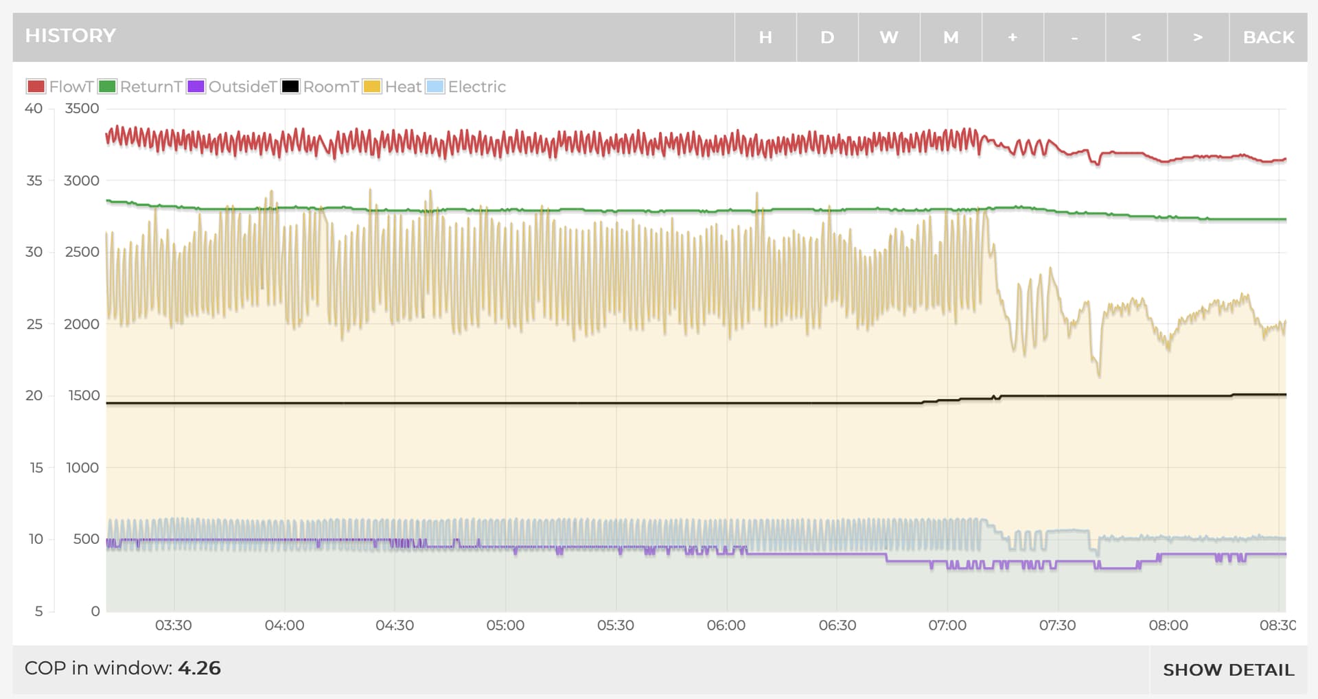

Compare with a heat geek style setup:
https://emoncms.org/app/view?name=Primary&readkey=eec7334e58f2a6927a9ff7b27c8c7e63
Where is just ticks over all day with the radiators as cool as you can get away with / decent length cycles.
It’s pretty clear when folks are out / on holiday from these datasets by the way. No DHW charging since Friday 20th on that heat pump! :wink:

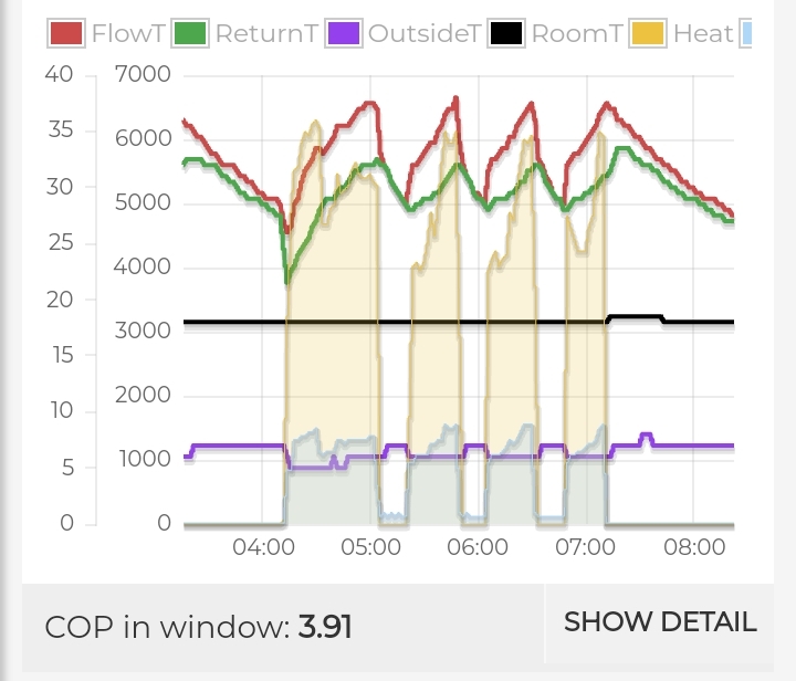

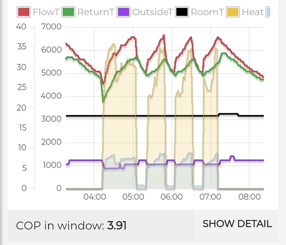

The Ipswich one is mine.

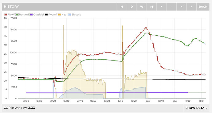

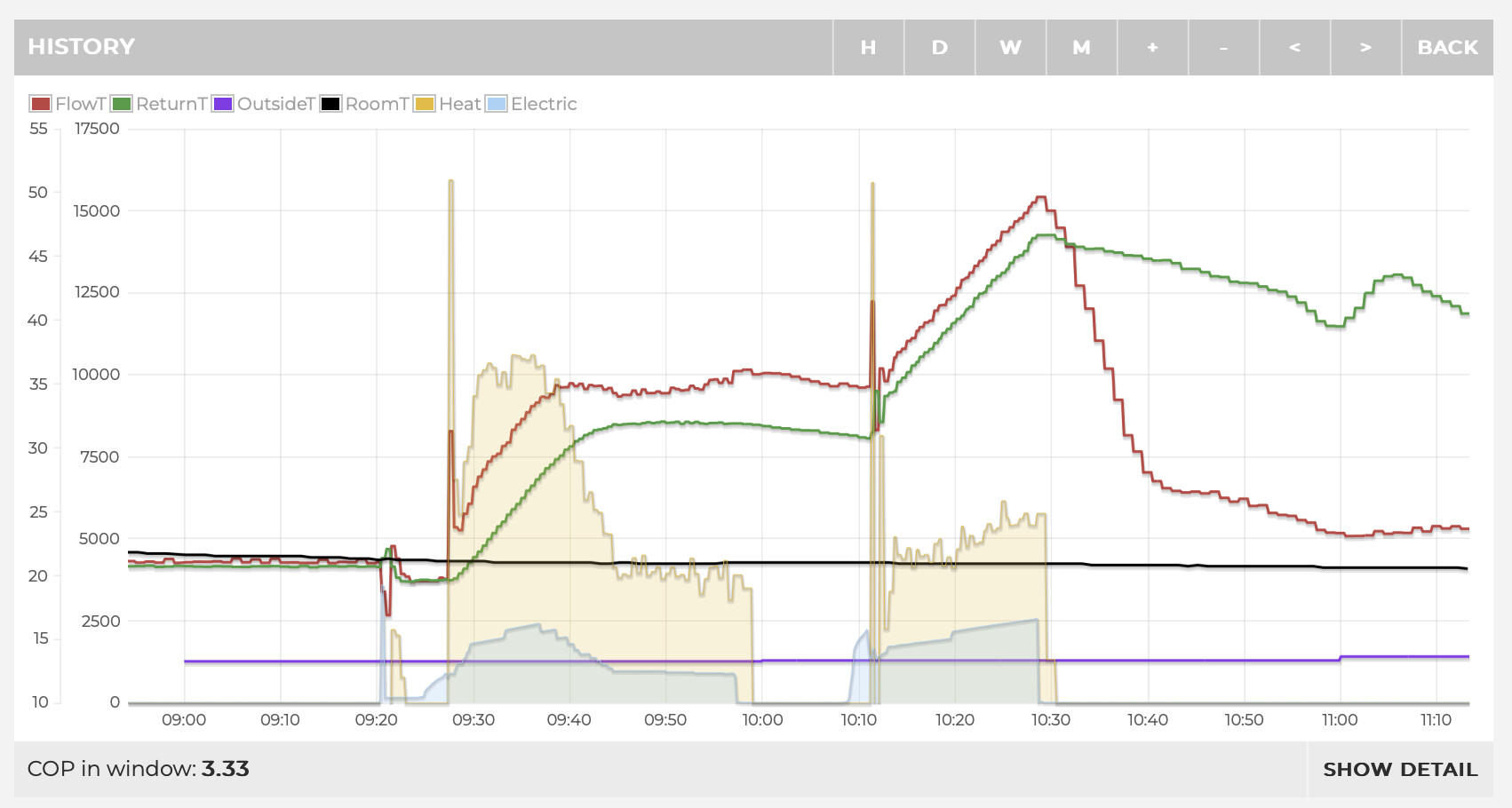

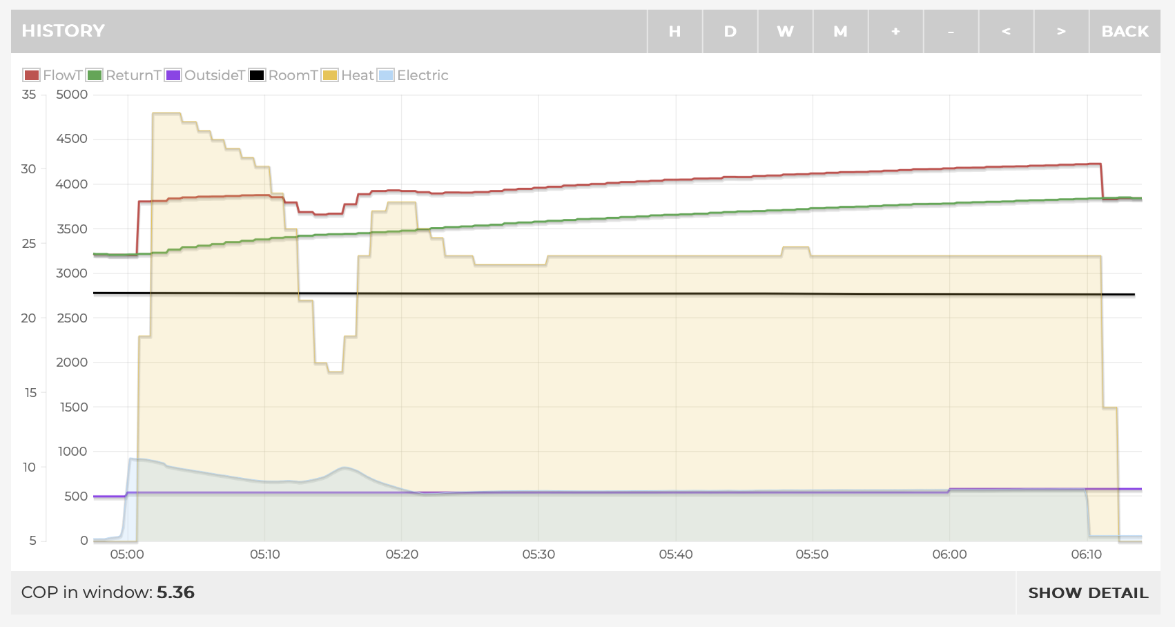

Yesterday was a one off day. I turned the heating off whilst I was at work so that when I came home I would be able to change the setting form fan coils to radiators without waiting for a heating cycle to finish, I wanted to heat from a cooler starting point inside to see how it performed.
My schedule of room temperature is set at 18c from 21.00 to 05.00, 21c from 05.00 to 13.00, 22c from 14.00 to 18.00 and 23c from 18.00 to 21.00.
No big jumps and the house isn’t falling below 20c at night very often.
It just didn’t behave as I expected yesterday.
I heat the DHW at 14.00 each day, or that is my schedule. It automatically reheats. I run my disinfection cycle at 04.00 on a Friday as it uses cheaper electricity and none from my battery. My SCOP is distorted by the disinfection cycle as the immersion heater electricity use is reported but not the heat produced.
The radiator setting has a set delta t of 8c, it is fixed at this using the radiator setting.
My DHW is on an eco setting at 45c

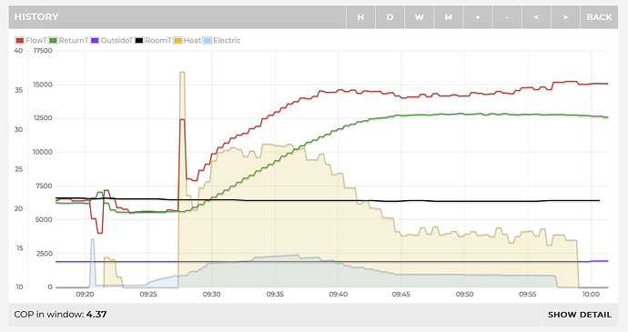

From my data I can see that yesterday between 09.00 and 10.00 my house was absorbing 10.6 kWh of heat at a flow temperature of around 30c.
Maybe I am interpreting the data in the wrong way but it looks like my radiators are more than capable of delivering all the heat produced, even at the minimum my heat pump can produce?

Ok. We can watch what’s happening.
On the contrary.
Your heat pump and readiators are spending most of their time doing sweet f**k all; then it’s tipping in all the heat at quite a high target water temperature:
Try setting to 22C 24/7 with a lower curve.
Kill the disinfection cycle. Not required.
Evidently that’s the target dT that the unit has decided represents the best balance between improved compressor performance and pumping cost.

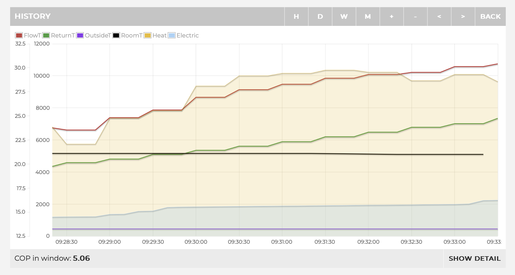

And a DHW reheat?

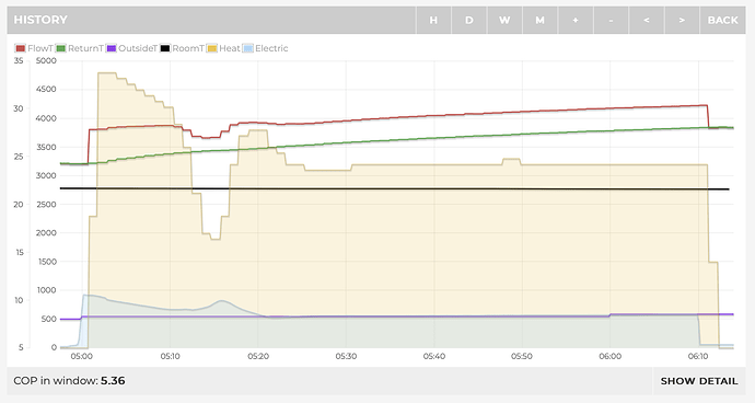

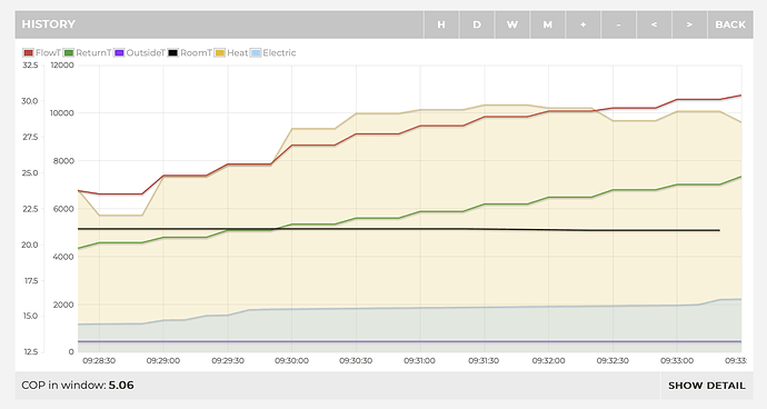

Yes to 30C:
Now heat for longer at a lower flow temperature and you’ll get an idea of ust what the Daikin unit is capable of. For example the beginnign of the reheat period you’re up at a COP of 5. Spread that throughout the day and you caan afford to waste 20% more heat from the home (due to increased ventilation losses) before it costs you a penny extra in elextricity vs a COP of 4
I would agree with that. Looks like 3.8 kW @ 35/30 is the minimum ouput of that unit:

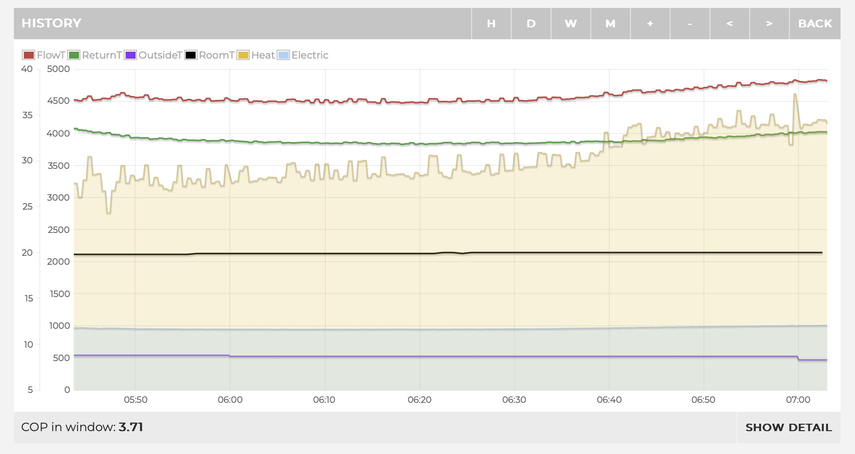

So I have turned off the disinfection cycle, switched to pure weather compensation and the pump to sample mode.
Well see how it goes.

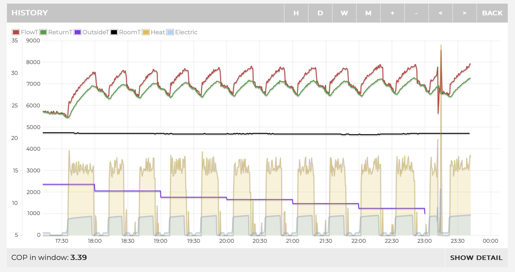

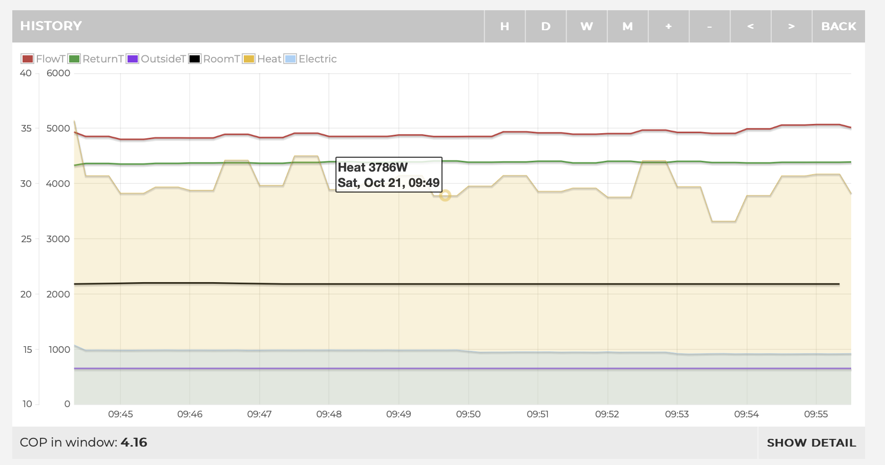

Your analysis of the Handover pack matches that which I’ve just done on mine. I’ve looked at the Stelrad output spec for my rads, the design temps and the effective output at various dTs (room vs rad dT) and I reckon that for the -2.2 deg outside temp, the HP flow/return is intended to be 50/45. I imagine that mark-drummer’s is the same. My radiators have an output of 9.8kW in total, and the calculated heat loss is 8.4kW, presumably at the -2.2 deg design temp. But this isn’t a very airtight house, so it’s probably higher :-/.

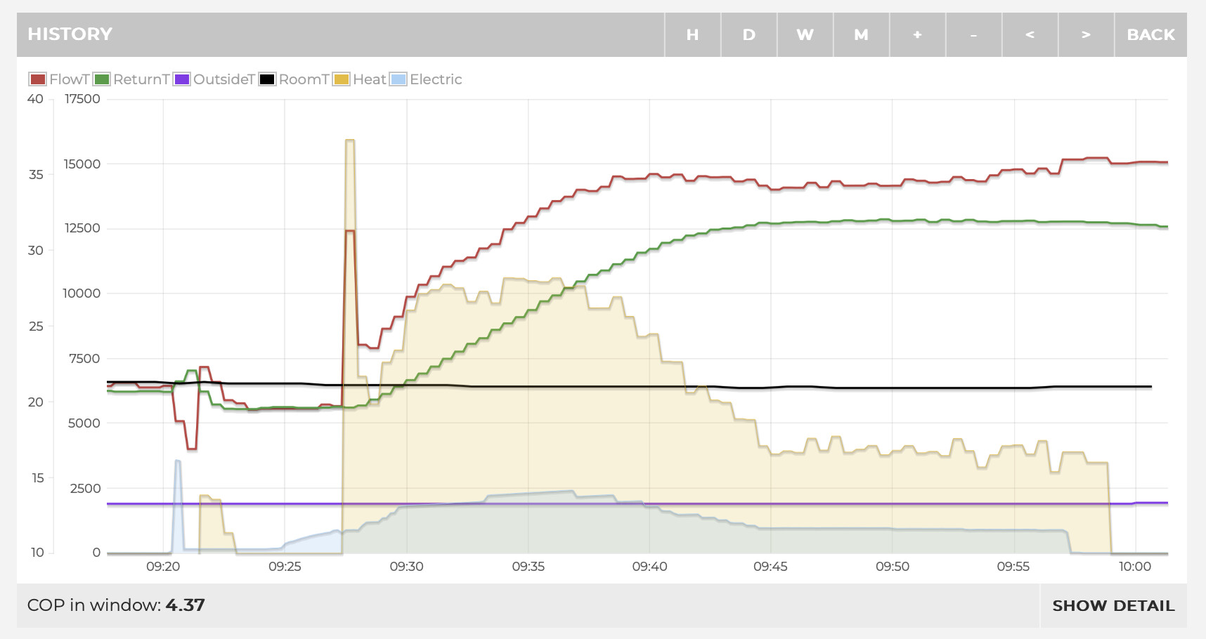

So now I am on pure weather compensation with no other influence.
The heat pump is using 900w of electricity to produce 3kWh of heat.
That looks like it is as good as it gets.
Outside temperature is around 10c and the internal temperature is steady, so working OK. Flow temperature is about 30c.
Looking at other heat pumps they are only using 600w to produce around the same amount of heat.
I can only conclude that this Daikin heat pump is inefficient compared to something like a Vaillant.
Am I wrong?

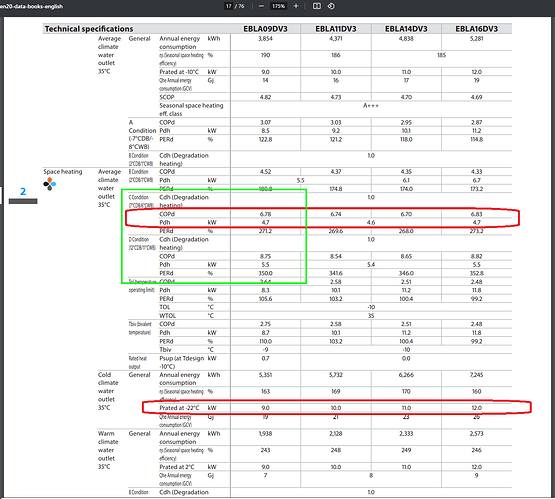

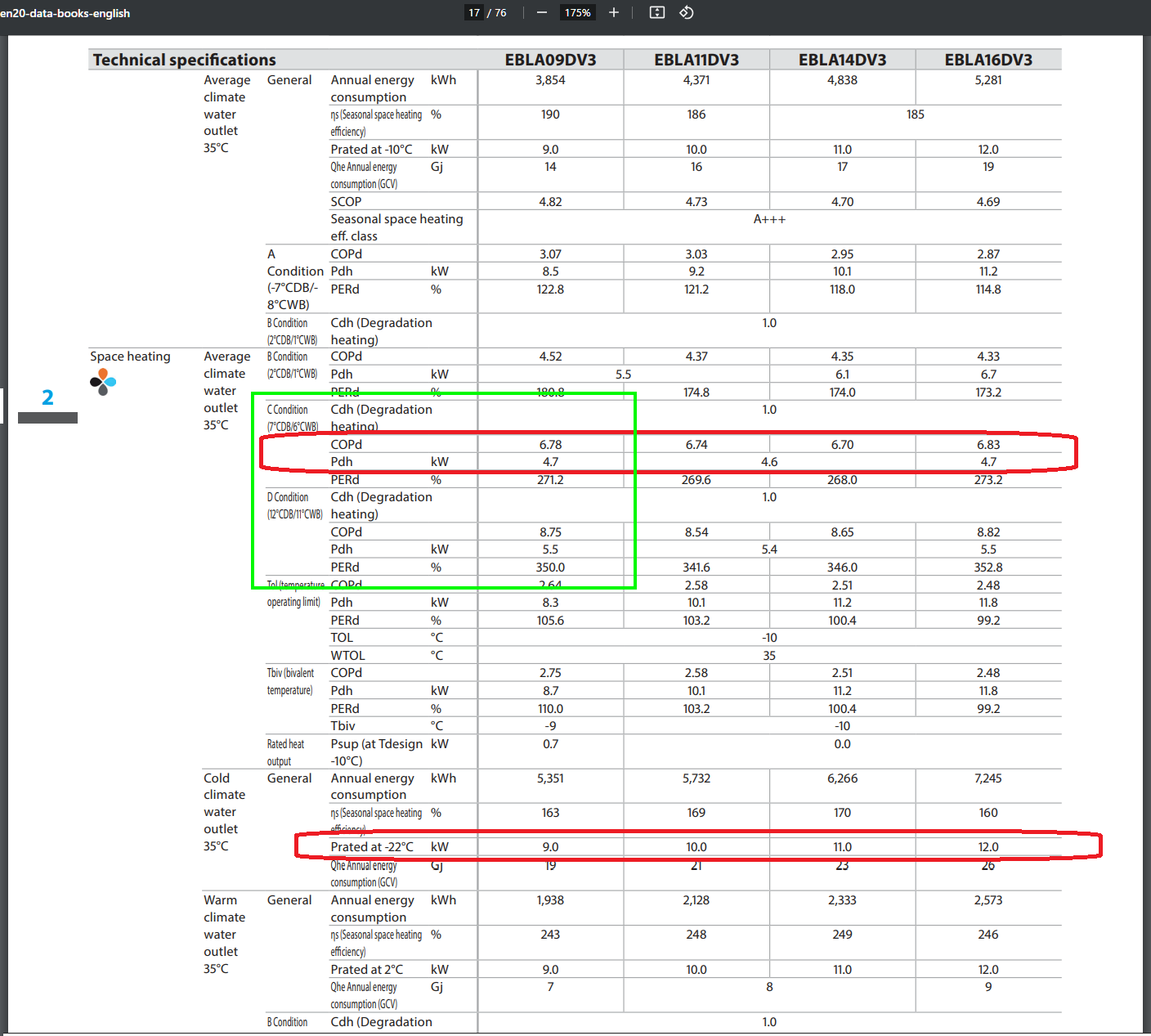

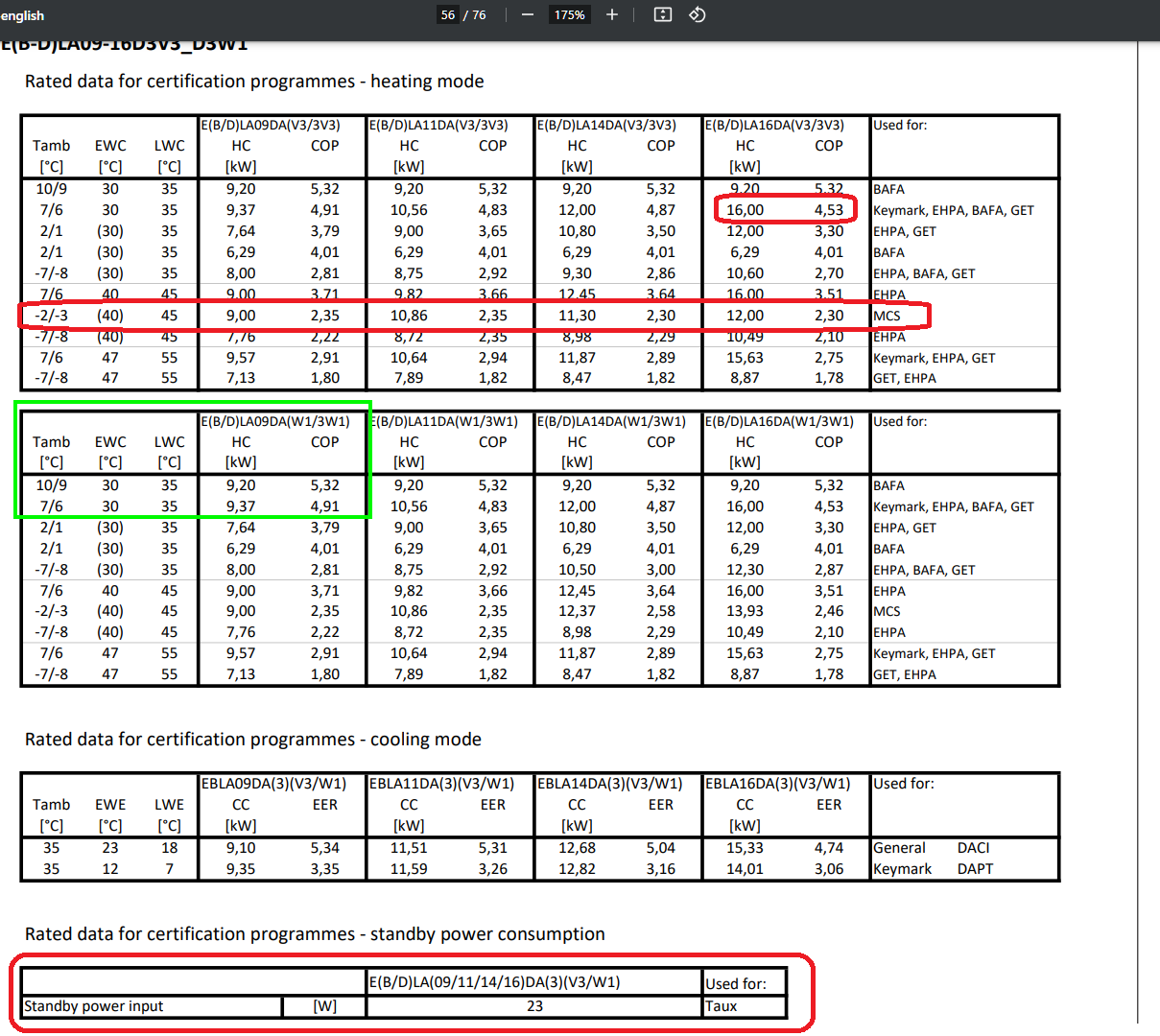

The COP is indeed nothing to write home about even though it’s warm out and the flow tempreature is very modest.
If I interpret the datasheet that @Vinny posted correctly you ought ot be seeing a COP of 5 or so in these conditions:
Either:
  • Something is drawing more electricity than it ought to
  • Something is putting less heat out than it ought to
  • You’re not measuring electricity accurately
  • Youre not measuring heat accurately
  • The performance of the heat pump really does fall off a cliff at partial load (3 and change kW, rather than the 5ish kW that the datasheet is rated for)
  • I’m completely wrong in my expectations on how that unit should perform

Nothing I have done in the last week has made very much difference to the COP, it is more or less the same if I run it as fan coils, radiators, WC with Madoka influence or pure WC.
It seems to be set up really well in terms of the weather curve, the flow temperature is reasonably low and the house is a steady 22.5c according to the Madoka unit. The temperature in the house is also constant according the OpenEnergy thermostat I am using here.
I don’t think it’s me, I think I know how to set up a curve and make it work.
So, as you say, I am either reporting incorrect data somewhere or the heat pump isn’t performing as we might expect for some reason.
A quick check of my three sources of measuring electricity consumption confirm that the consumption is as reported.
I will check what the Daikin MMI says about heat produced.

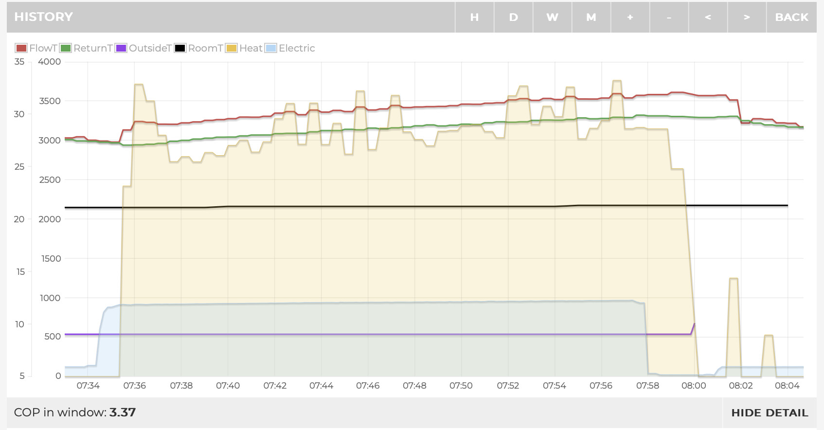

The heat output is rather higgledy-piggledy compared with others with the Sontex meter; which I can’t make sense of unless the unit it modulating the circulator in a higgledy-piggledy manner:
I just did a rough calculation of the heat produced in a stable 30 minute period, not particularly scientific but the best I could come up with.
The flow was steady at 24lpm and so I could calculate the change in temperature over time of the water mass and came up with exactly the same as reported.
I will load a picture of the installation when I get home later.
The circulation pump was using even more until I turned it down to it’s minimum of 60%. The standby consumption of the heat pump is 23w and when the pump was running with no heat produced the consumption was 175w or so.
I can’t see why the pump is running so hard and producing no heat, seems like a waste?
Running like it is now is not ideal for me, the pump/water circulating is quite noisy, don’t know if that is normal. Running all the time is noticeable.
I have three electricity meters, one fitted to each of the supplies to the heat pump. The first one is the heat pump power including the circulation pump, the second is the immersion heater and the third is a booster heater inside the heat pump. The electricity use reported is only from the first meter apart from during the disinfection cycle when use on the second meter is recorded. There is no consumption on the booster heater so it is not inadvertently using that to provide some of the heat.
I still can’t get away from the heat being produced by the heat pump at the electricity consumption reported. Surely it should be higher and then shut off sooner at those flow temperatures if my radiators cannot handle the heat produced at that low a flow?
It just looks like the heat pump isn’t producing much heat compared to the electricity consumption.

So I have been looking at another 9kW Daikin Altherma 3’s data
This morning, at the same time and same outside temperature I see the following
My heat pump is consuming 926w and producing 3,520w of heat at a flow temperature of 30c and a return of 27.8c
The other heat pump is consuming 988w and producing 4,556w of heat at a flow temperature of 38c and a return temperature of 32c
The electricity consumption is almost the same with the difference being the flow and return temperatures.
It is interesting that there is a bigger difference between the two flows and returns.
I can’t run my heat pump on pure weather compensation at 38c, it will be like a sauna in here, it’s already 22c inside running at 30c flow.
As Marko has noticed, my heat output is up and down compared to others.
I am going to increase my flow by the WD curve offset and see what happens.
If that improves things then I will have to reintroduce Madoka room temperature control.
A couple of hours later and it hasn’t improved the COP.
