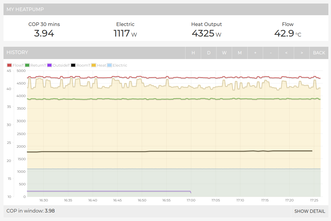

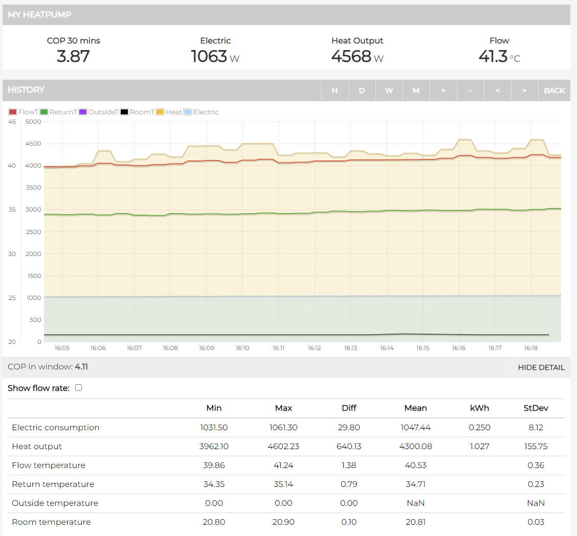

I am now running it at +10 on my WDC but I have left the Madoka at 22c.
It has been running quite happily for 2 hours and 15 minutes using 1kW to produce 4.5kW of heat for a while.
It’s good.
It didn’t do this on Friday when I did the same but set the Madoka at 30c, the maximum.
The last 50 minutes is at a COP of 4.10, it’s ok.
I am quite happy to run it for 16 hours a day using 1kW an hour.

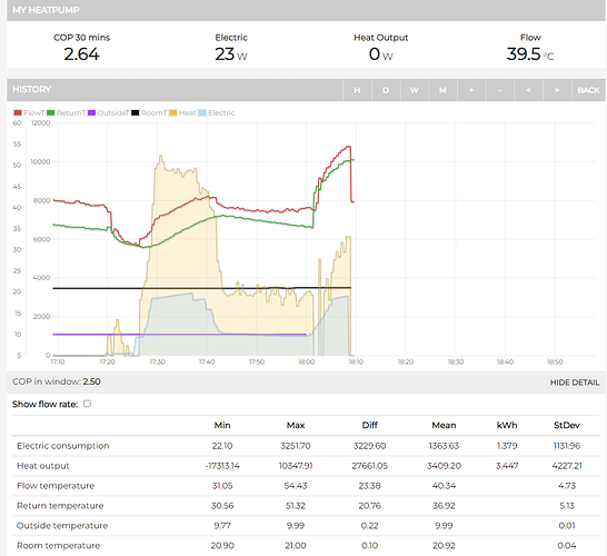

I changed my overshoot from 1 to 4 and this happened. Any ideas?
I assume it did a defrost here as well?
I also notice that DHW tank has gone back up to 50c, so it has performed a DHW reheat here despite reheat being off and only scheduled to heat to 50c at 14.00 each day. I’m a bit baffled by this.
I think we have cracked it.

It looks as though the overshoot allowed it to go to 41c = 37 + 4 at 17:40 and then the pump speed must have increased a lot to drop the delta T. Have you fixed the delta T ? or left it on the HPC setting? I would suggest fixing it at 6 c for radiators. I’ve no idea what is happening with the DHW.
Hard to tell what is going on as sometimes weird things happen. For example; My unit switched off at slightly different times for a few minutes but just once per day on two or three days in a row and switched the back up heater on for 3 mins. As the evaporator had been well above zero with those external temps it cannot have frosted up but I wonder whether there is something programmed into these units. I have also seen it switch the back up on for 5 mins in the morning before the unit fires up after a night off even at 12 c outside… my back up should only come on below -6c. So phantom defrosts seem to happen.

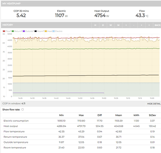

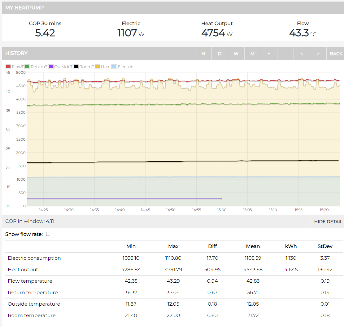

All I have changed is the overshoot to 4 and gone +10 on my WD curve.
I seem to have hit a sweet spot with a flow temperature of around 43c and the return is about 6c lower.
It’s working quite well, COP is over 4 for a few hours now.
I am sure that with bigger radiators I can lower the flow temperature and get the electricity input to it’s minimum.
My new radiators have a capacity of about 180% of what I have now.
They are what I worked out as required before Octopus got involved.
The pump speed is modulating differently to what it is now.
I tried this last Friday but increased my room temperature to the maximum of 30c to see what happened. I am having much better results leaving the Madoka settings alone and have just changed the offset from the WD curve and the overshoot from 1 to 4.
It’s ok, the best I have managed so far. I think it is good that I have really extended run times, it has to be better.

I’ve fixed the issue with the COP 30 min figure, I’ve switched it from calculating based on the kWh feeds which have low resolution (if coming from the heat meter directly vs power_to_kwh input processor) resulting in a figure that flipped in your case from 3.5 to 5 and back, to using the power and heat data averaged over the 30 minute period. The result is much more consistent now:

The modulation is on the Flow temperature, but it references the room temp on the Madoka.
Say you have a fixed set point of 40 c then when your room temp schedule ramps up from 16 to 20c the heat pump will monitor how quickly it is getting there. If it is too slow it ‘modulates’ the flow temp up a degree, then another, then another until it is getting there quickly enough. Once it reaches the set point it modulates down again until it reaches its equilibrium… so it could end up a few degrees below 40c if your modulation limit setting allows.
Weather dependent set point will just change where it starts this process and because my sweet spot - or efficient and realistic range is 33 to 39 (yours looks like 37 to 45 before the new rads) then I only use modulation - knowing that if it equilibrates down to 33 then that is fine by me, whatever the outside temp.
Incidentally the compressor ramps up or down to get to the flow temp set point ± modulation that the above process decides and the water pump ramps up or down to maintain the delta t (flow - return).
Hope this helps

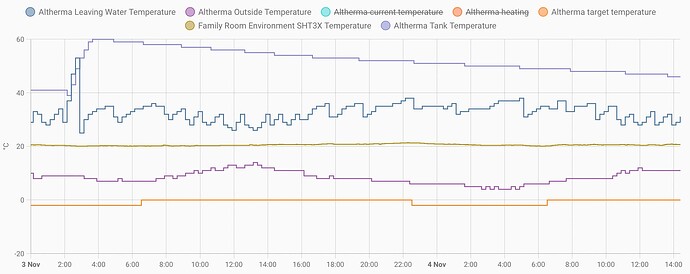

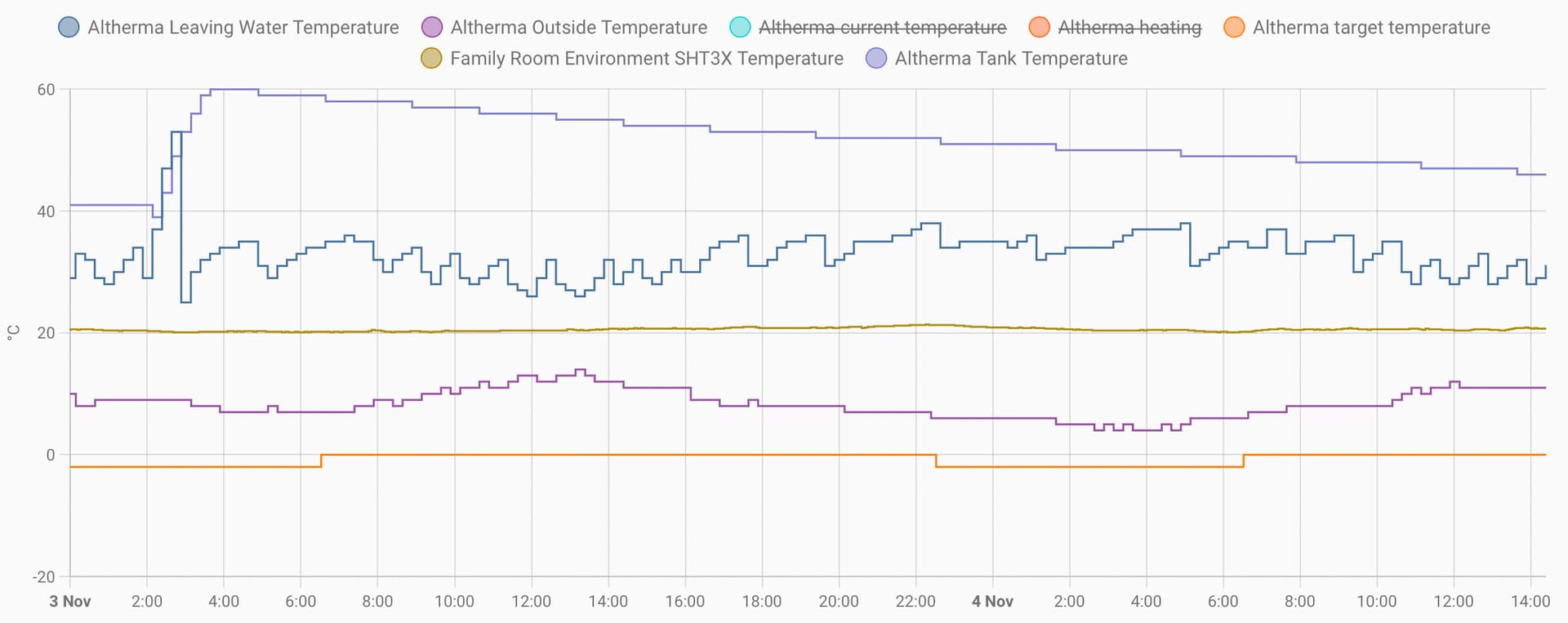

I’m currently running using LWT mode only - I have to get Octopus back to move the badly placed thermostat, and I quite like not allowing family to mess with it! I am monitoring some Daikin Cloud data using a HA plugin, which only provides what the Cloud API has e.g. none of energy produced, return flow temp, flow rate and so on, but it does give me LWT, Outside temp, LWT Offset (setback) aka Target Temp. LWT Overshoot is 4deg. Family Room Temp is from a Tasmota DS18B20 in the room the thermostat should be in :man_facepalming: - you can see it’s incredibly stable.
You can see the compressor/pump cycling more/less as the Outside Temp varies up/down. I have DHW on schedule, and you can see the legionella cycle on Friday morning 2am - I should also move that to daytime, to improve COP using daytime temps, except it uses the cheap Octopus Flux power slot.
