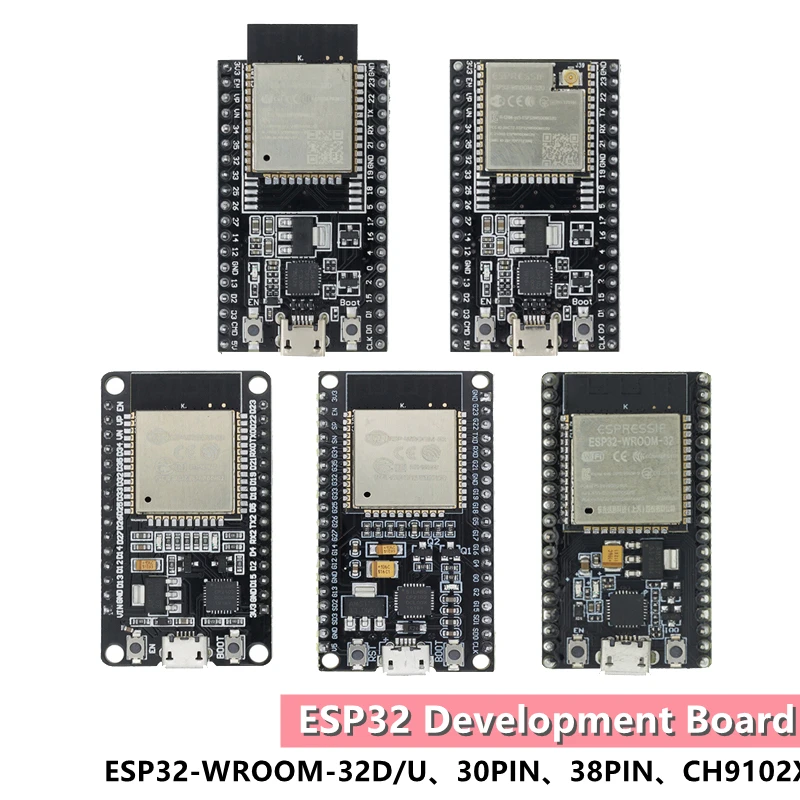

ESP-WROOM-32 30 PIN Development Board PINOUT

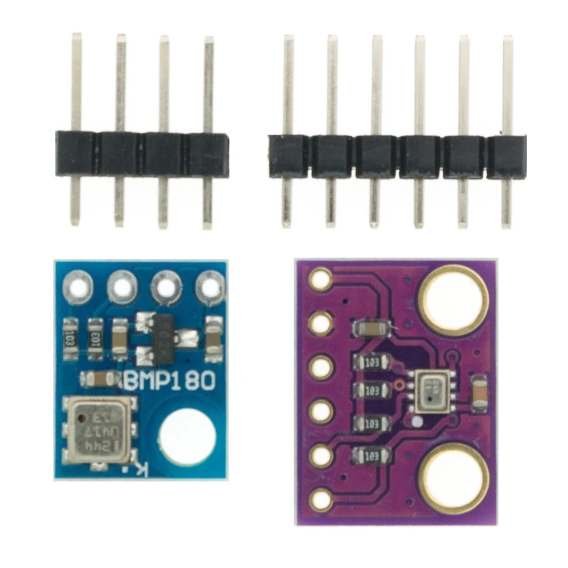

BMP180 Connected to 3,3V, GND, GPIO4 SCL, GPIO5 SDA. BME280 uses the same PINs

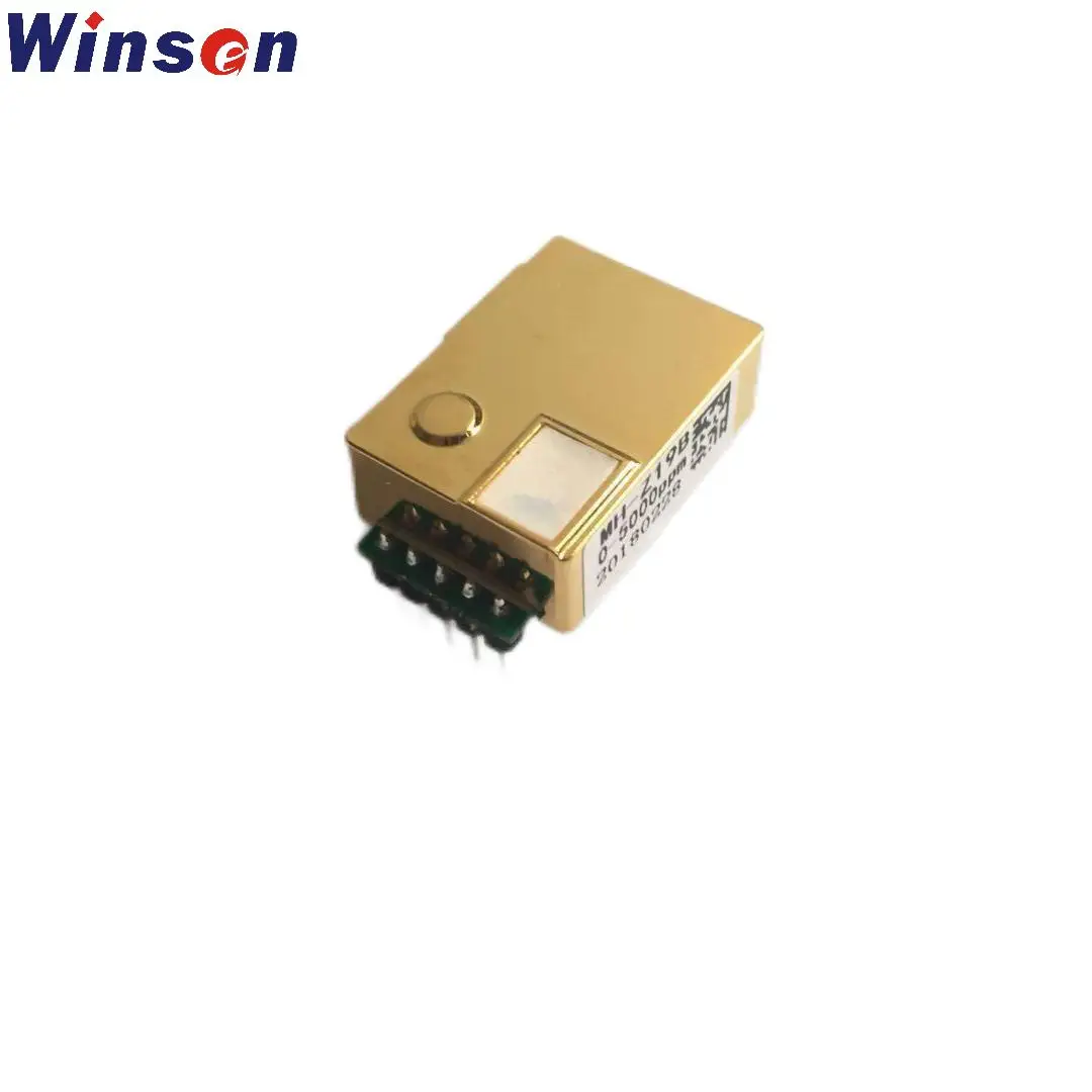

MH-Z19B Connected to 5V, GND, GPIO1 TX, GPIO3 RX.

MH-Z19B
https://tasmota.github.io/docs/Commands/#sensor15
Sensor15 0
Sensor15 5000
Sensor15 2 (for this, the sensor must be in operation and stand outside for approx. 20 minutes.)

I2C SSD1306 OLED 128 x 64 Display connected 0x3c: GND, 3.3V, SDA, SCL
