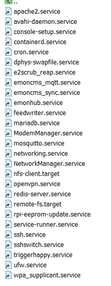

Hi all. I’ve not been around much because Discourse now only works in one browser and emoncms has just been humming along fine for me… until this morning! I’m trying to rescue an emonsd install after a power cut in today’s storm (but I already have the data backed up just in case). It mostly looks OK now except that some services aren’t starting. I think /etc/systemd/system/multi-user.target.wants/ looks a bit bare - can someone with a working emonsd tell me what theirs contains, please?
Or tell me I’m barking up the wrong tree and services are started by some other mechanism, if that’s the case :slight_smile:

Well, that helped, but after the first reboot, values from the previous session don’t seem to have been written to “disk” so I suspect I’m missing entries from the other *.target.wants folders too.
Could someone send me ls /etc/systemd/system/*.target.wants/ output, or tell me if there’s a nice command to rebuild them cleanly, please?
