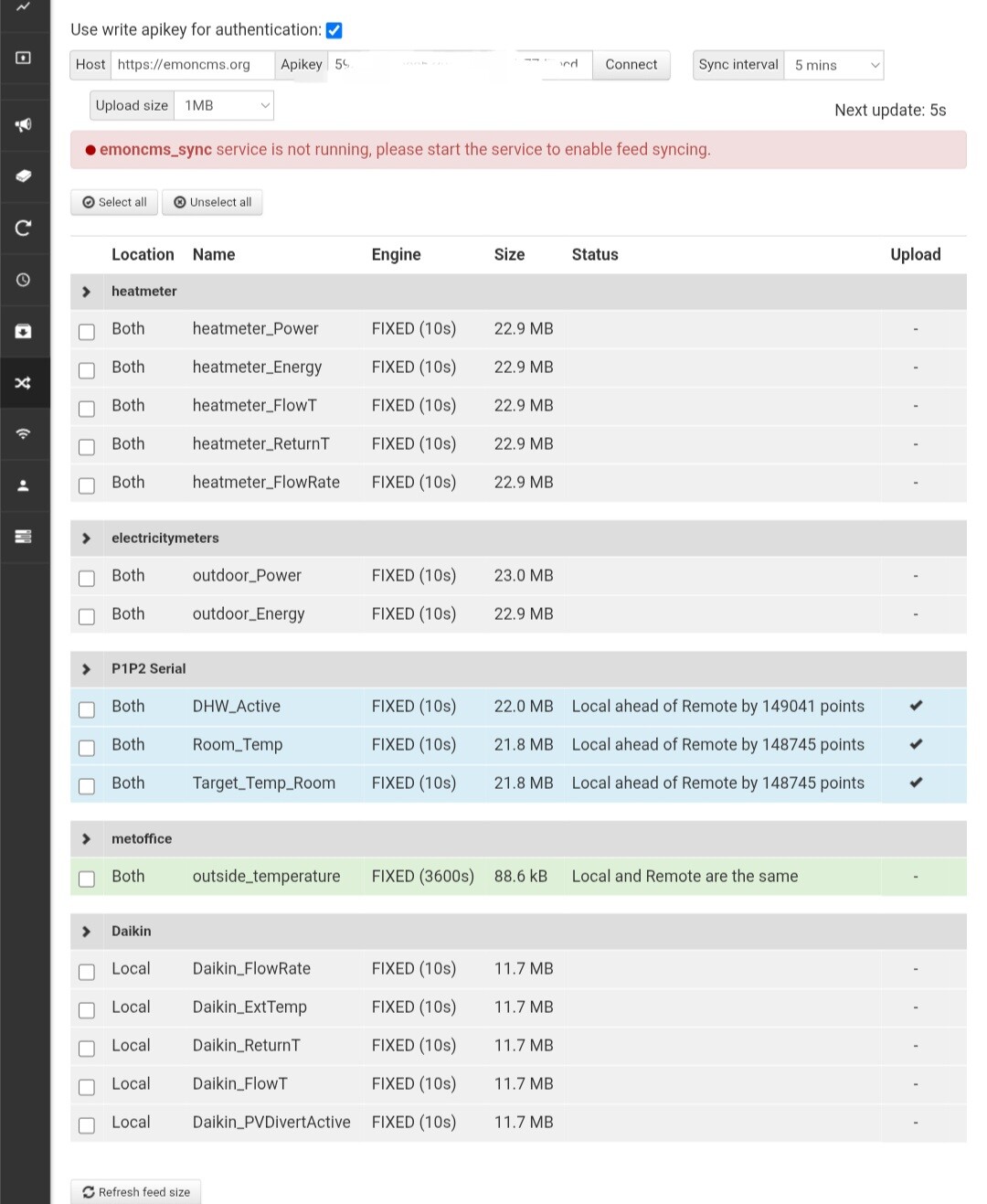

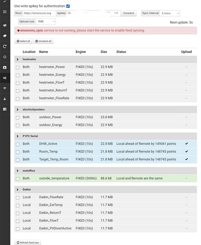

Sync process not starting
I am having some issues with the sync process.
The error reads “ emoncms_sync service is not running, please start the service to enable feed syncing.”
Seems to have been doing this for a little bit but I have been away and not noticed until today.
I checked the forum but only see some legacy posts that seem less relevant.
I have tried restarting the pi and home assistant but no dice, anyone else seen this?

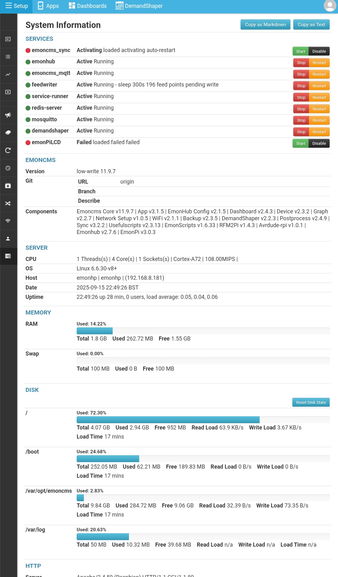

I have exactly the same problem. By chance I had a new SD card ready to install, so swapped it into my emonPi, upgraded, imported the old data and this issue is still there. Unfortunately I didn’t check that the sync service was running before importing data from old SD card.
Hello @KnightPhoenix @charlesty

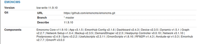

It looks like you are running older module versions @KnightPhoenix, I wonder if there’s an issue caused by a partial update that’s blocking the sync module process from starting?
These are the version on my system with the sync module running ok:

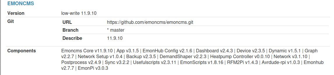

Hello @TrystanLea
I’m running emonPi v1. I have the same module versions as per your screenshot, except:
Device (v2.3.6), Dynamic (not installed), Network Setup (v1.0.5), Demand Shaper (not installed), Heatpump controller (not installed), Useful scripts (v2.3.14), EmonPiLCD (v2.1.3), EmonPi (not installed).
