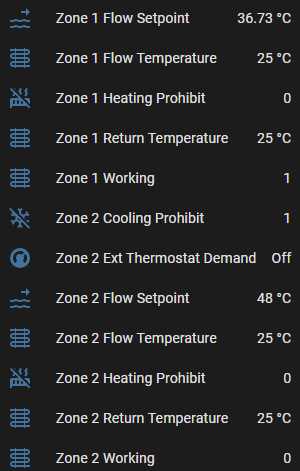

In theory could do that but the flow thermostat is seemingly reporting a static 20° no matter what’s happening, and zone 1 & 2’s flow setpoint is unavailable so I’m thinking somethings not quite wired up properly on my unit. Or I’m misreading something!
In theory I can completely do away with the Shelly’s and/or Hive by jumping the two terminals on IN1 and similarly on IN6. It means it’s permanently on BUT if the return temp == output temp the pump should shut off… right?
Yeah, and you can manually control when it’s on/off if you enter Server Control Mode - which is the only way you can change the prohibits. Or you can use the schedule in your FTC controller to time on/off
Flow Thermostats require you to be in Heating Flow mode (otherwise the FTC won’t accept changes to the setpoint)
Sensors Zone 1/2 Flow Setpoint should update though
You can see Flow & Return temperature values with sensors “Heater Flow/Return”
You might see “25” On Zone 1/2 Flow/Return Temperature if you don’t have the optional zone kit fitted
