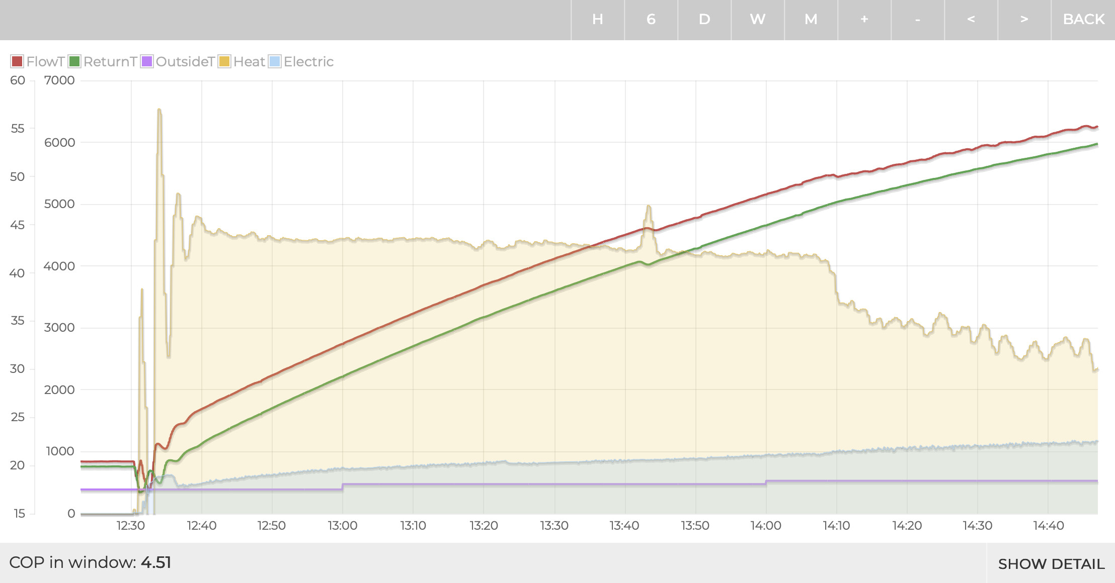

Over the past couple of weeks I’ve been experimenting with my hot water strategies. In wanting to have a single re-heat each day that’ll satisfy our daily demand, I’ve settled for 50ºC as a set point and have been running re-heats during the early afternoon on “silent level 2” having heard this is a good way to enhance the efficiency.

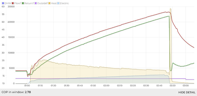

The cycle starts off with a fabulous COP of c. 6 but I’ve noticed that there is a sudden drop in the heat output when the flow temp gets to around 50ºC (see below) and I’m just curious as to what’s happening. I’m wondering if the throttling of the heat pump output on silent level 2 (40hz compressor speed and the 400 rpm fan speed) means that the heat pump is struggling to get the store temp above 45ºC? I’m going to try the same runs on silent level 1 next week to see what difference that makes.
Any thoughts and insights much appreciated!

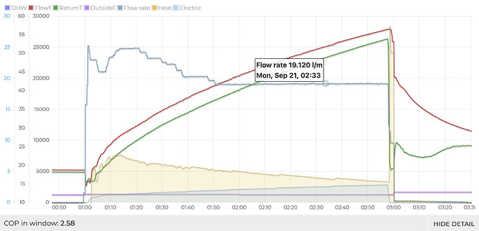

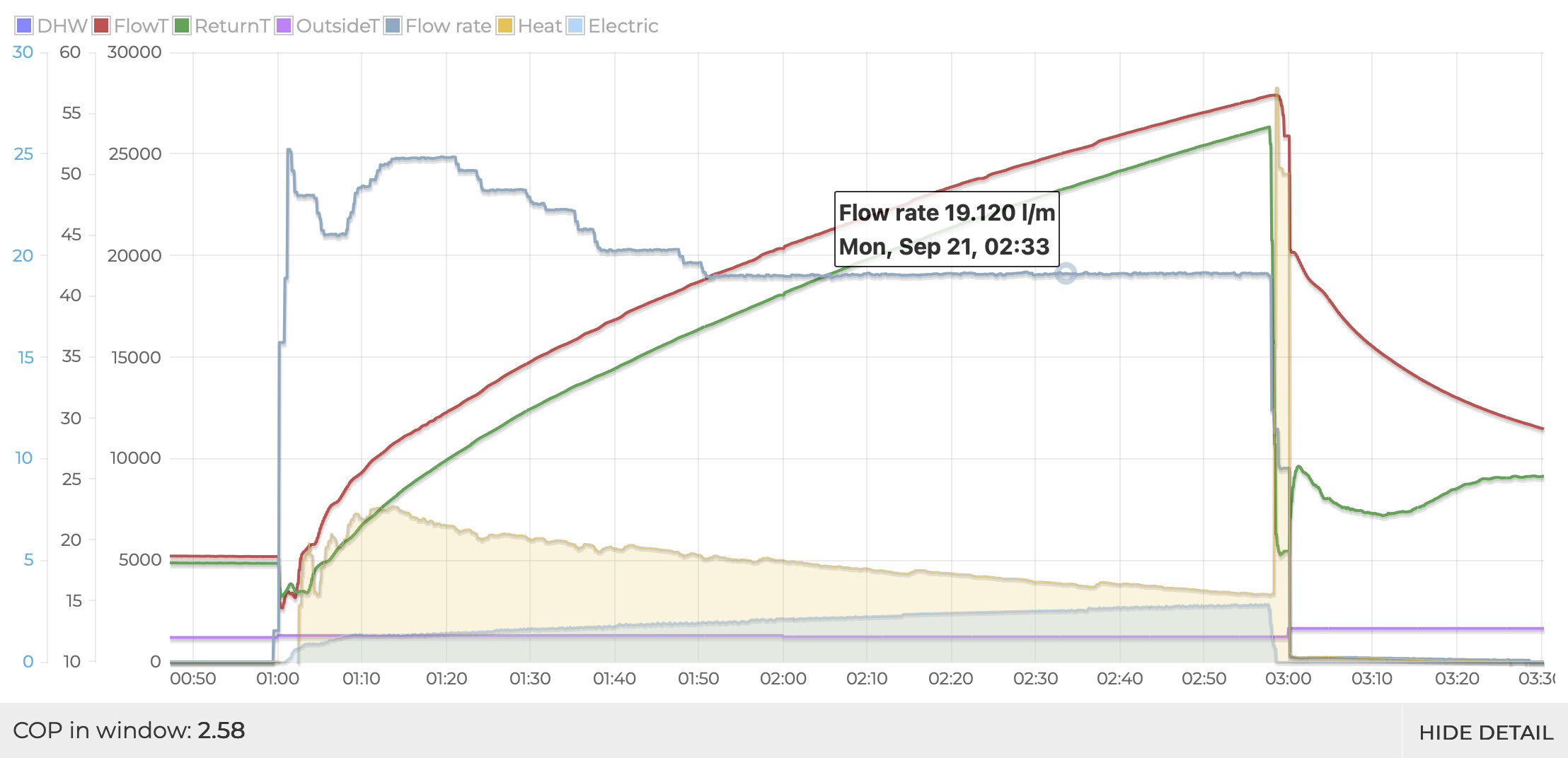

Just to say the HW issues are continuing and if anything getting more systemic. As we’re getting into the heating season, I thought I’d start trialling my “winter mode”, which is to run the DHW cycle overnight during the cheap overnight Intelligent Octopus Go window to a higher store temperature 50ºC in the hope that this will provide sufficient hot water for the following day.
I’m now seeing a similar decline in heat output during the course of the DHW run even when the heat pump is running at full power (i.e. not in silent mode) resulting in extended run times and deteriorating COPs. Here’s the run from last night:
I’m going to try increasing the DHW correction to 10ºC to see if that helps but think I’ll also get in touch with Grant next week. Thinking a software update and opportunity to review the settings might be in order.
The dT between flow and return temperatures looks to be stable and the gradient is also pretty straight, so the drop in heat output could be due to the flow rate reducing or a measurement error.
How is temperature and heat output being measured? Can you show flow rate on the graph?

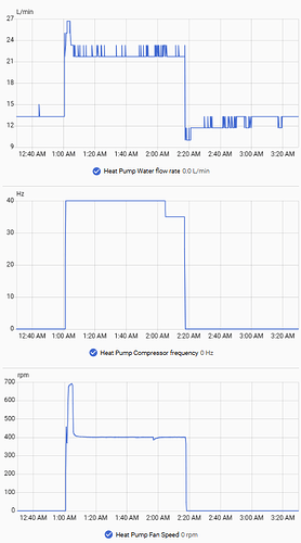

Hi @riwaller

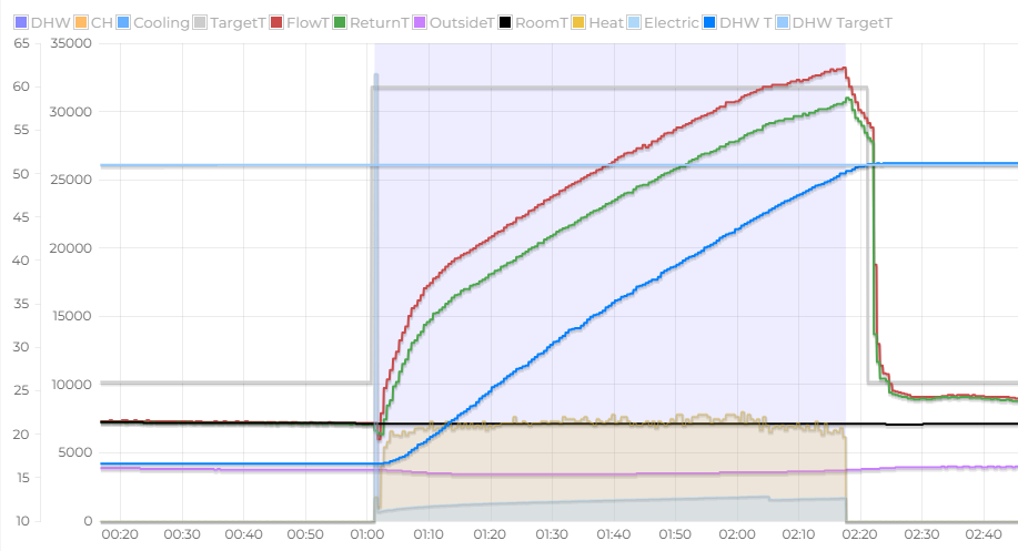

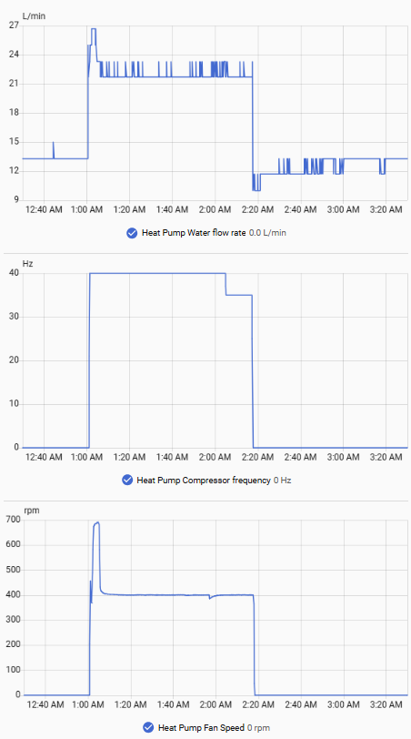

For comparison, our 9kW Grant HP290 was doing a similar DHW run at the same time. Here are the readings. Note: these are the internal Grant sensors, not independent heat / electric meters. The heat pump was in Silent Mode Level 2, heating a 170L tank to 52°C.
There was a consistent dT of 4-5 °C between flow and return, and a 9°C temperature correction between flow T and target T to overcome our small cylinder coil. Reported heat output remained constant throughout the run, between 7 and 8 kW, with small reductions at the start and end (NB: absolute values may be inaccurate). Electricity demand rose during the run, as the flow temperature increased. There is a small drop in power input/output at 2.05 am, when the flow T rose above the target T.
Looking at the metrics from the heat pump, the compressor frequency, fan speed and flow rate were consistent throughout the run. Silent Mode 2 limited the compressor to 40 Hz and the fan speed to 400 rpm. The compressor frequency reduced to 35 Hz at 2.05 am, aligning with the reduction in power in/out when Flow T exceeded Target T.
This looks very different to your records. If there are other metrics from the DHW run that you’d like to compare against, let me know and I can look them up. Otherwise I suspect that a call to Grant might be the way forward. It could be sensible to get an engineer booked soon, before they get busy.

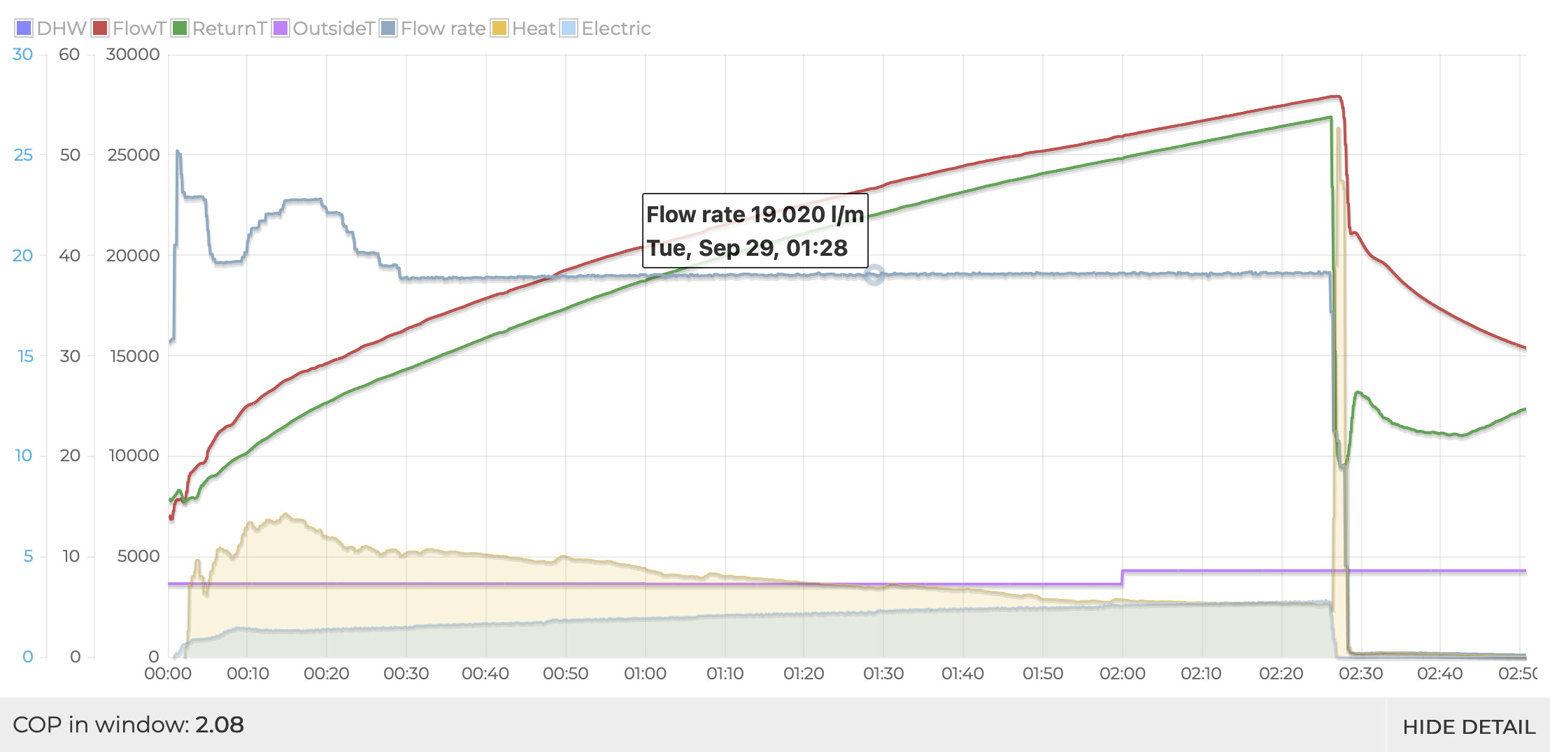

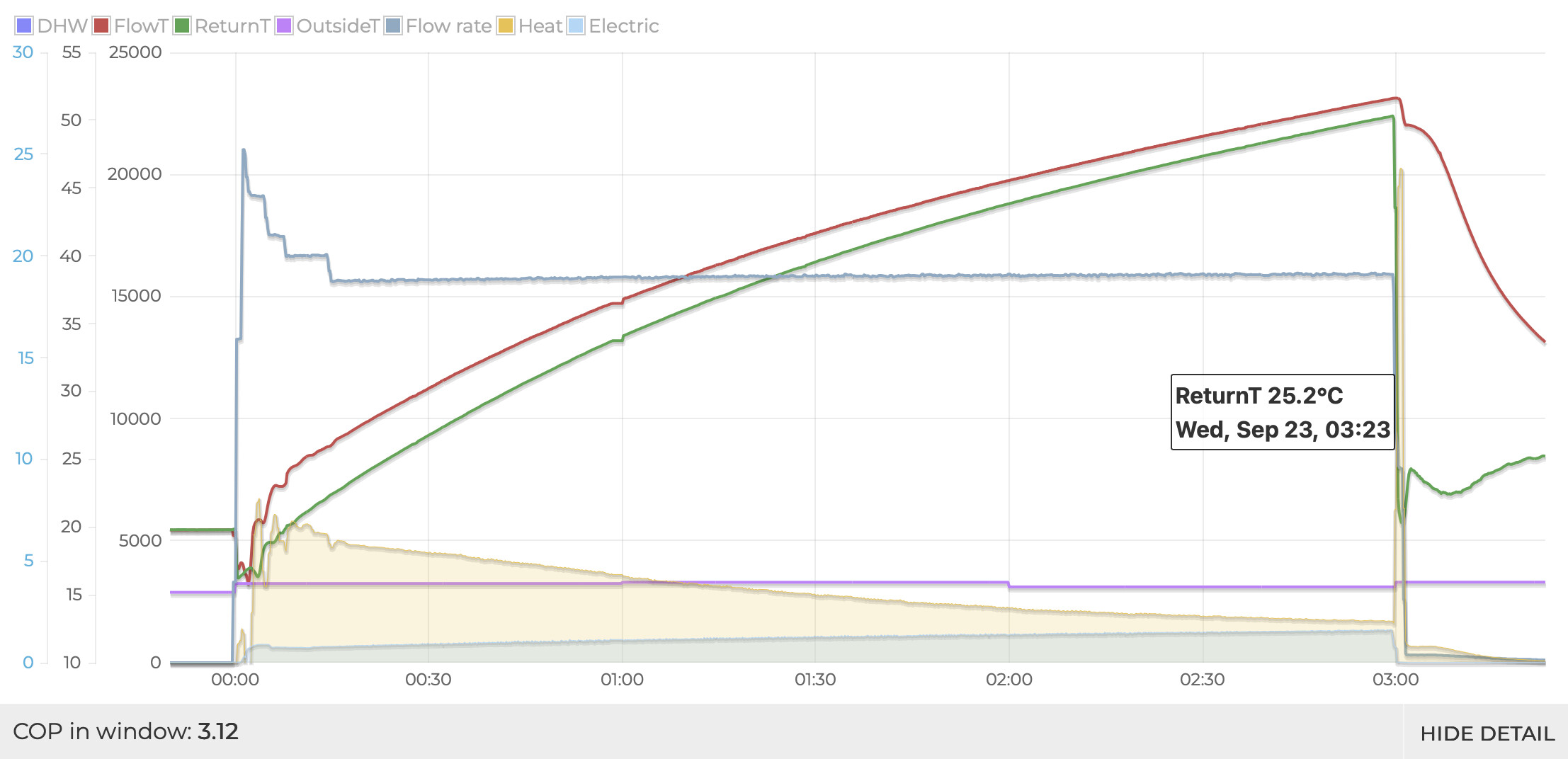

Many thanks for the reply. The temperature and heat output are being measured using the OEM kit and here’s last night’s run which includes the flow rate…

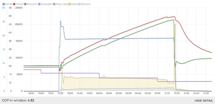

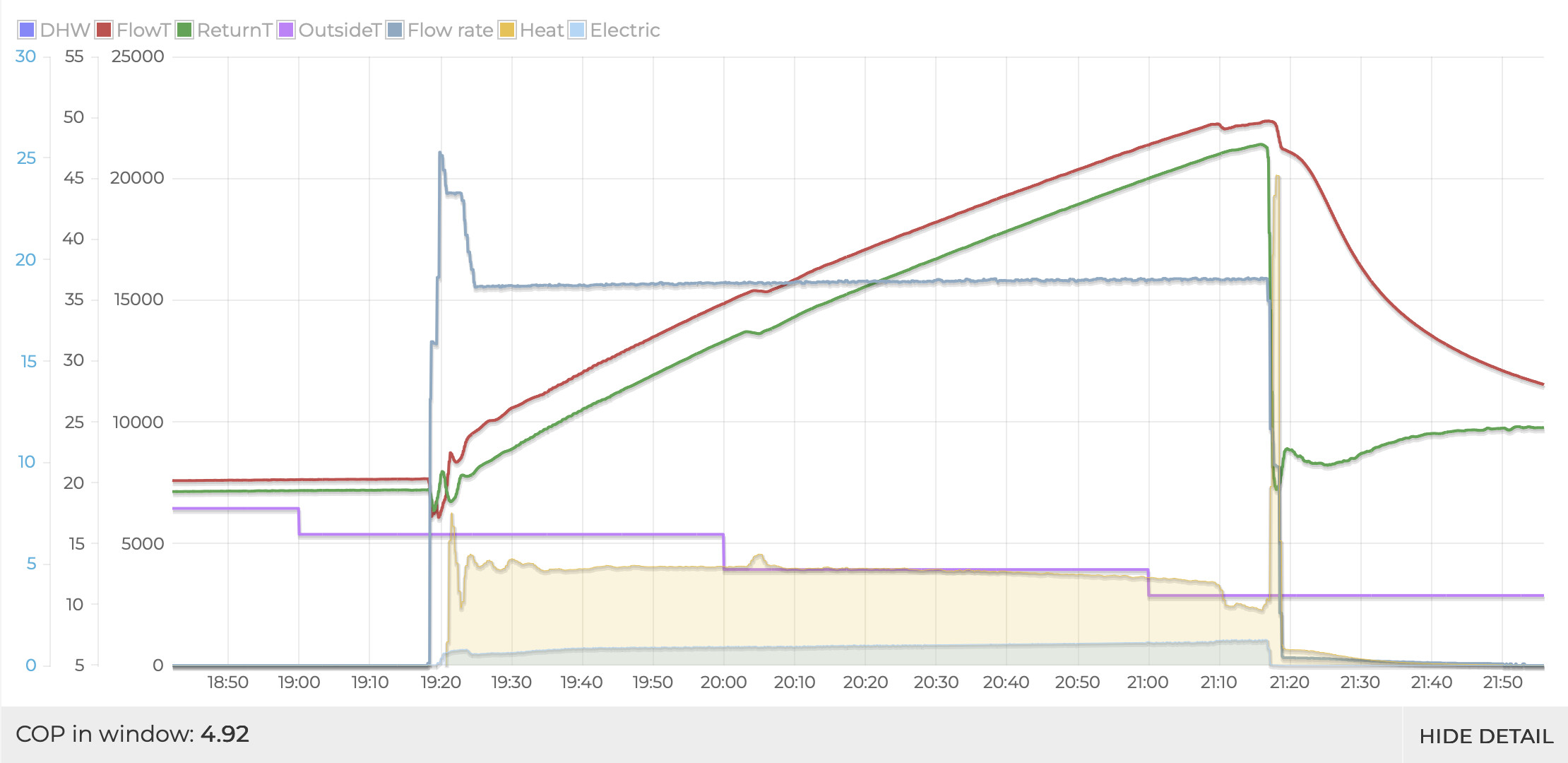

As a comparison, here’s a run from a cool day in late August (temp of 12ºC) in silent mode 1 when I was regularly getting a COP of 4.5-5.5…
It looks like the DT is reducing towards the end of the cycle. What make and model of cylinder do you have? Do you know the size of the coil?
Many thanks for the reply. As I’ve indicated in my reply to Tim below, this was how my DHW cycles were performing before I went on holiday for a week and switched the DHW mode to off, and then back on as we were travelling home. So no change in any of the settings - just the tank sitting idle for a week and then not performing anywhere near as well as it was before we went away. All very puzzling!

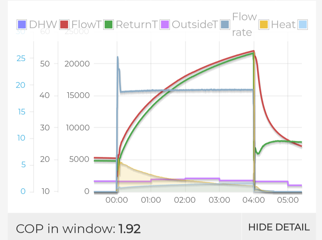

The DHW is still reaching my set point of 50ºC (rationale here is to heat up using cheap overnight window and use as a thermal store) but last night for example it took 2.5 hours with a COP of little more that 2. Flow rate is around 19l/min.
If you look back to the summer, you’ll see that I was routinely getting a COP of >4.5 for the DHW runs - admittedly with warmer air temps and a lower set point of 45ºC. I think the flow rate was the same too, i.e. I don’t think that has changed.
It was going away for a week, switching the DHW to “off” and then turning it on when I came back that coincided with a marked drop in performance and in particular an inability to sustain a consistent heat output at dT. Just have no idea what could have changed and have the installer coming around next week.

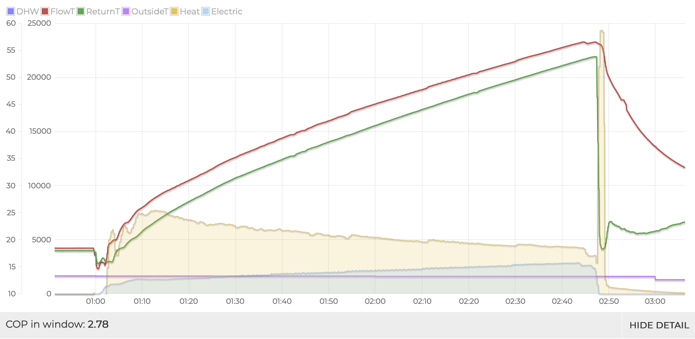

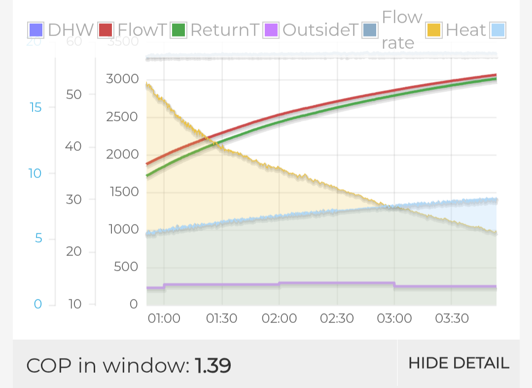

I think it’s your monitoring. This is DHW run from the night before last, and it’s looks pretty unphysical to me
Zoomed in:
Hi Richard,
Thanks for the link. I’ve been puzzling over this and can’t get my head around how the heat output could be below the electricity input. Literally negative COP towards the end of the cycle.
As Dan says I feel it could be a monitoring issue unless the hot water is somehow bypassing the heat meter when on DHW, it’s probably breaking the laws of thermodynamics*
The only think giving me pause is that you have noticed that it is taking longer to heat up too and normal CH is unaffected. Its very odd!
Did the installer give you any clues?
*likely hyperbole
COP is not negative, just below 1.
