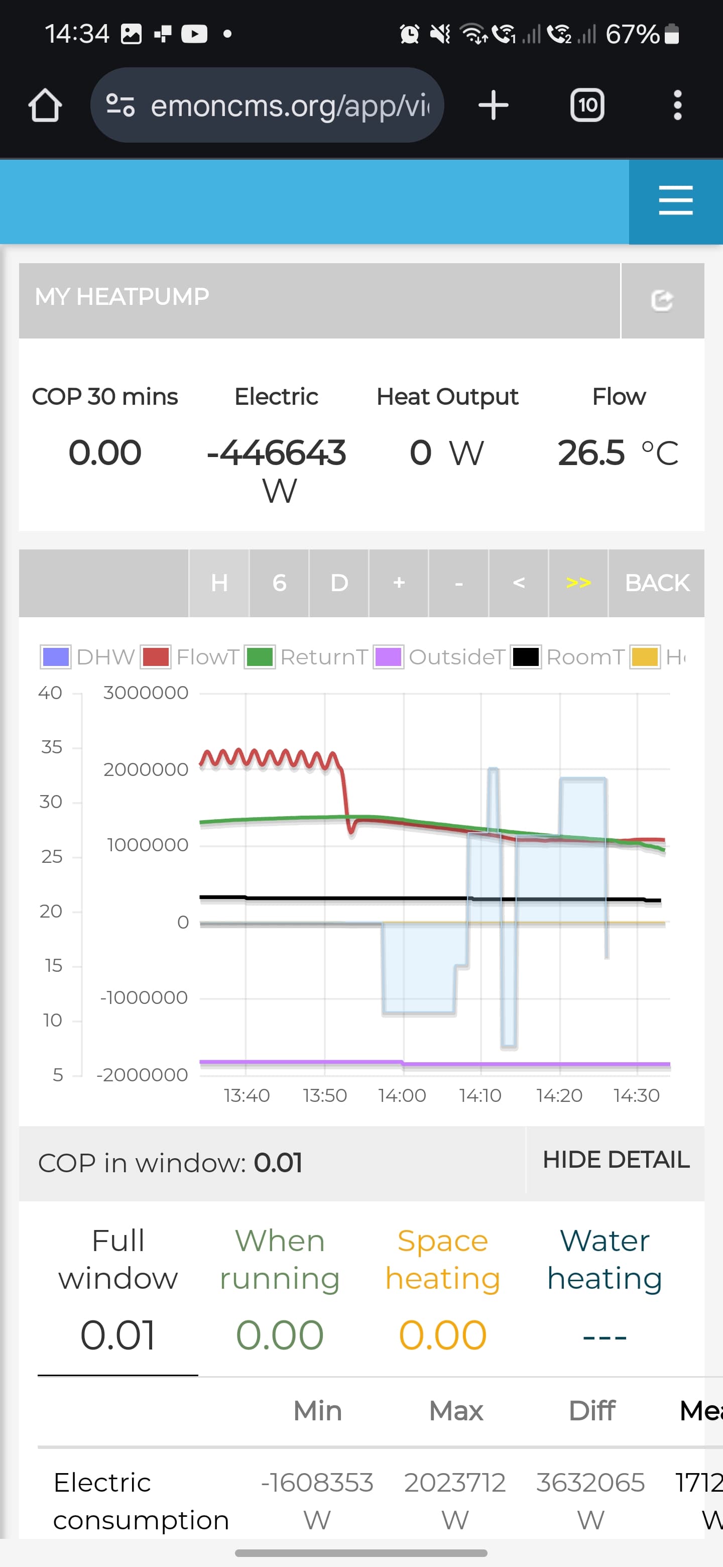

Storm Darragh seems to have caused very stange electricity usage on the meters. Lots of other stange behaviour in the house. Not a complete power cut, but some lights not turning on, appliances acting strange.
Does anyone know its possible to fix this data, this is going to mess up my stats.

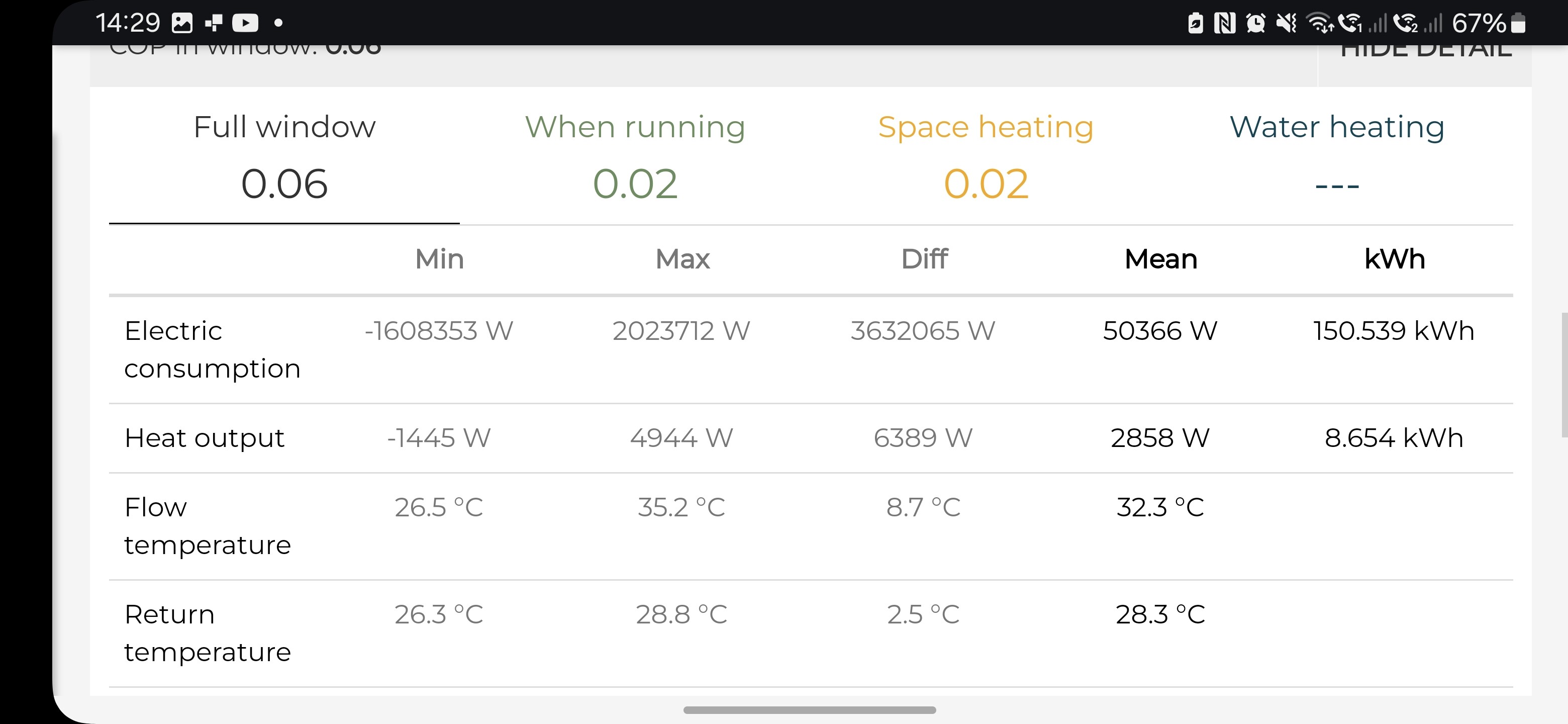

It was extremely unusual, I’d never seen anything like it. Some lights were turing on, others weren’t. Tumble drier (heat pump version of course) would turn on but it clearly didn’t like something about the supply so was just making knocking noises. Heat pump controller faulted and the little displays on the heat pump electricity meters were going haywire. They read a peak consumption of over 2MW and 2.3MW back feed. Yes 2 million watts. 1/20,000th of the entire nation grid demand just from my heat pump.
National grid think there was a complete powercut. I’m wondering whether someone nearby had a battery backup that was back feeding into the grid when it shouldn’t have been.
The electricity went off completely about 3 hours later for 30 seconds, then came back on and everything was normal.
@TrystanLea, @glyn.hudson,
Would I be able to get some support fixing this data? Or some way of adding this to me Emoncms account.
07/12/24 between 13:57 and 14:35 (ish) there was a net 72kwh electricty measured after the heat pump had faulted (but before I flipped the breaker), so was actually near zero.
https://emoncms.org/app/view?name=MyHeatpump&readkey=53646698bd10ba801ad47516e7e4a0bc
- Possibly this
- Possibly arcing on a failing supply feeding noise (and high energy RF) down the supply lines that gets picked up by CT meters as it gets dissipated in all the surge protection built into appliances (MOVs etc), coupled with a low overall voltage due to the failing connection having higher resistance until it popped?
The latter can damage things, especially anything with inverters/switching power supplies/RC voltage droppers such as cheap LED lamps
Hello @jakeymd1 yes Im sure we can fix this, will take a look
All fixed. We also had a power cut here and had the pleasure of running the house off battery power while disconnected from the grid for the first time

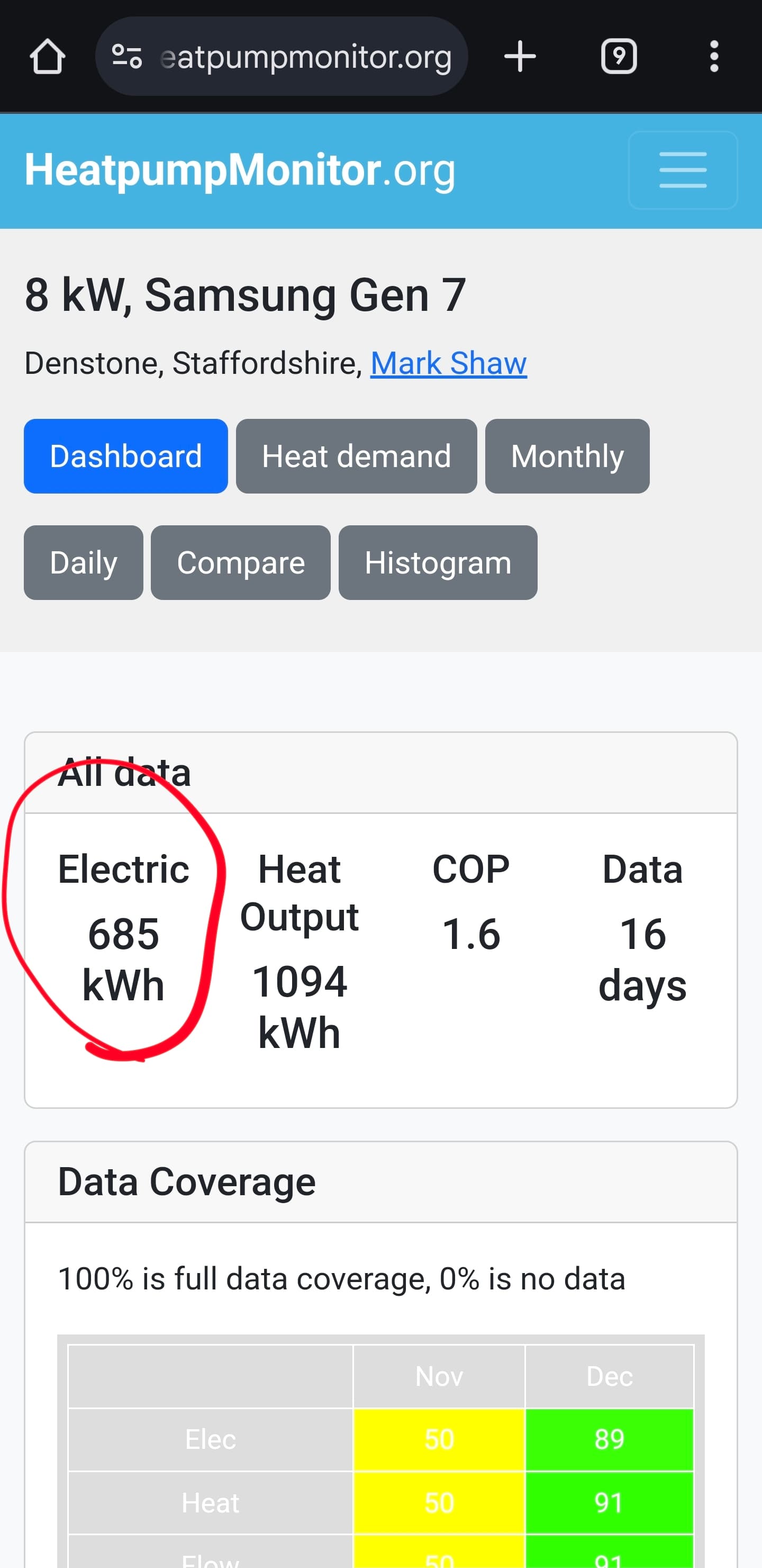

Hi @TrystanLea, theres still something strange going on with the data. All seems correct in emoncms, but heatpumpmonitor.org is still showing an additional 400kwh of electricity usage that emoncms does not.
I’ve just reloaded the data on HPM, this should fix it
jakeymd1
(Jake Dawson)
12
Thankyou very much. I’m now in very good company on the 7 day leaderboard.
