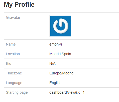

Hi,
Taking as example a post of Trystan, i am trying to set starting page (on My Profile
view) with my dashboard ID=1
dashboard/view&id=1
But after saving changes, if I change page or log out / log in, I can apreciate that starting page is missing the ‘&’ symbol, and main page does not work. Example:
dashboard/viewid=1
On the other hand, if the starting page is set to App view, the problem is not reproduced and it works OK. Example:
app/view?name=myelectric
So the problem comes from Timezone, Language or is the escape symbol ‘&’ required?
Only happens to me? :frowning:
Issue solved. If i assign an alias to my dashboard (for example: ‘main’), i can access with this new alias without any special character like ‘&’
Previous link not working as starting page:
http://x.x.x.x/emoncms/dashboard/view?id=1
New link working with alias as starting page
http://x.x.x.x/emoncms/dashboard/view/main
And works without any problem :grinning:
