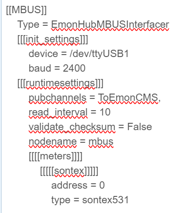

I was wondering if there’s anyone out there who could help me get my heat meter communicating again.
I have had the heat meter for several years. It used to connect OK to the emonpi using M-Bus. (The only oddity was that the buttons on the front panel of the heat meter never did anything, although the number on the display increases when the ASHP runs).
Last November, I sent the meter back to Stockshed to get it recalibrated (it was originally calibrated for 25% glycol, but water bled off the radiators froze at 0 degC!). Since the heat meter came back, I have not managed to get M-BUS working.
Here’s the log file following a restart….

The config file is below.
I have used ls -l /dev/ttyU* whilst plugging and unplugging the USB to the heat meter to confirm that /dev/ttyUSB1 is correct. The baud rate and address used to be 2400 & 0 respectively, and the documentation from Stockshed following the recalibration indicates they have not changed. (Out of desperation, I have tried other baud rates and addresses, and used Trystan’s scripts to try all addresses, but without success).
I had an old-style MBUS to USB converter originally. When I couldn’t get M-BUS working after the recalibration, I thought I might have swapped the polarity of the wires from the heat meter inadvertently, and fried the electronics, so I bought a new-style M-Bus to USB converter. But I have come across some recent posts saying that the wires are interchangeable, so I guess it’s no great surprise that I still cannot connect.
The new converter usually outputs 27.6V, although that can drop by a couple of volts. I guess that might be the converter asking the meter for data. There’s a large red LED that’s lit, and which dims slightly as the voltage drops. There’s another smaller red LED on the convertor. That’s completely off before the heat meter is connected. When I connect the heat meter, the M-Bus terminals on the heat meter see ~27V, so I think the wires are connected OK. The small LED on the converter now lights up (albeit very dimly) when the voltage dips.
It’s a mains powered Sontex Superstatic 531. The wire from the heat meter to the converter is about 1.5m long & shielded as far as I can tell. It’s routed away from mains cables as much as practical. I am starting to run out of ideas about what to try to fix the problem.
