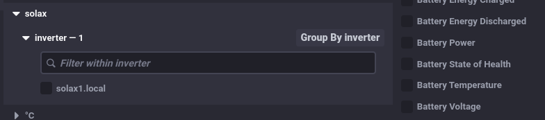

Also returning to this old thread. I have it working for my SK-SU5000 and only with the intention of writing realtime data from the inverter into InfluxDB on HA.
The data shows in Influxdb but there are no entity_ids created for the data values so by default it gives me a query like:
SELECT mean("Battery Power") AS "mean_Battery Power" FROM "powersNtemps"."autogen"."solax" WHERE time > :dashboardTime: AND time < :upperDashboardTime: GROUP BY time(:interval:) FILL(null)
instead one that should look like
SELECT mean("value") AS "mean_value" FROM "powersNtemps"."autogen" WHERE time > :dashboardTime: AND time < :upperDashboardTime: AND "entity_id"='Battery Power' GROUP BY time(:interval:) FILL(null)
Consequently the influxdb data doesn’t come across to Home Assistant as entities. Unfortunately this is beyond my python skills to navigate.
Any tips on how to fix this?
TIA.
