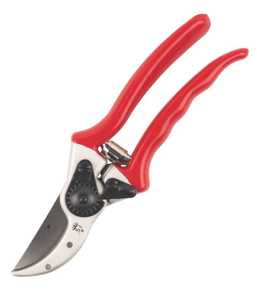

Here’s your solution, assuming that it’s allowed by The Management.
(Sorry, I couldn’t resist…)
Ive already told my neighbor I’m gonna be trimming her bush!
