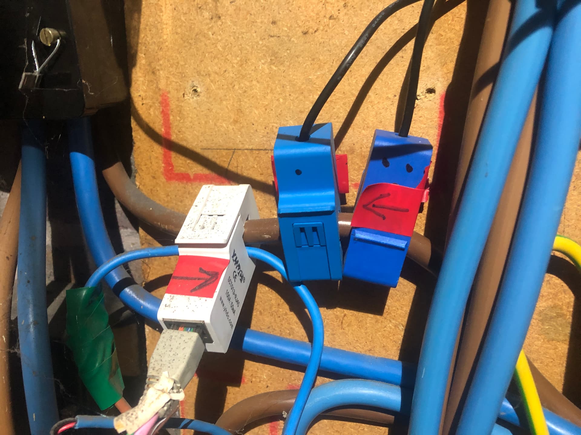

So in order for this to work in my situation, I would need a CT clamp around the HWC element spur, which is fed back to the PV router over a spare CAT6 cable. That remote CT would then need to be plugged into the PV router and the firmware customised to subtract that reading from the grid CT readings.
Do I have that correct?
Not quite. The suggestion is to change the wiring of the Gateway’s c.t.
Here’s my brown grid incoming live cable. My Battery’s grid c.t. is on the left and the Mk2’s grid c.t is on the right.
The additional cable running through the battery’s c.t. is the supply to the Mk2.

  • When the battery is exporting
  • The Mk2 diverts, reducing the export towards zero
  • The modified battery c.t. doesn’t see that the export has reduced - or turned into a short tiny import.
  • So the battery doesn’t react to the Mk2’s behaviour.
I don’t know if the Tesla Gateway has an accessible c.t. that can be tampered with in the same way that my battery does. But if it does, I think you could try fitting a c.t. around the immersion heater spur and extending it out to the gateway’s c.t.wiring and combining them as discussed here

I certainly didn’t realise you can wire two CTs in parallel in order to net their readings against each other!
With care! They must be both genuine current-output and the same ratio. This works because they are current sources, and wired in parallel the currents add.
If they are voltage-output type, both must be the same output voltage for the same rated current, and they are wired in series because they are voltage sources, and wired in series the voltages add.
You must calculate the value of the total current and size the burden accordingly; or ensure the sum of the output voltages doesn’t exceed the input voltage.
If they face in opposite directions, the currents/voltages subtract.
Or you can have a current-output c.t. with its own burden and it becomes a voltage, which you then wire in series.
