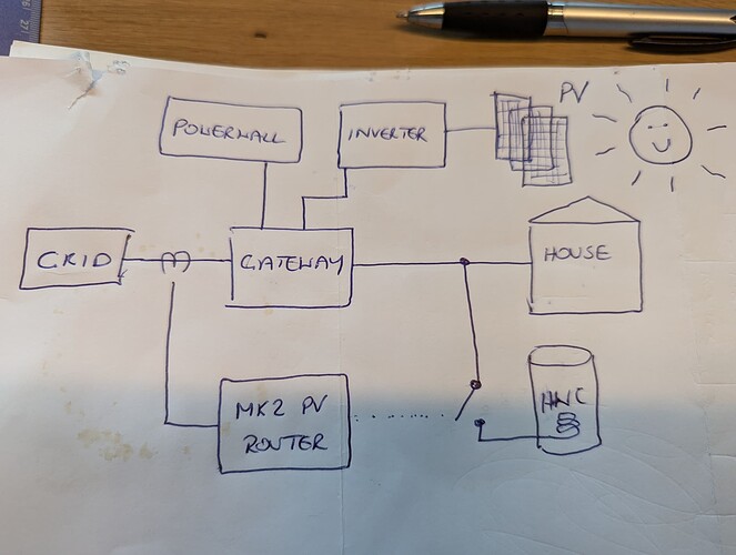

Can you do a single-line diagram (like mine) showing what you have.

Sorry, I am not setup for fancy diagrams so I had to hand draw it :).

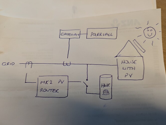

The Powerwall and Gateway are effectively “the battery”, and the physical wiring is a bit different, in that the grid feeds into the gateway, along with the battery and the inverter, and then the house is a load out the back of it - i.e. the gateway controls everything - but in terms of the logical flow this digram is the best match with how you laid yours out above.
…But you’ve left out where the powerwall & gateway connect power-wise, in relation to where the immersion heater feed is?
(I’m thinking is it possible to trick one of the systems, like feeding the immersion current backwards through the powerwall c.t. to subtract (i.e. remove it), or vice-versa with the powerwall feed and the router c.t.)
And can you restate your objective – primarily, is it hot water or a charged powerwall?
I don’t mind that - I wanted a clear diagram showing the essentials - where the power flows and where the controls are. Neutral returns and safety earths play no part when you’re looking it this type of problem.
Hopefully this is clearer - basically everything connects into the gateway, and that has all the “smarts” and relays for disconnecting the grid in the event of a grid outage (to protect the linesmen), and diverting excess solar to the battery etc.
The HWC is part of the house load, behind the gateway, along with everything else.
My goal is to disable the PV router until the Powerwall is charge to 80%, and then to divert any excess to the HWC.

Trying to reconcile the words and the picture, your grid infeed comes onto your premises, into the house, and goes via the Mk2PVRouter c.t. out to the garage and the gateway, then back into the house?
Or should you have drawn the gateway not ‘in-line’ with what I would term the “original direct line” feed from the grid via the meter to the house consumer unit, instead as a branch connecting to the direct line just downstream of the Mk2 c.t. and the supplier’s meter.
The PV router lives in the garage next to the Gateway. The CT clamp from the PV router is around the ‘original direct line’ from the grid/meter, before the Gateway. The grid feed arrives onto the premises in the garage.
I think the confusion is over how the PV router controls the HWC load - I should have made that more obvious sorry. The PV router sends MQTT messages over my home LAN network. The SSR controlling the HWC element is driven by a second Arduino device, which listens for these MQTT messages, and switches the load accordingly.
Hence the dotted line from the PV router to the HWC load switch, is over my LAN and not a direct connection.

Not sure I follow. There is a dotted line from the PV router to the HWC feed switch - it probably isn’t that obvious sorry! So the PV router is controlling that switch and as I started exporting to the grid, it will start turning on the HWC element to soak up any excess.
The problem is that once the HWC element is turned on, the Gateway will see that extra load and if there is not enough solar to cover it, will begin discharging the battery to cover any excess needed.
This means the PV router never “sees” the scenario when the HWC load is greater than the available excess solar, and hence never turns off the load, unless the battery is completely depleted.

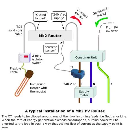

Lets strip this back a bit. Take another look at Mk2PVRouter - Introduction
In the block diagram
39cab288cf56fee4ffff8041d4355564
Consider that the “consumer unit” block is your Powerwall Gateway and that your battery is 100% full and the sun is shining.
Also consider that the Mk2router is inside your house adjacent to your existing smart switch and wired in parallel to it (so that when closed the smart switch bypasses the Mk2router).
In this scenario, your PV inverter will be sending power to the Gateway which will then be flowing out to the grid.
My Mk2router doesn’t have any nodered, mqtt or any such stuff. It is entirely stand-alone. It has a grid c.t., an Arduino sketch and a solid state power gate that opens and closes, conditional on the grid c.t.
The 240 volt supply wiring route into the Mk2 does not matter. Anywhere inside your gateway is fine. All that matters is that the c.t. registers some grid export and then the Mk2 increases the duty cycle of its gate (delivering energy to the load) and the grid c.t. sees correspondingly less export until a balance is found and your grid export reduces towards zero. (unless the water is already hot or if you have more than 3kW excess etc etc)
When the c.t. detects import from the grid (ie when the battery is charging from the grid), the Mk2 gate stays open circuit.
The battery is not connected directly to the HW heater so there is no reason why the battery will runaway and supply maximum power to the HW heater. The battery is connected to two switches in parallel - the Mk2 and your smart switch. The Mk2 switch will only activate when energy is flowing out to the grid, and your parallel switch will do whatever some other device (your finger?) instructs. So you can program some timer or SoC dependent water heating into this smart switch.
When wired up like this (as I have), the battery has first call on the PV energy. It will charge the battery before diverting excess to water heating. This is not entirely efficient because of battery round-trip losses. In my battery there is a register to limit the charge amps. When the season allows, I set this to a lower figure in order to force some export which will then be picked up by the Mk2. We find this convenient because the water is heated earlier in the day.

I think there is still some misunderstanding about my setup. I wish I was better at drawing so I could map it out more clearly.
My PV router is physically located in the garage, with a CT clamp around the grid feed, between the supply meter and the gateway. So it is correctly measuring the grid import/export, as in the diagram above.
The PV router is also directly controlling the power to the HWC, albeit via virtual connection over MQTT/LAN. The net effect however, is that as the PV router detects export to the grid, it will switch the HWC element on/off at a rate that brings the export back to zero. This all works and I have been using this system for years in my previous house, with no gateway/battery.
My PV router is the same as yours, standalone. It has custom firmware to send the load on/off commands over MQTT rather than switching a relay directly via a GPIO pin, but again, the net effect is the same. It is directly controlling the delivery of power to the diverter load, my HWC element.
It also has the ability for me to disable the diverter, via an incoming MQTT message. So I can tell the PV diverter to stop trying to divert if I wish. This doesn’t do anything other than prevent the divert on/off signals from being sent.
So aside from that, the PV router is very much like the diagram above, identical in fact.
So the PV router will turn on the HWC when it detects export to the grid - i.e. when the battery is charged and there is solar being generated, but also when there is a rapid change in load in the house and the battery might take a second to react meaning there is a small amount of export as it re-balances itself.
When this happens the HWC element turns on and starts drawing 3kW. If the solar generation is only 2kW and the house is using 1kW then there is a 2kW shortfall. At this point, assuming we are in the peak rate tariff (i.e. day rate), the gateway will try to avoid any import and start discharging the battery to cover that shortfall.
The PV router CT clamp sees the grid feed return to zero, since the battery has now taken over, but it doesn’t see it start importing, therefore it never sends the OFF signal to the HWC load. It is happy that the diverter load is perfectly balancing out the grid feed to zero.
So, because the diverter load sits behind the gateway, once the PV diverter is triggered by any kind of grid export, that load will remain triggered until the battery is depleted enough for the gateway to start pulling from the grid (or if there is a rapid load change in the house which causes a short spike of import), which the PV diverter will see and then shutoff the load.
As per Roberts original diagram above, if the diverter load was “before” the gateway, then the gateway would never “see” that load and the battery would never be used. Thus the diverter would be able to happily switch the load as required to ensure anything coming “out” of the gateway, and destined for the grid, can be soaked up before being exported.
