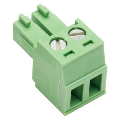

Hi Colin, this has been incredibly helpful, and pushed me toward chosing this inverter. I haven’t received the ME3000SP yet, but have built the interface module. I’ve struggled to find decent pictures of the connections on the underside of the inverter - do you happen to know what connector should be used for 485s interface on the inverter side?
Thanks,
Andy
Hi Andrew. It’s a 2pin 15EDG like this one…
