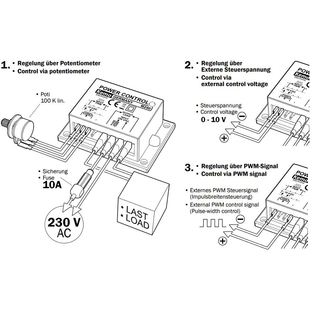

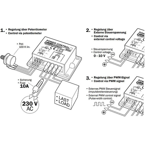

Another possibility could be a power regulator like this Kemo M240. By using a control voltage or by using a PWM signal, you could automatically have a finer control of the power output. I don’t know if the controle voltage or PWM have a different internal working.

  3. Some power regulators (eg. Kemo M240 of about 50 EUR) can be controlled by a control voltage or by PWM so that you have a finer control of the power the appliance gets. It adds complexity as you have to buy and build something to control it and to know how much power is exporting.

Just looking at the information of the Kemo M240 and the link to the datasheet. Intended use: “Control of ohmic or inductive loads at 230 V/AC 50 - 60 Hz, up to max. 10 A current consumption. The electrical loads must be suitable for phase angle control.

It would be prudent to check your national/EEC regulations for the amount of harmonic currents allowed, and whether this device meets the rules.
