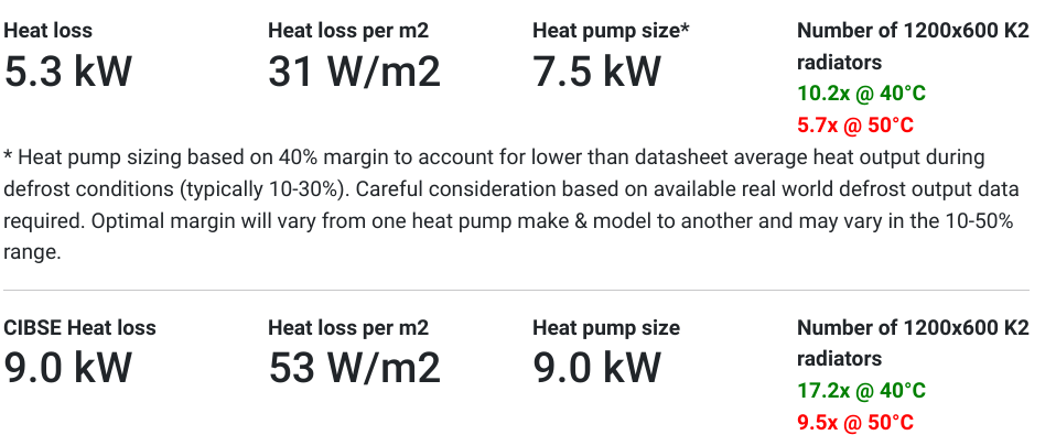

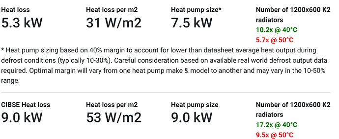

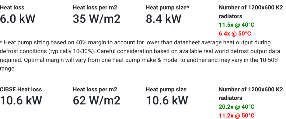

Here are my numbers.
170m2 detached. Originally 1960s, but altered significantly in 2014 so the default selections are difficult to match, for example half the exterior walls are from 1968, the rest are from 2014. The house has a warm roof construction which is better than the 300mm insulation option, and the windows aren’t triple glazed but are closer to this u-value than the default double glazing option.
At the time of the first survey (EoH trial) I had no understanding of the impact this would have of the efficiency of the heat pump. The installers surveyor went with worse case, but after a couple of months of poorly performing heat pump, it didn’t take much of a search around forums before I became aware of the underlying issue it had created, but the EoH trial wouldn’t accept the mistake.

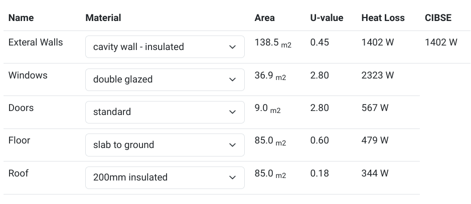

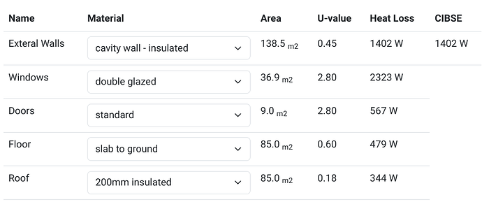

Installers approximate selection:

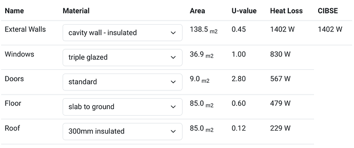

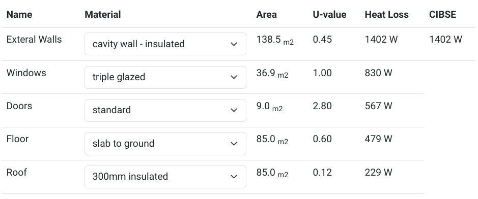

My selection:
To be fair a 10.6kW estimated, compared to 7.5kW actual heat pump size doesn’t initially seem like a big difference, but it’s roughly a 40% increase in output. As mentioned many times, we know correctly sizing the heat pump can make a big difference, particularly with how some of the heat pumps manage their modulation (or lack of it). If all manufacturers can solve this problem it’ll make a huge improvement to how adaptable heat pumps can be.
Actual heat loss, using OEM kit is around 4.5-5kW, so with more accurate assumptions the simple heat loss tool seems to do well.
