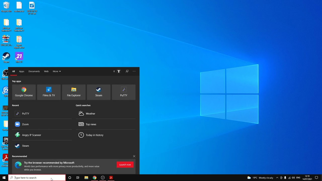

We have just uploaded the complementary Youtube video mentioned in the guide that shows you how to access the EmonPi via SSH. Hope it helps!
