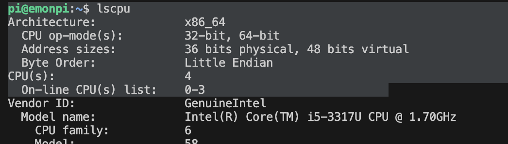

Is this 32bit or 64bit Ubuntu?

I appear to be running 64bit Ubuntu…

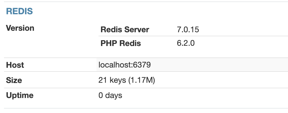

And, this is in REDIS display… I Think something is off: the machine has been running for about 24 hrs and “uptime = 0 days” - sounds “off”…
I will try @TrystanLea suggestion and come back…

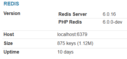

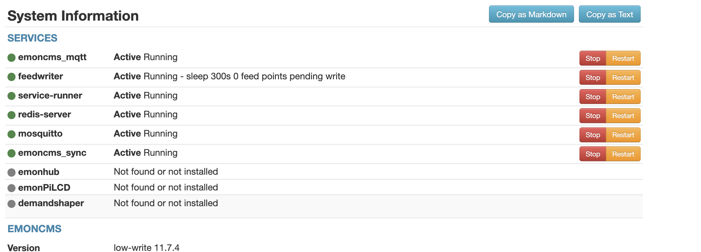

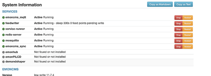

Worth a try. Would prove my thoughts are correct. I’ve not had time to try 24 myself again.
Indeed, your thoughts were correct, under UBUNTU 22 (ubuntu-22.04.5-live-server-amd64) everything operates as intended!
@borpin quick question: what should i NOT update in order to ensure everything continues working just fine? Sounds contridictory to “best practices” but I really dont want my server to start failing
Tks!
Good. I never had the time to get to the bottom of why. I think it may be a PHP or REDIS issue.
