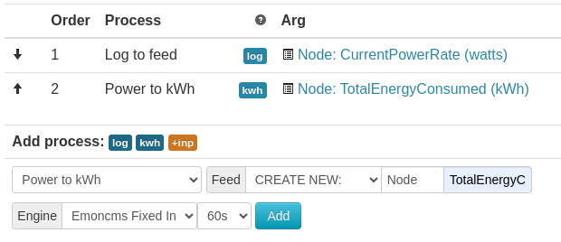

I am running emoncms on a RPi 4, emonpi 5.10.103-v71+. Data from Iotawatt is coming in fine. I’m not sure why I can’t get accurate info into the MyElectric2 app. No matter what feeds I choose for the app, the numbers are not correct. I’ve tried many formats. Can someone walk me thru this config? Let me know what info you need to see.

@gordopnac where are your accumulated values calculated? are you using ‘power to kWh’ in input processing? can you share a screenshot of what you are seeing?
I’m getting readings in watts from iotawatt. What settings should I use on the input to calculate the kWh needed for the MyElectric2 app?
You can add the Power to kWh step to the input process, writing to a new feed:
