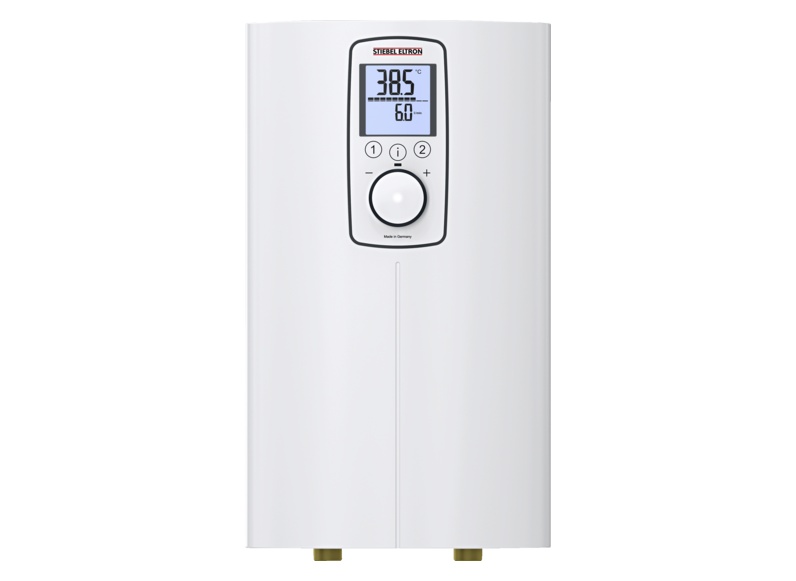

I’ve been looking at these - they take warm water and modulate right down.

They take a cold water feed and heat it to 43°C, 50°C or 55°C instantaneously but cost £350 and need a juicy supply current! (40 to 55A). Quoted flow rate is 1.3 litres per minute - feeble!
You do better with an electric shower unit.
Flow rate will vary on how warm the incoming water is. They quote based on cold mains water but the system modulates the flow to achieve the target temperature.
