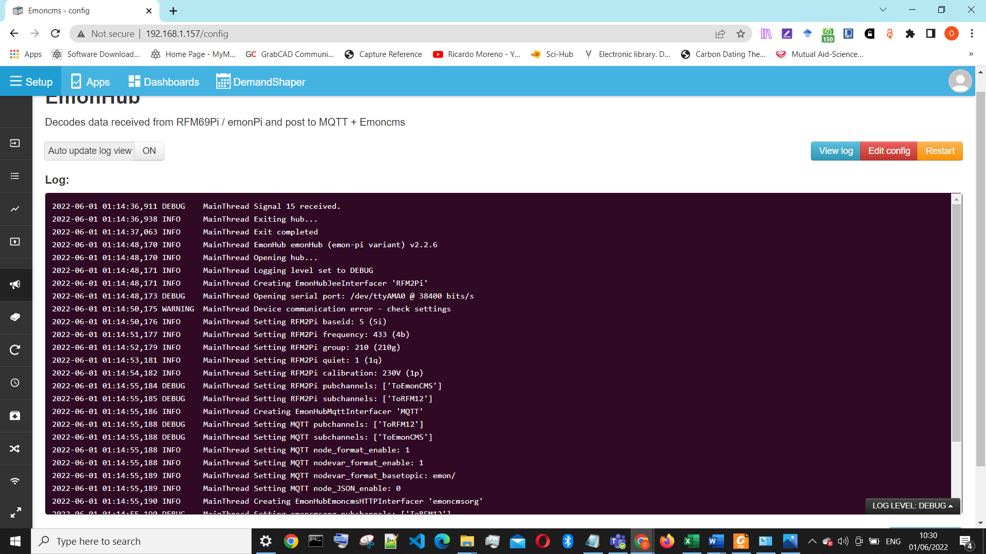

this is the log
and this is the config file

what can i do next?

i have just edited the config file and modified the interfacers
now i get some readings on the input page
my Log now logs in 3 values
am i on the right path? and how do i get other values because i can see it reads without even connecting a Ct sensor
