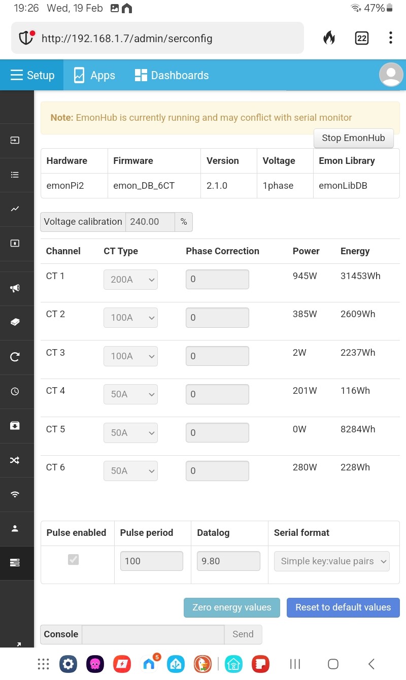

Hello, just starting to set up a new emonpi2 with 6 ct clamps. I have two problems, which may be related.
I have 3 cu units dotted around the house. Main one is connected to mains feed, then connected to 2nd and 3rd cu.
Just dealing with main cu at present.
Ct1 is for mains feed in 100amp, 200amp clamp with arrow pointing to cu
Ct2 is feed to another cu, 64a, 100a clamp, arrow pointing towards 2nd cu
Ct3 is feed to another cu, 64a, 100a clamp, arrow pointing towards 3rd cu
Ct4 is local plugs, 32a,50a clamp. Arrow towards plugs
Ct5 nof used
Ct6 is feed to heat pump, 32a,50a clamp, arrow pointing to hp
Following the instructions, i stop emonhub. The start ttyamao at 115200 and update ct clamp drop downs.
At this point it shows for 5 seconds then in blank. Try again anc press save asap and still the same. Come out of display and ho back and it shows basic 20a for all of them.
Have it set to 20a may be causing my second problem in that ct1 shows 4950 but ct2 shows 6236 as per the inputs screen

Can you try sending the command r to reset the firmware configuration to default?
Configuration — OpenEnergyMonitor 0.0.1 documentation
Another option could be to try to reset the firmware by re-uploading it via the Admin > Update > Firmware:
Hopefully either or the combination of these will get the firmware back into the right state to then start the configuration again.

Anyway when i started ttyamao, noticed it did a list that has all the correct settings in, even though the display still shows 20A for all 6.
I changed the displays to kwh and that does seem to have settled things down with P1 shows the highest figures etc. But when i add p2 - p6 they sometimes come out more than p1, sometimes less. Used virtual feed to get the figures

@Uk_pete_2000 confused about what’s going on here, is this a recently shipped emonPi2 from us? If it was older then there might be an issue caused by an older version of the emoncms serial config software version and I’d recommend an update… Perhaps worth doing a full Emoncms update from Admin > Update and also doing a firmware update to the emonPi2 itself as mentioned above.
The configuration in the serial config interface should line up with expectations, there should be no need to use virtual feeds at this point at least.
Brand new, just delivered yesterday, so still setting it up and learning at the same time.
Okay ill search out the update etc.
Did the virtual to see what they all added up to as opposed to whats being reported in p1.
In short - you weren’t. What you’re doing with the Serial Config tool is changing the calibration in the analogue “front end” of your emonPi2 from the default values. Those are listed here: emonPi2 Install Guide — OpenEnergyMonitor 0.0.1 documentation
This happens before the numbers reach emonHub and emonCMS.

Did a full update, followed by a firmware update and that cleared the problem. Everything is being displayed and more
