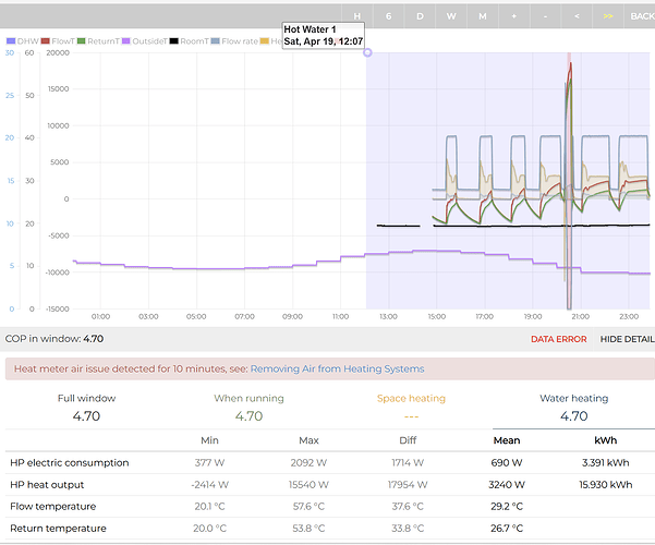

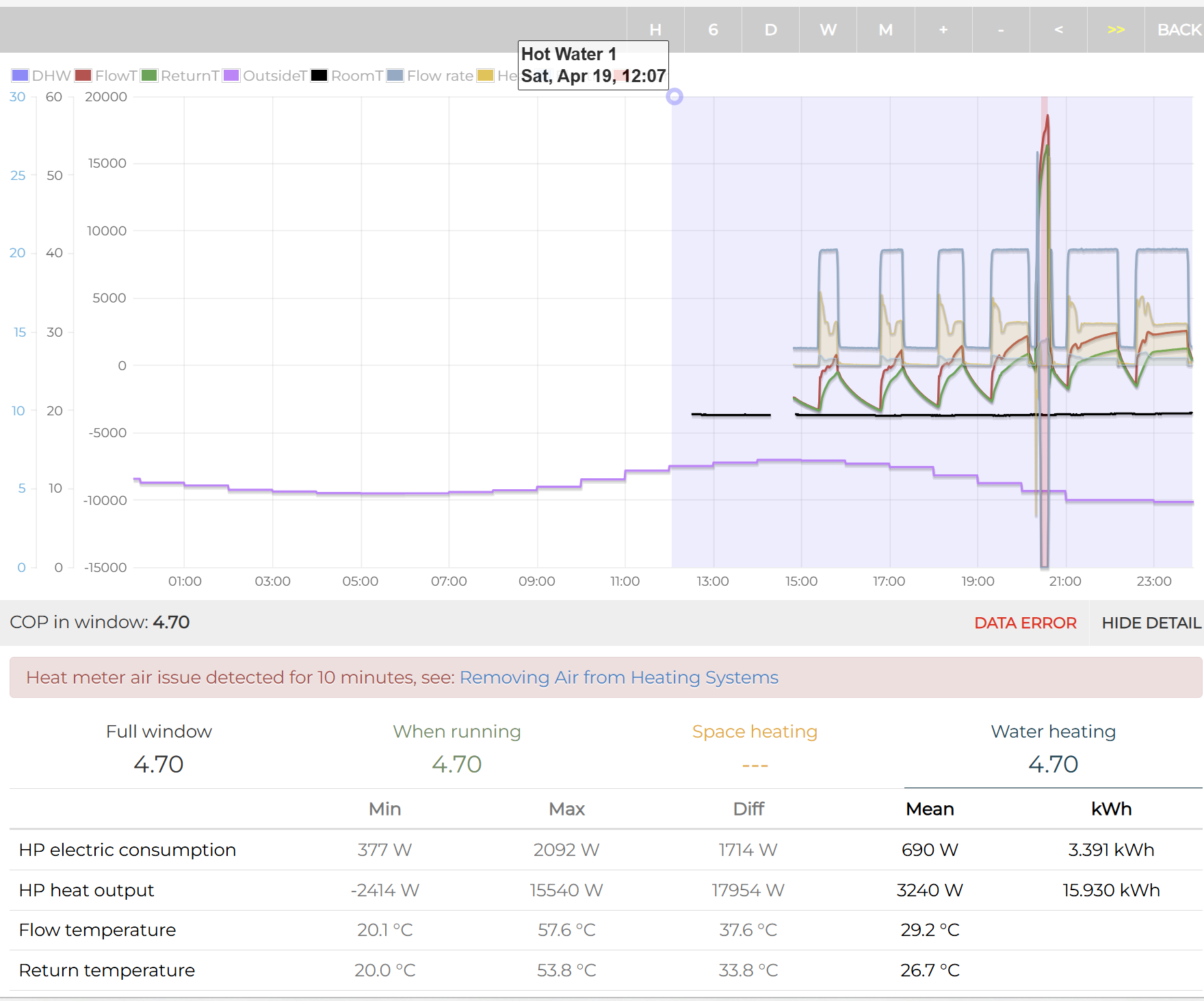

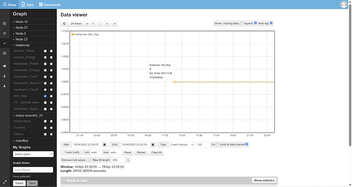

Might not be the right topic, but my dhw_flag is stuck on with a value of 1.
All my logging to emoncms amd heatpumpmonitor.org stopped just before midday yesterday. After a couple of restarts, the EmonPi2 seemed to be behaving itself again this morning apart from the dhw_flag. I suspect it didn’t like me restarting the EmonPi2 during a DHW cycle, but I forced another DHW cycle later, and the flag didn’t clear at the end of it.
Any idea on what to do?
Thanks in advance!
