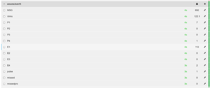

Hi folks,
I’ve got a bit of an antiquated setup compared to some of the newer hardware I see posted here. Hoping I can find some resolution to my issue.
I have an emonpi collecting data from an emontx3 (CM firmware) over the UART (they’re less than a meter apart so RF isn’t necessary). When I setup the interfacer per this page:
docs.openenergymonitor.org
emonTx3 direct serial — OpenEnergyMonitor 0.0.1 documentation
emonCMS is no longer respecting the names for the power readings I have defined in emonhub.conf. instead, the “Inputs” page on emonCMS just displays the generic P1, P2, P3, P4.
Is there any reason why this might happen with the USB0 interfacer?
Thanks for your support.
CJB

Screen grab from emonCMS
[Edited for presentation - Moderator (RW)]
To the best of my knowledge, the USB serial input bypasses the Node definition in emonHub.conf – the variables are sent as name:value pairs in the serial data from your emonTx V3.
So if this emontx3/firmware/emonTx34/emonTx34_CM/emonTx34_CM.ino at master · openenergymonitor/emontx3 · GitHub is the sketch in your emonTx V3, it’s lines 430 - 433 that need changing. At present, they send (using the numbers from your screenshot)
“P1”:7,“P2”:0,“P3”:0,“P4”:1

Thanks for your response Robert. I’m running a total of six emonTx3 units to the same emonpi and I don’t log all of the inputs as Feeds. So I’d end up with six P1s, six P2s etc. To further complicate matters, because of the ordering of circuits in the panel and use of the high sensitivity input on each unit, grouping the emonTx3 in any logical way isn’t possible. Given all these challenges, its just much more convenient to have the Input’s aptly referenced on display in emonCMS. And from what I’ve read in your post, it sounds like modifying the FW is the best solution in my case when using the USB interfacer
