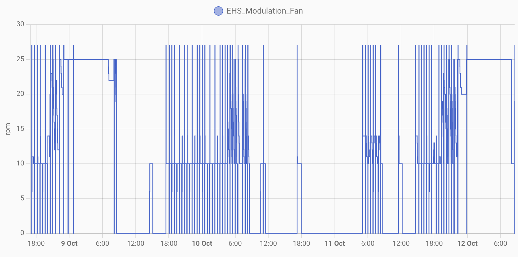

Has anyone noticed their external fan speed on their Samsung heat pump (AE160CXYDEK/EU (gen 7 r290 16kw) getting stuck on full fan speed?
This morning, I decided to go outside and have a look at what the heat pump was doing, and as soon as I opened the door, I was surprised to find it was operating the fan at full speed.
I toggled quiet mode, which made the unit go from 25rpm to 20rpm (no difference in heat delivery and an increase in COP, I presume from the fan not working so hard!)
I toggled the quiet mode off again, and it remained stable at 20rpm.
The Data
After reviewing the logs, I can see it’s done this before. This was the last time the outside temperature dropped low enough for stable state running.
Cure
I am attempting to cure this by running an home assistant automation that will trigger if the fan has been full speed for 15m and the system is running in heating mode
