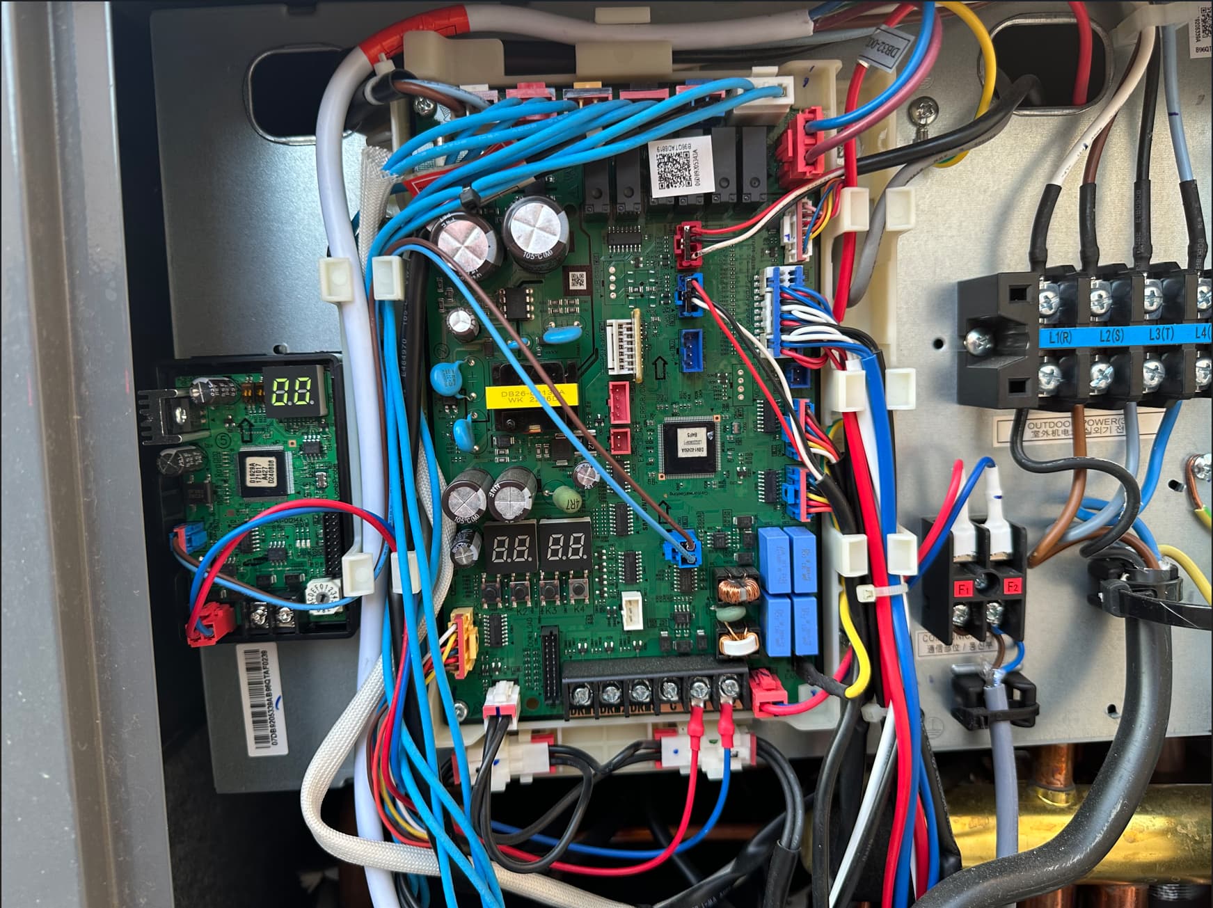

Hi guys,
I’ve just installed MIM-B19N to this heatpump and wanted to ask more advanced users here if I’ve connected it properly. Found that gen. 7 has a different PCB layout and it has only one board. But I’ve tried to connect is as best as I could so hopefully it’s correct (modbus terminals are not yet connected). It didn’t blow up and it’s powered and greed light is blinking. Also was interesting there is no dedicated space where I could fit it so I’ve stich it with some double tape on the left side.

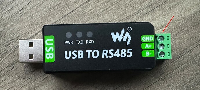

Also wanted to ask if I need to connect GND on RS485 to USB converter and ground on an outdoor unit ? Is it necessary ? Can I keep it not connected and connect only 2 wires to terminals A+, B- ? I’ve looked and communication cable which goes to control kit is not grounded either.
Additional question. Do I need to add terminating resistors 120 ohm on both ends or will it work without ? Don’t have any atm.

It depends. RS485 is really a 3-wire interface, A, B and GND. The GND connection is really a voltage reference for the A and B signals, rather than an Earth. However, with equipment that is mains powered and close together the GND is often connected to Earth, so does not require an explicit third wire GND connection.
If you plug your USB converter into a desktop PC, then the chassis and 0V of the PC are connected to Earth, so you can get away without an explicit GND connection. However, if you plug it into a laptop or anything powered by a wall wart, then these systems are isolated from Earth, and it may or may not work without an explicit GND connection (depends on leakage paths present). In this case you are better off connecting the GND explicitly.
For bus lengths of a few metres you can get away with no terminating resistor. But for more than that up to several tens of metres a single 120R resistor will be fine, and also improve the noise immunity of the link. Only when you get to hundreds of metres do you need terminations at both ends of the bus.

  1. The connection of Modbus controller to the pump was correct as shown on first picture.
  2. I’ve used twisted pair 0.8mm cable. I did not connect ground at the pump. Only connected at the other end (USB dongle) to the GND terminal. This probably has no impact and is probably not needed since Raspberry pi is connected to USB adapter so I doubt it is grounded. In any case communication works just fine.
