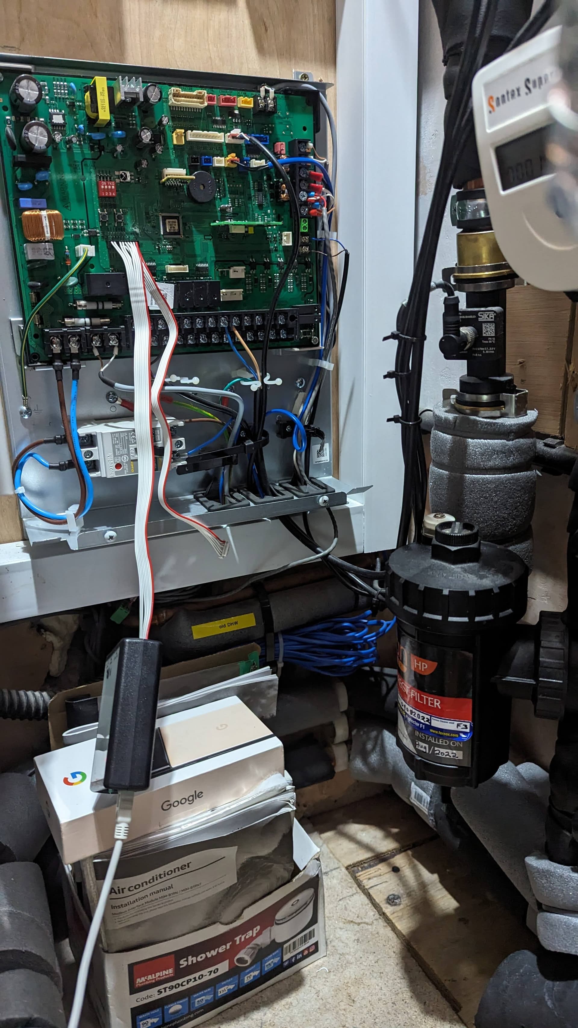

For info I could create an account on partnerhub.samsung.com and have access to all firmware files (needs to register a company details).
I was able to upload a firmware successfully with the RS485 adapter.
But now I experience a firmware “failed to download” (even with a new EEPROM)
I think in order to upload a firmware, SNET asks the indoor unit to switch to “download mode” to clear the communication.
Maybe there is something more than a RS485 adapter to this MIM-C02N dongle as I also have corean ? character in the "controller "and “communication check” part
I suspect also that Micom is located in the PCB, not the EEPROM as when I switched to an old PCB, the Micom changed…
Yes, there’s a ribbon cable you can connect to update firmware
