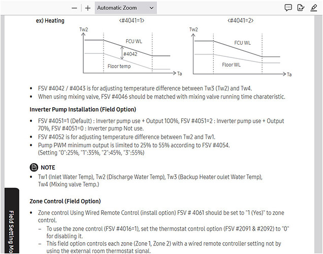

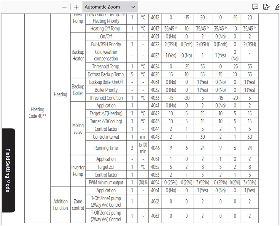

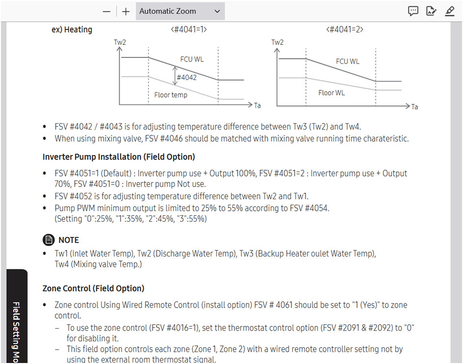

Good work, @Topaz, but in fact Samsung have beaten you to it. The manual for the #01PCB (the one with the “new” FSVs) contains the following intelligence for the “new” FSV#4054:

Yes, just to clarify (I hope I have this right!):
FSV #4054 is an enumerated user entry for minimum PWM% (0 = 25%, 1 = 35%, 2 = 45%, 3 = 55%). If PWM control is enabled (FSV #4051), then #4054 applies this minimum PWM% constraint to the circulating pump PWM output. (Owners with the version #00 PCB will have the default 0 = 25% applied.)
Edit: Unlike most FSVs which each have dedicated NASA registers, #4054 (and a few others) are handled differently. Any new values for these are written to 0x4612 (the FSV Information Table, which contains the Min/Max/Default values seen in the User Manual) by changing the Default value in this table.
