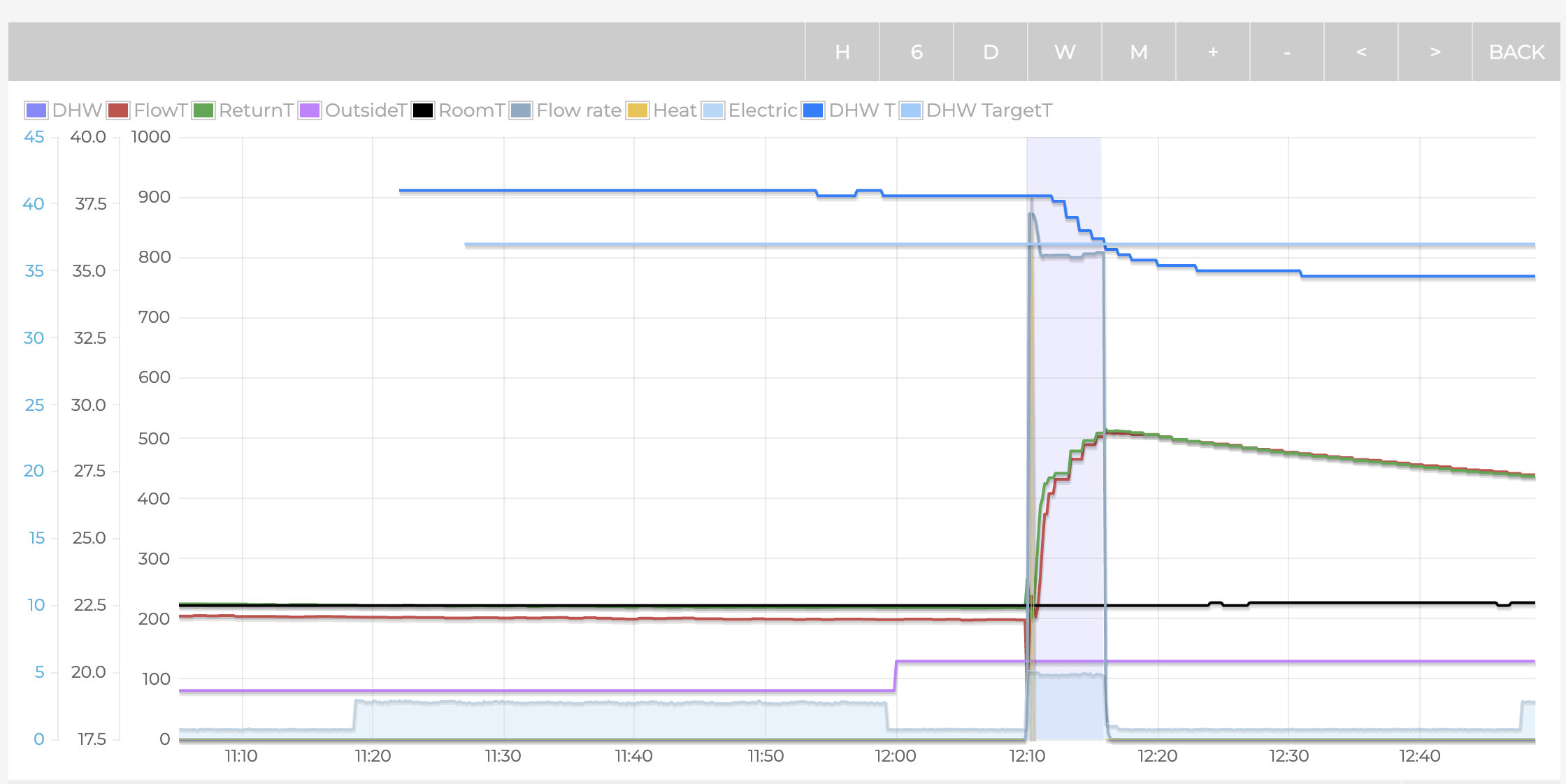

BTW, what makes me more crazy and wonder how about you is the fact that the pump is stealing heat from DHW tank.
Imagine there is no DHW heating cycle in given day but this STUPID Samsung is doing a 6 minutes pump cycle once per day. FOR WHAT ? And of course it will open DHW circuit for that! This will steal few degrees from my preciously heated water and eventually trigger DHW re-heat. I really wonder what idiot programmed this. Sorry for an expression.
Why it simply does not keep UHF circuit open for this ? Even in winter. I don’t want to open DHW circuit for these anti freezing cycles bullshit. When I did not have DHW there was no problem with that but now with DHW no way, we will steal heat from it. Give me the setting where I can decide!
And why it is doing this once per day in Summer season ? Just for a fan ? When I turn off the pump it is not doing this of course but why it thinks it is a good idea to do this when pump is on and idle ? I don’t need it at all! Wish I can turn off this shit, really. SaraH will say I rant again but is this a rant ? No, it’s desperation :slight_smile:

This looks to be the pump anti-lock function, this will run and take the heat from the mode it is in at the time.
You could try FSV 5022 and change to a 1 this will increase the time in-between runs to a max of 96hrs. with the anti-lock being in the logic you are unable to disable the function as it is a safety feature of the system.

If pump is running it of course not do anti lock/freeze cycles. This is doing only if pump is idle for some time and some conditions are met. At least once per 24 hours though. But if the both space heating and DHW are idle it will always open DHW circuit for this no matter what and this is what is bugging me.
Imagine in winter you turn off heating at night from 00:00 to 6:00. Because it’s below 5C outside the pump will do anti freeze cycles every few hours maybe 4 time per night and it will ALWAYS open DHW and steal heat from DHW tank (2c per run roughly). So you wake up and your tank is 10C less as it was at the midnight for nothing.
This is just horrible design. When I did not have DHW tank pump was also doing these cycles but of course it circulated water over space heating circuit and there was absolutely no problem. With DHW connected it behaves like a thief. So now if my heating is turned off during night the first thing in the morning is that HP needs to reheat the DHW tank!
I’ve cheated it with connecting 2 relays and with a help of home assistant I’m switching the relays as needed to control 3-way valve position. In case I detect the pump is doing anti locking or anti freeze cycle I will switch relay so it will not open valve to DHW circuit. Only if I detect there is really a call for DHW heating I will allow 3-way valve to open to DHW circuit. Yeah it’s not ideal solution but haven’t found anything better. It depends on HA so if it fouls up then I could have 55C in radiators :slight_smile:

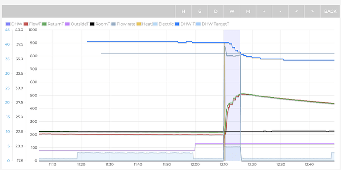

Well, improvement is that with these relays solution the pump does not steal heat from DHW tank. It’s a bit awkward but seems it works pretty reliable.
#FSV 5022 seems does nothing in this regard. I think they didn’t understand what you are asking. How this 96h delay can postpone anti-seize or anti-freeze runs ? It’s bullshit. It still takes heat from DHW no matter you set the parameter to.

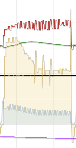

Modulation still sucks with higher outdoor temperatures. It works pretty OK with freezing temps but above +5C it’s a pain. Never seen a pump with such bad modulation. I don’t know why it needs to jump from 600W to 1000W every couple of minutes and all over again instead some linear increase/decrease. That controller in my pump must suck or the firmware is wrong there.

My heat pump does something like this when modulating which is a bit annoying
Once I get to DT ~13 I stop modulating (this should decrease as adding another 3 rads to the system this week, kitchen is unheated at moment)
But mine also does a bit of what I can only describe base on look saw toothing.
Which is annoying when the pump then cuts out due to LWT been two high, I feel maybe if you ran the compressor at the lowest power all the time you would cycle less! But there might be some more phyicas with gas and oil going on that I don’t understand.
Its is annoying that COP is actually increased when its working a bit harder instead of cylcing. I was going to explore something that keeps bumping the set temp up.

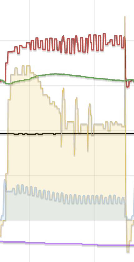

Mine does the same. The modulation is not smooth with low power input. Granted it could be because of low water volume in the system so inlet/outlet water temps reacts fast so does the pump. Also I have radiators so the heat exchange at lower water temperatures is not that great. I guess if I would add another 200l tank would help but it’s a meh.
Yes, the pump needs to work in optimal condition ho achieve high COP. That means high water volume and big heat exchange surface. Then your fan will work fast so the heat transfer from outside into the water is great. When there is above 5C because of my system the FAN is barely moving and that means heat exchange is slow so the COP is going down.
You simply can’t make it much better without increasing your heat exchange surface area or adding a big buffer tank into your system or buying a pump with better modulation. My unit is 8KW and the lowest power input is 600W and it’s very inefficient with my system. I would need something which can go to 250W maybe… Then the FAN could spin much faster to get more heat from outside. Yeah, it’s complicated but I’ve come to terms with it.
That’s why I’ve set min. 40C above 0C because with WL curve I need Samsung would give 30C at 10C or so which first is simply not possible and 2nd very inefficient causing overheating a very low efficiency. I would need maybe 45C from 5C+ and above.

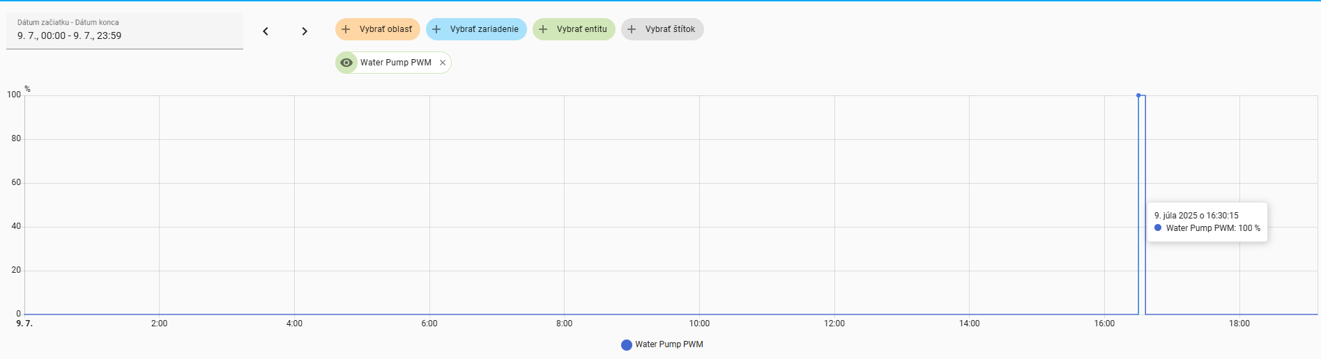

Does anyone know if there is a modbus register for FSV #2054 Inverter pump minimum PWM output?
