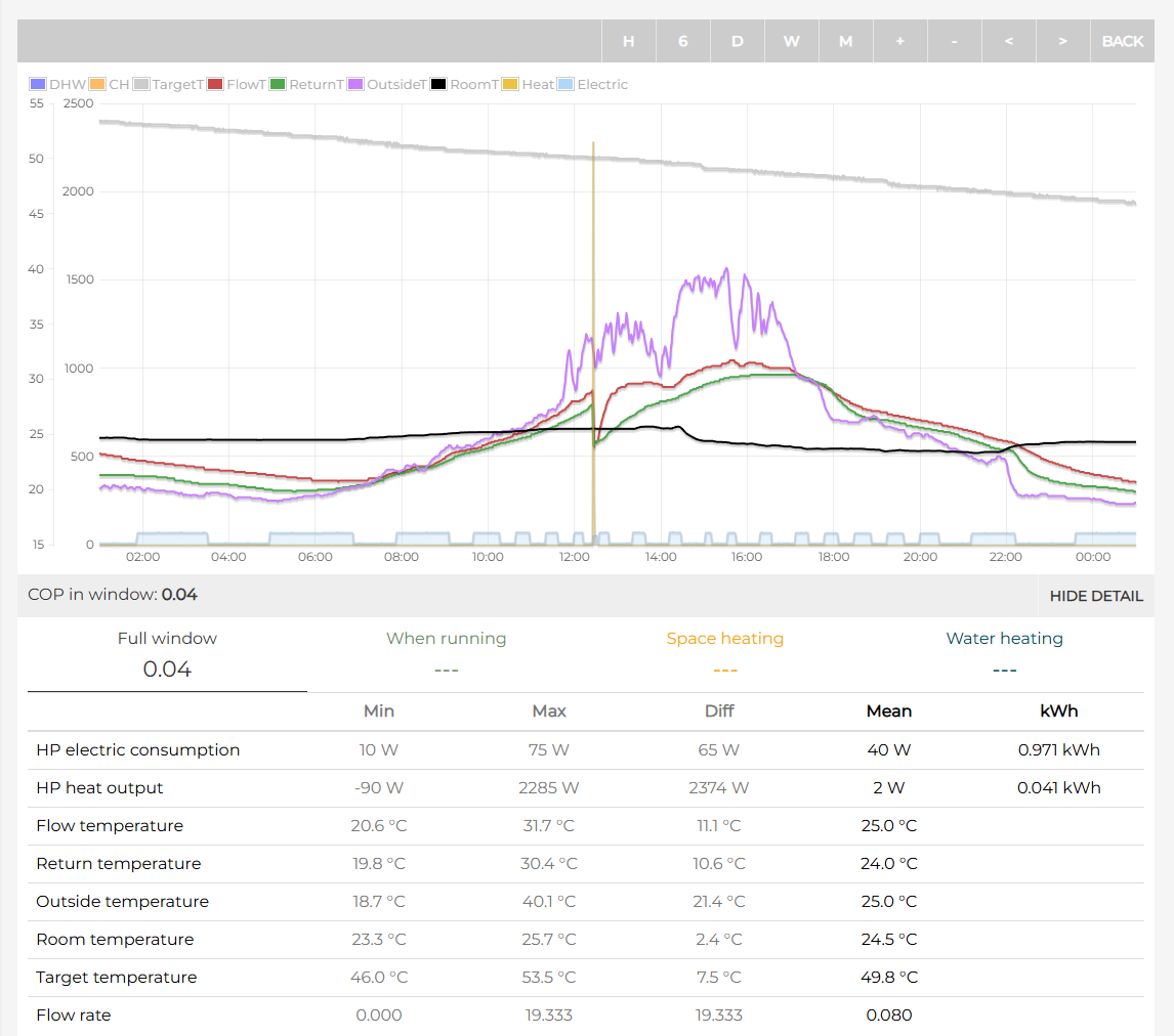

Hi Sarah, sorry, forgot to thank you for these hints :slight_smile: Nevertheless I need to revive this topic since it is still continuing even in case there is really hot out there so this won’t be energizing circuit for sure :slight_smile:
You can see here that there was 20C outside and still this damned consumption out of nowhere… I estimate it’s maybe 20h a days if the pump is off consuming 1kW of energy for nothing. Yeah not a big deal it’s 360kWh/year but anyway :slight_smile:
The pattern is that after the pump stops it is always idle (10W which I would expect) but only for a short time usually 5 - 45 mins then again is starts to consume 60W :slight_smile: Circulation pump is off and it’s not 3-way valve neither since it’s not moving. This is really a mystery and driving me nuts, any other ideas ? :slight_smile: That Modbus I hardly doubt because it’s polling all the time even on those idle periods with 10W consumption. Maybe it was like that before as well I don’t know, the only difference is modbus installed and DHW tank with 3-way valve.

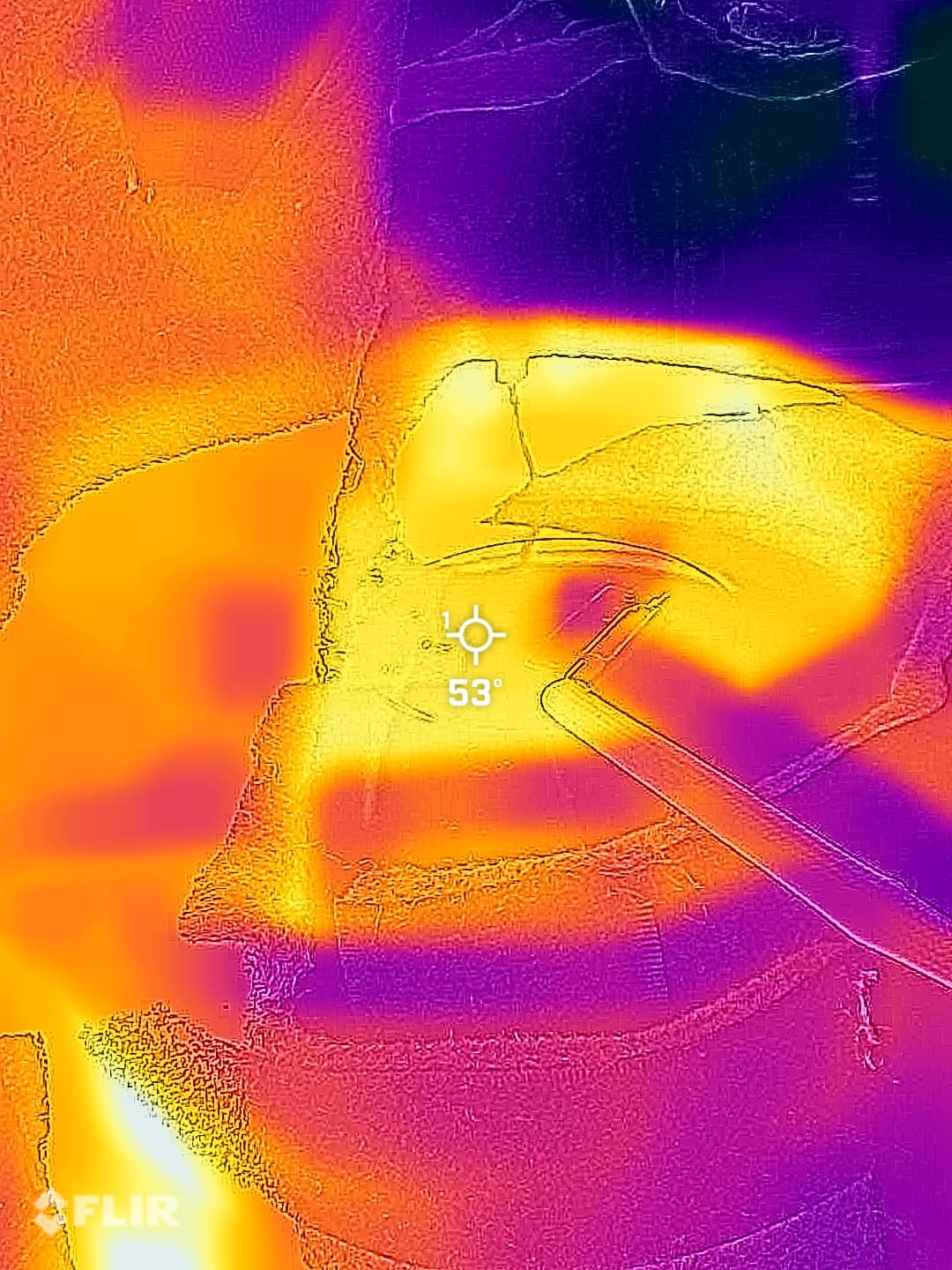

hey @Michal_S I have just commisioned my gen 7 r290 16kw samsung.
I have noticed the same 60w load, which I presume is a heater in the external unit which led me to Standby - Samsung EHS Wiki
Having taken all the covers of the unit you can see the compressor is nice and toasty. Would be nice in the summer months to turn this off and only do a prewarm before doing DHW.
I did note that the actual unit’s insulation is poor at best. Two very loosely fitted jackets that have massive gaps. I am sure just some tap would help seal it up.
I am tempted to put some Dodo DEAD-EZY car sound deadening mats in the unit to help with the compressor noise and extra insulation to help with the heat loss. Just stuff the whole thing with rock wall :smiley:

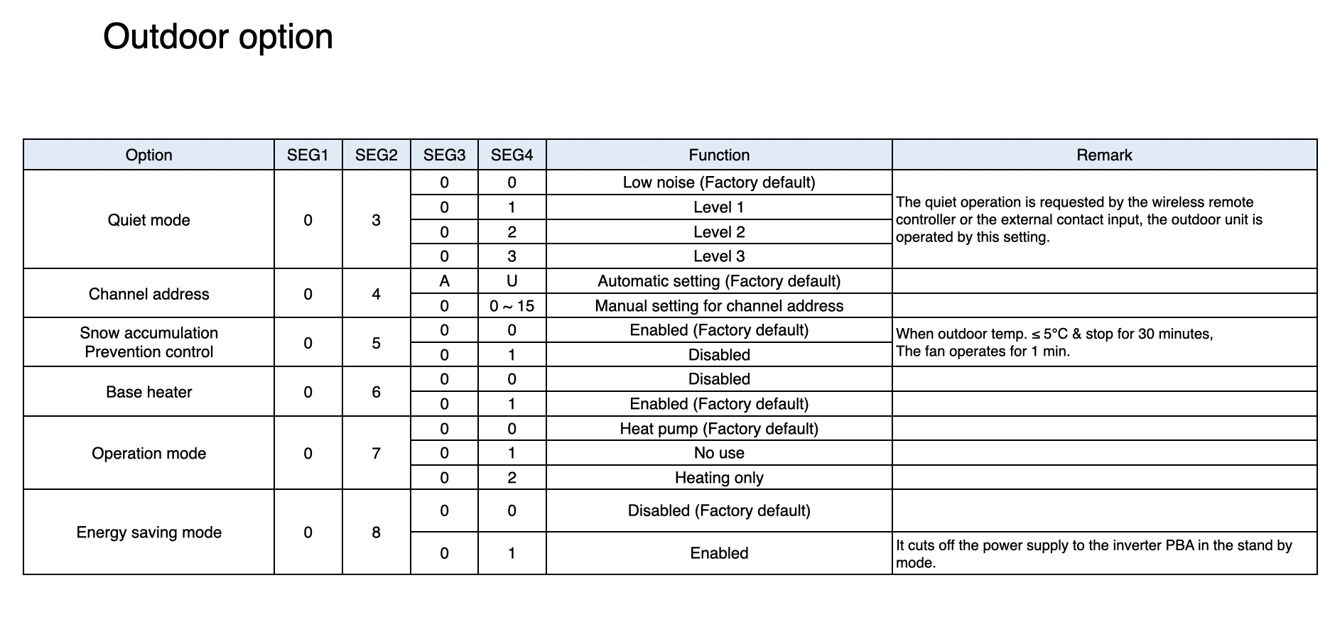

This may not be relevant to Gen 7s, but the Installers Guide https://midsummerwholesale.co.uk/pdfs/ehs-install-guide-samsung.pdf notes that, for the EHS range, the base heater:
  1. Can be disabled using the “K buttons” installed in the Outdoor Unit (the factory default is “enabled”).
  2. Is a 150W resistance heater arranged over part of the base panel of the unit (in contrast to your Wiki Standby reference which implies a 60W heater serving just the compressor seal oil reservoir).
The Guide also states that provision for free drainage of the Outdoor Unit casing is required to “prevent ice formation inside the base plate at subzero temperatures”. There is no mention of heating the compressor seal oil (which I suspect is one of the purposes the compressor “Safety Start” sequence).
I haven’t often seen the base heater activated on my EHS (though admittedly I don’t monitor the controller continuously). Indeed, looking through my SNET-recorded files, the only times I’ve seen base heater operating was during defrosts (and for a few minutes afterwards).

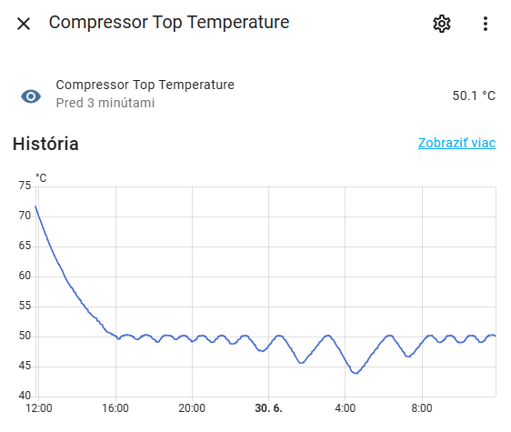

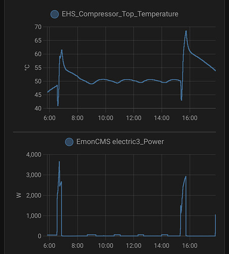

I really don’t know what this crap is but definitely it is heating something because if there is this load then some compressor temperatures are raising up. It’s really funny this is doing all the time during summer even if there is 30C+ outside.
This is graph from a day when there is no DHW heating… Completely wasted 1kWh of electricity…
This is how compressor top temperature is changing:

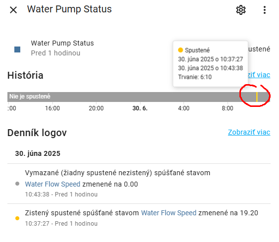

What is worse, that once per day this stupid pump runs a water pump!!! Why ??? With DHW connected it will just steal the heat from your DHW tank for no reason! It’s running for 6 damn minutes and I’m asking why… of course the pump is opening DHW circuit to do this shit.

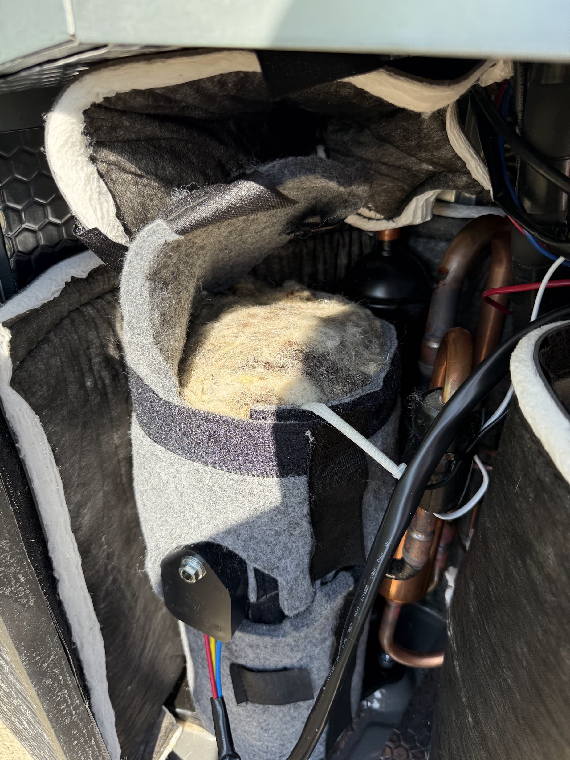

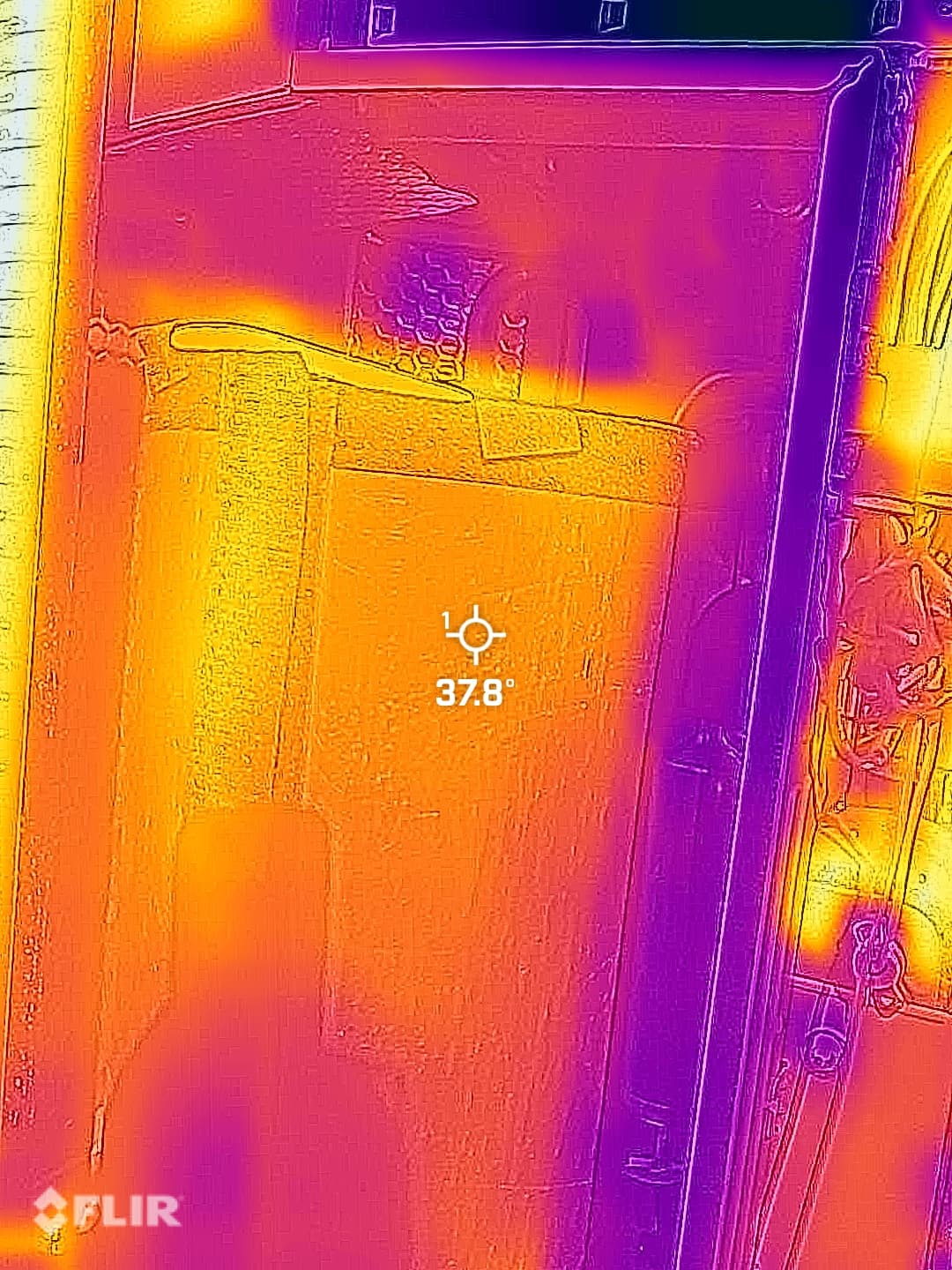

It’s defo the compressor.
The top of the compressor is at 53 °C. (its not done a dhw cycle for over 12 hours)
I’ve stuffed sheep’s wool insulation to reduce the compressor’s heat loss. Added about three layers on top and one at the bottom. (I would upload more images but not allowed)
I also added some thermal paste under the temperature sensor on top of the tank to help the unit get an accurate reading. I am waiting to see the cycle time on the heater.

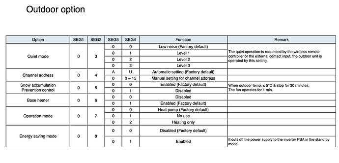

@Michal_S I found this some of the guides online
The energy saving mode is of interest, just the power supply to the investor PBA in the standby mode.

I will report back but it seems the energy saving mode has a good saving! Just waiting to make sure it does not do another heat cycle. It saves 2W vs the standby with it on, but it also seems to stop the 60w crank heater from coming on. I am waiting for a good few hours to pass to confirm this. (the extra insulation might just make the cool down slower)
Be interesting to know the compressor temp
Pretty much all the registers available over NASA can be accessed over Modbus. See …
Right at the bottom you will see how to initialise the Modbus interface to read the registers of your choice.
Thank you @toadhall so helpful! I am going to use this until I can get my esp32 code to work!
In other news the crank case heater is still cycling, just less now with the insulation.
