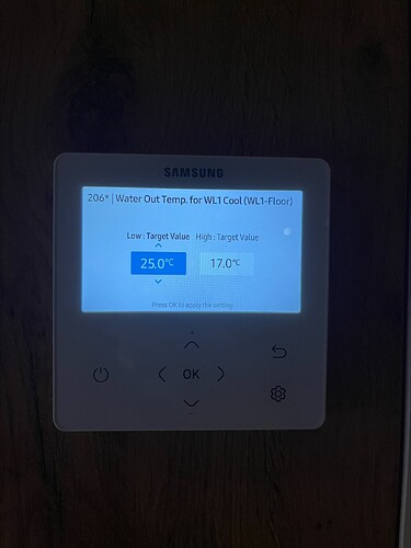

Here are my next questions
  1. When I compare what I see on-screen and what I see in the manual; it’s not the same. Every name is different and I’m not sure that I’m putting in the right settings. Take a look at the screenshots below for field settings 201 and 202.
    For 201:
On my controller screen (MIM) it says 'low/high.
On the table it says ‘max/min point’. (code 2011/2012)
On the graph below it speaks of ‘upper/lower limit’.
Am I correct to say that field code 2011 ‘maxpoint’ in the table is the same as low limit on the graph and the same value as ‘high’ on my controller (MIM), in my case -3°C?
For 202:
Is my target value ‘low’ (30°C) the same as field code 2022 ‘min point’ and the same as ‘lower limit water out temperature range’ (graph)
  1. These are my settings for cooling. Are those correct as welll?
Outdoor temperature
Water temperature
  1. For the water law cooling and heating combined; there is now a gap (heating untill 17°c, cooling starts at 25). What will the system do then?
  2. Does my system need some kind of ‘hard reset’ or do I need to cut off the electricity power on my fuse box?
Here below a full list of my settings
Anyone is free to give feedback, obviously…
Thanx in advance to the community for any feedback

The Samsung documentation is very difficult to understand. Also there are lots of websites with incorrect information about setting up Water Law. I am not surprised you are confused.
My understanding (which works for my system) is that for both screens 201* and 202* the “high” and “low” are referring to the relative temperature of the water leaving the heatpump. Taking 201* as an example, the “high” water temperature is required when it is coldest outside, and a “low” water temperature when it is warmer outside. The settings in your photo are the correct way round and sensible values.
Moving on to 202* the “low” figure is the temperature of the water leaving the HP (when it isn’t too cold outside) and the “high” figure the temperature of the water leaving the HP on a very cold day. Again the settings in your photo are the correct way round, but I believe too big. I think you need to reduce both by at least 5 degrees for a well insulated house.
In your situation I would turn off as many additional features as possible, and focus on understanding/setting Water Law for heating. Turn off COOLING in service mode >Indoor Zone Option> Cool/Heat Selection. Disable the remote thermostat by changing #2091 and #2092 to NOT USED. (I think your #2093 is set correctly, but this is an area I haven’t investigated.) You may also wish to turn off DHW and Disinfection while experimenting.
Once you have Water Law operating correctly, reintroduce the extras.

  1. What do you mean with added a target LWT (what does LWT stand for?) and where did ‘it’ add the target LWT? ← picture/screenshot?
  2. 2041 added to the list. I only have one zone so I have selected WL1 floor for 2041/2081, based on your comment that should be correct I think.
  3. We used cooling last summer without using a seperate roomstat. Cooling worked fine using only my MIM, it demanded an extreme energy from my system resulting high energy costs, but it did work. I rectified my error on the settings 2051/2052 (well spotted!), should be good now. Lowest temp I chose was 17 because I read somewhere that 16 or more is required to prevent internal floor condensation.
  4. What about my setting for 2093; is that correct/optimal for me now you think? (see list below).
@MikeJH I can’t set my thermostat to 22, I can only +/- on water temp. I think that’s because of this setting: options → standard temperature → water outlet. Correct?

Your original screenshot showed that you were using the controller in ‘indoor temperature’ mode. This is the correct mode to use.
You need to set standard temperature to indoor. That will allow the heat pump to operate in Water Law (Samsung speak for weather compensation). If you set your thermostat higher than normal, the heat pump will keep running and will choose the LWT (Leaving Water Temperature) (labelled Water Outlet in the photo) that is appropriate for the current outside temperature. If you have your water law settings correct, then your indoor temperature should sit around 21C. If it goes above this you need to reduce your water law settings and vice versa. As @SteveSpanners says, to get the settings right can take some time.
202* high target value of 45C
is probably too high if you have underfloor heating and a well insulated home. Just in case Samsung gets confused, I always set 202* and 203* to the same values.
If you have standard temperature set on water outlet as in the photo below, then there is no weather compensation and so this mode is rarely used. You need to change to Indoor Temperature mode.

Sorry, my English isn’t perfect either… I was just referring to the scribbles I made on the Water Law graph in my manual to help me understand the Water Law concept. To add to @MikeJH’s explanation, “LWT” = the water (or glycol) temperature leaving the Outdoor Unit, which is usually only slightly above that arriving at your radiators. (“RWT” is used for Returning Water Temperature – hopefully you can guess which point that refers to.)
That’s OK (at least for #2041).
Yes things are different if you don’t use the Samsung Remote Controller for room temperature control (like me - I use a third party roomstat, in which case a second roomstat would be required for Cooling).
Looks fine to me.
I’m guessing that the heat pump will do nothing (though the water circulating pump may continue operating). But that’s only a guess…
I’ve never had to reset after FSV changes, so I think the answer is probably “no”.
Can’t see anything obvious.
