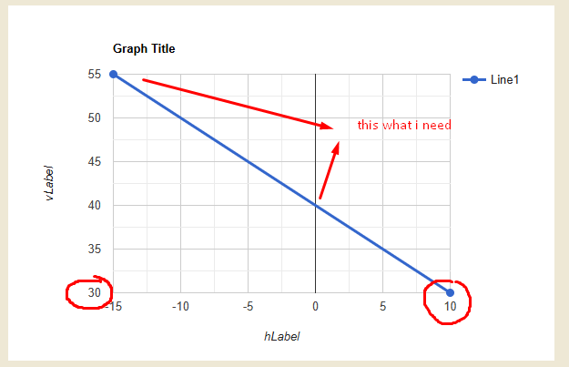

Wait a moment, I think there is not a common understanding here so I would try to explain with images since it seems my English sucks :slight_smile:
For my system the system is running best with water outlet temperature 40C at 0C outside. And in general above 40C. Bellow efficiently is not good because radiators are not able to dissipate the heat efficiently. So my goal would be never run lower than 40C flow temp no matter if it’s cold or hot outside. Remember I have FCUs so 202* is out of scope for me.
So this is my starting point. Then at -15C outside I need a water temperature 55C. So, let’s draw this on graph…
So to achieve 40C water temperature at 0C and 55C at -15C then I have to set #2031 to 30C because #2011 won’t allow me to set lower outside temperature than 10C. But this mean where there will be 10C outside the pump will output water only 30C which is absolutely inefficient for me…
Do you know what I mean now ? Ideally I need this but because controls are simply stupid it’s not possible.

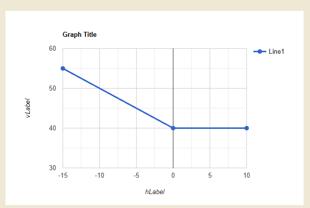

This would be possible only in case I can set #2011 to 0C. So the configuration would be as follows:
#2011 (low) = 0C
#2012 (high) = -15C
#2031 (low) = 40C
#2032 (high) = 55C
If you will tell me it’s possible I will apologize to call Samsung controls stupid :slight_smile: I’m quite of a technician so I know how to set up thing but I was simply not able to do this with this pump.

Ah now I understand what you are trying to do, @Michal_S.
What I don’t understand is why you want your radiators at 40degC at high outside temperatures - if at 40degC your radiators keep your house warm at 0degC outside, they should not need to be still at 40degC when it’s 10degC outside.
When you say…
…in what way is 30degC LWT “absolutely inefficient”? On the contrary, a lower LWT is normally associated with a better CoP, so really you should be pleased with your Samsung :+1:.

For outside temperature bellow 5C all is fine. I have water set to 37C at 5C and 55C and -15C but problem is that then at 10C or more outside you have flow temp around 32C or less. Simply with two points on weather curve I can’t set this. If samsung would allow to set flow temps for outside temps bellow 10C it would be fine but it’s blocked for some reason and I can’t select less than 10C here. And if I set 37C@10C then at 0C I will have 47C flow which is too much.
Normally I would set it like this e.g
#2011 (low) = 5C
#2012 (high) = -15C
#2031 (low) = 37C
#2032 (high) = 55C
Then the lowest flow temp maintained by pump would be 37C and it does not matter if it is 5C outside or 15C outside… Sadly, not possible.
Admittedly the two-point WC “curve” is a Samsung limitation (though I gather that most cheap ASHP controllers do the same).
The other thing that you could do (though it would be a compromise) is to lower the gradient of the WC line by dropping your #2031 setting by a few degC and increasing your #2012 setting by a few degC. This could still pass through 40degC at 0degC, and thus lessen the adverse effects you see at high outside temperatures, but would mean that you’d need a little supplemental heating on the coldest days (how often does your outside temperature go below -10degC? If only for a few hours per year, switch on a fan heater in your critical room(s) or put on another layer of clothes).
Finally, don’t forget that you can very easily adjust your WC line up or down by up to 5degC at the remote controller (or via your MIM-B13N) on a day-to-day (or even hour-to-hour) basis. I occasionally resort to this if cold ambient temperatures coincide with a strong easterly wind (which increases heat loss from my rather exposed living room disproportionately).
Exactly, but if they wouldn’t stupidly limit #2011 to +10C and above then it would solve all my issues and I could set this to 5 or even 0 to get minimum flow temperature.
Or as Tim suggested another setting where you can set minimal flow temperature explicitly but this is not there or at least I haven’t found it.
