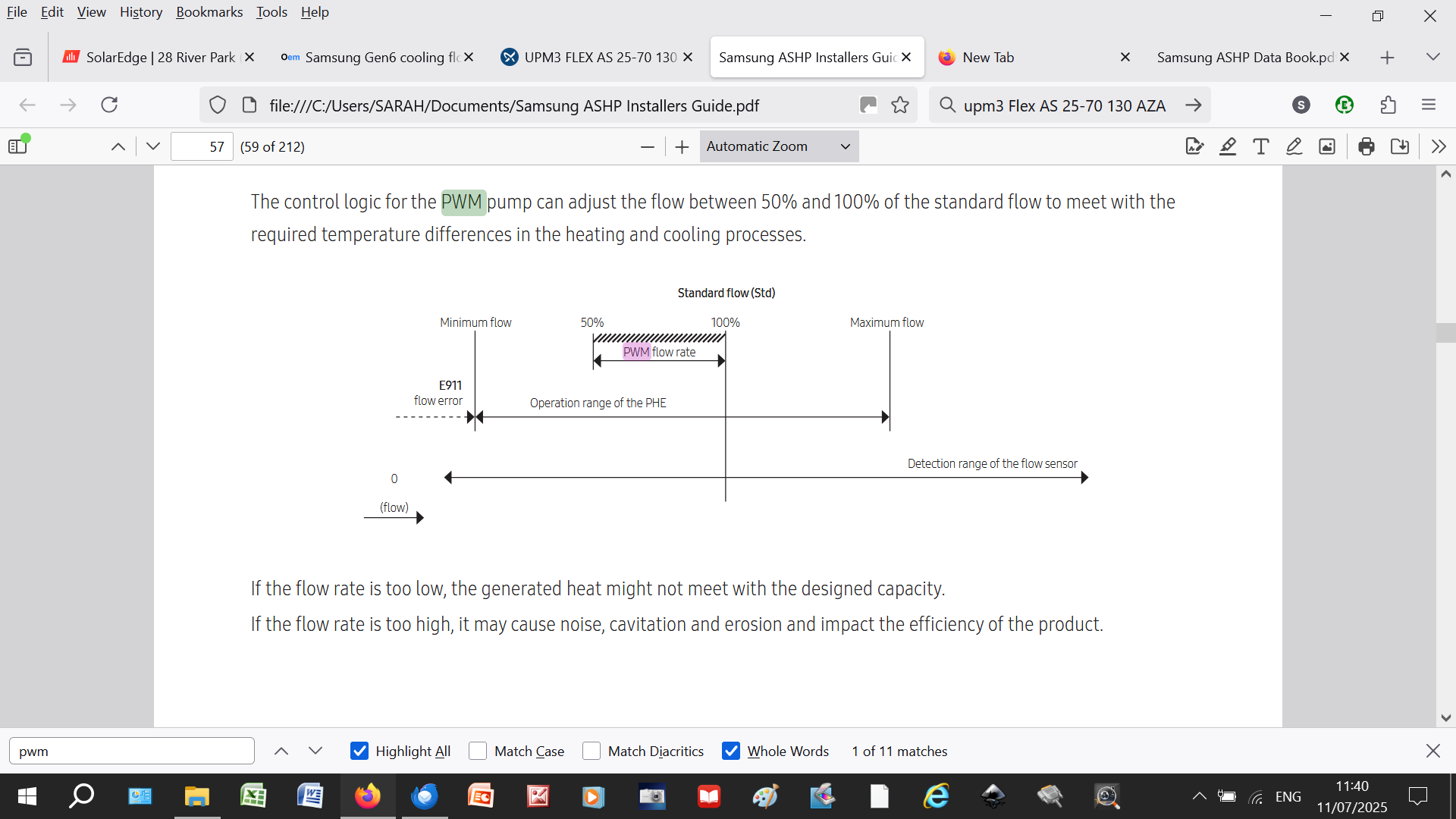

Worth a try. I just checked your pump spec - 52W max so you’re nowhere near the max 0.5A current. So you can probably ignore my previous post…
BTW what is your water flow? Is it running close to the minimum allowed? (~7lpm from memory)
Thinking on… yes your PWM could have been running the pump speed down to the point that the low flow trip cut in. So a good idea to try running at constant full speed, as a test…
I normally get 18 to 20lpm flow when pump is running at 100%.
I might try the consistent speed and see what happens.
Yes, I would. Here’s a screenshot from the manual:
You can see that at 50% speed you might be getting close to the E911 error setting…

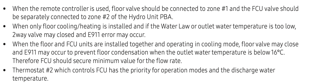

So I dissabled the pwm and also adjusted the minimum flow temp to 16 degrees, as I found this in the manual.
It did run for several hours, but im now back to the same problem with 40 mins run time max before getting e911 error. I think it something to do with flow temp being to low and it closing the valve for some sort of condensation protection, which shouldn’t be happening if my flow temp is no lower than 16

Which valve are you referring to here? And do you have UFH?

I didn’t make any changes between the run for several hours and run for 40 mins. I only have radiators.
So I’ve worked out today that as long as my flow temp doesn’t go below 16 degrees It keeps working. It started playing up yesterday after dark, so maybe as outside temp dropped, the flow temp also dipped and caused it to stop.
