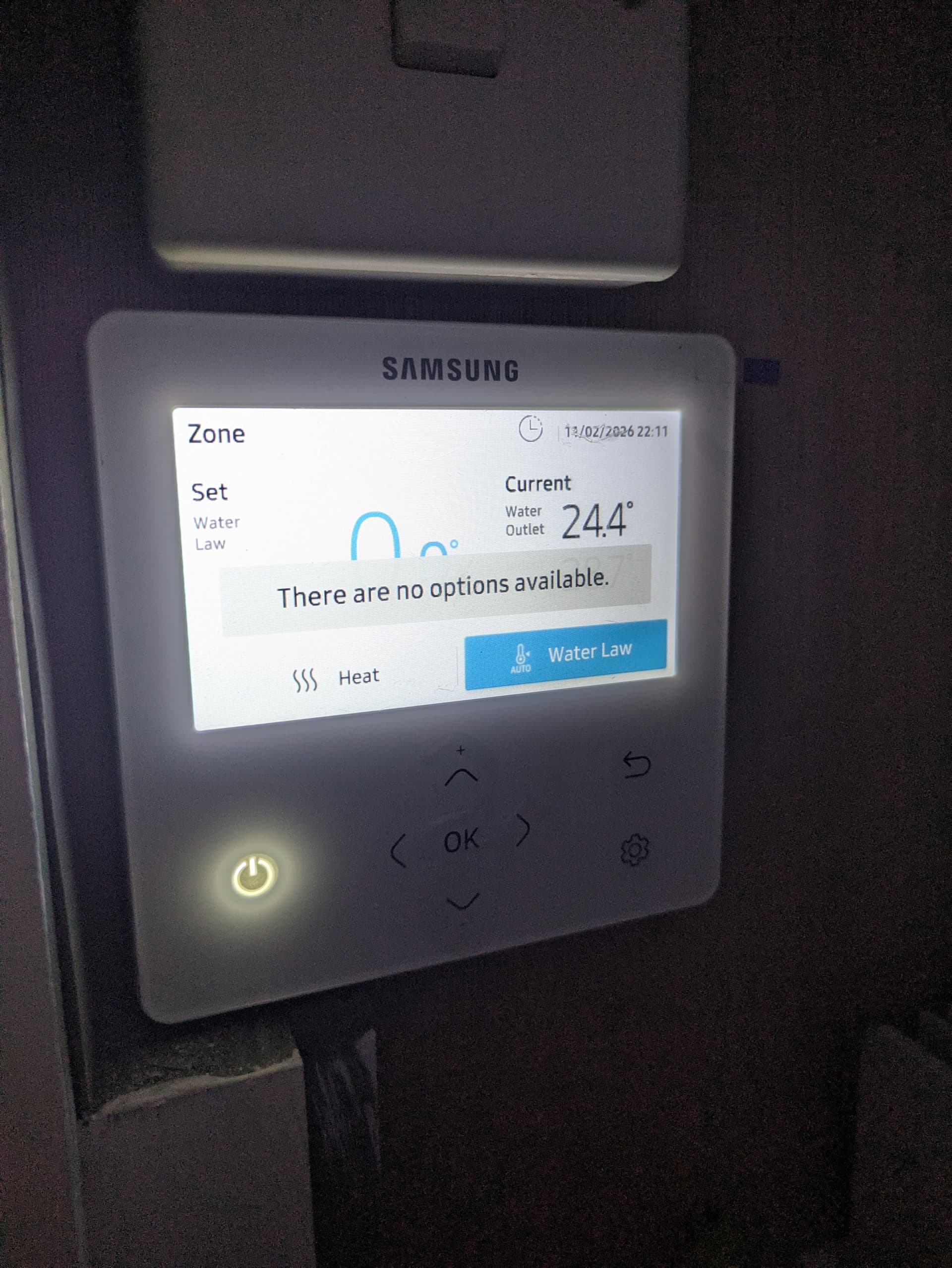

Does anyone know if some indoor units are locked to “Heat” in the blue section of the front screen…want to to set it to Auto as suggested?
Run through options without success.
Perhaps its the same for selecting cool?
Press ok with it highlighted but says…no options available" ?

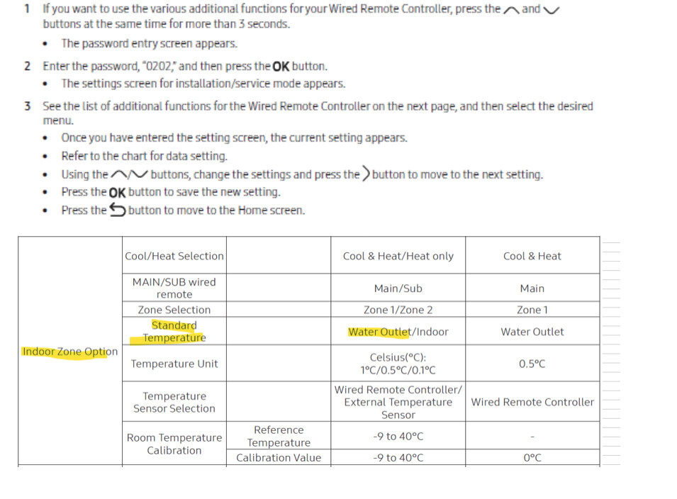

I believe that you can only select Water Outlet control (as opposed to WL control) when no roomstat is installed. I base this belief on two bits of evidence:
  1. The EHS Installer Reference Guide Book (aka Installers Guide) p158 says “When setting standard cooling & heating temperature as indoor temperature, the Auto mode cannot be selected.
  2. UK Helpdesk emailed me the following observation “The only time water law is not in use is when the thermostats are de-activated and the controller set to leaving water temp. The target flow temp can then be manually controlled in the zone section on the front screen, in this set up the system is thermo on constantly and will run to maintain the target flow temp.
In other words (I think :thinking:), if you have a roomstat, then WL is a mandatory control, though you have the different flavours selectable in #2091/2 (3rd party roomstat) or #2093 (WRC). Without WL control, the only available control is a constant target LWT (i.e. irrespective of OAT).

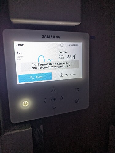

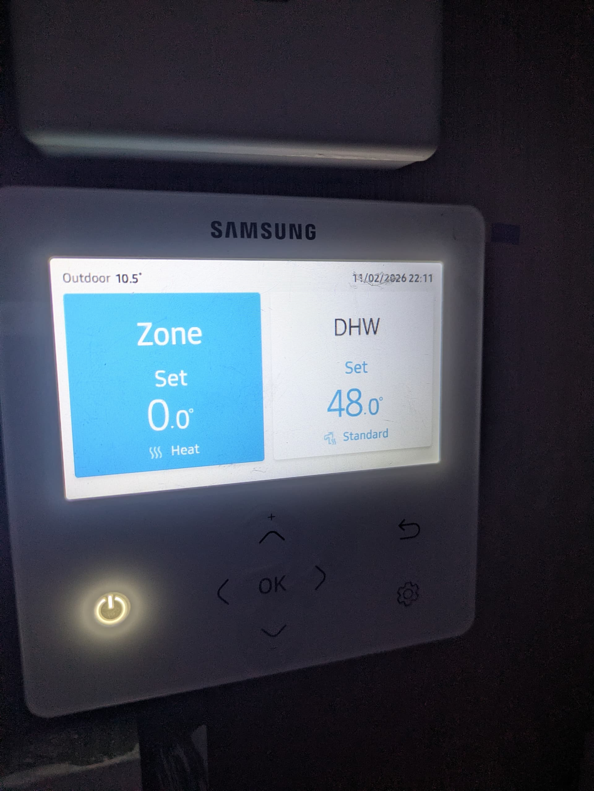

Here is a screenshot which did help me, but I think it gets more complicated with 3rd party stats as these sit over the top of everything.
That’s my home screen. And then the two images below are what comes up if I try to select either Water Law on there or Heat on there. i.e. you can’t change anything. But to answer your question no I don’t think the MIM stat comes into play (assuming the MIM stat is the one in that controller) because I have 2091 with an active setting. But that’s a bit of an assumption.

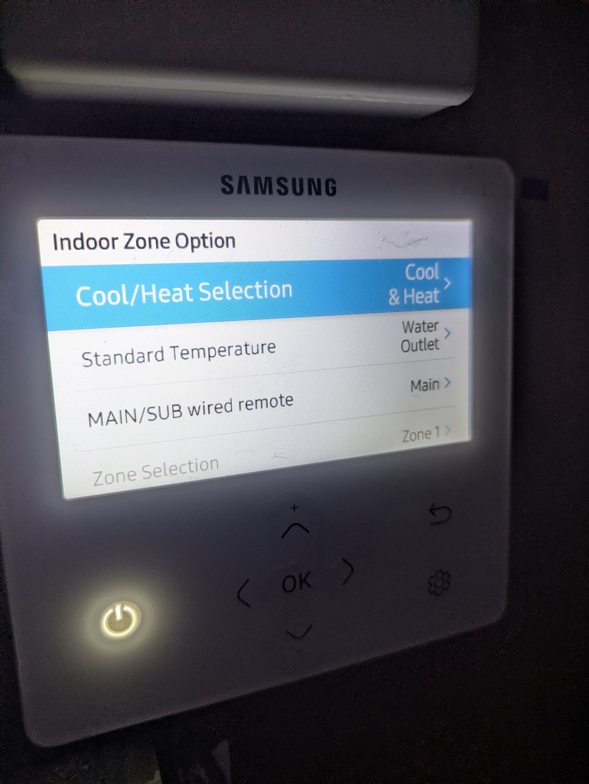

This is what it says in my Indoor Zone Options menu, but I think given what Sarah has said about only being able to select Water Outlet mode if no stats are installed then I think this is probably irrelevant and isn’t actually doing anything to how my system is running…..I think.

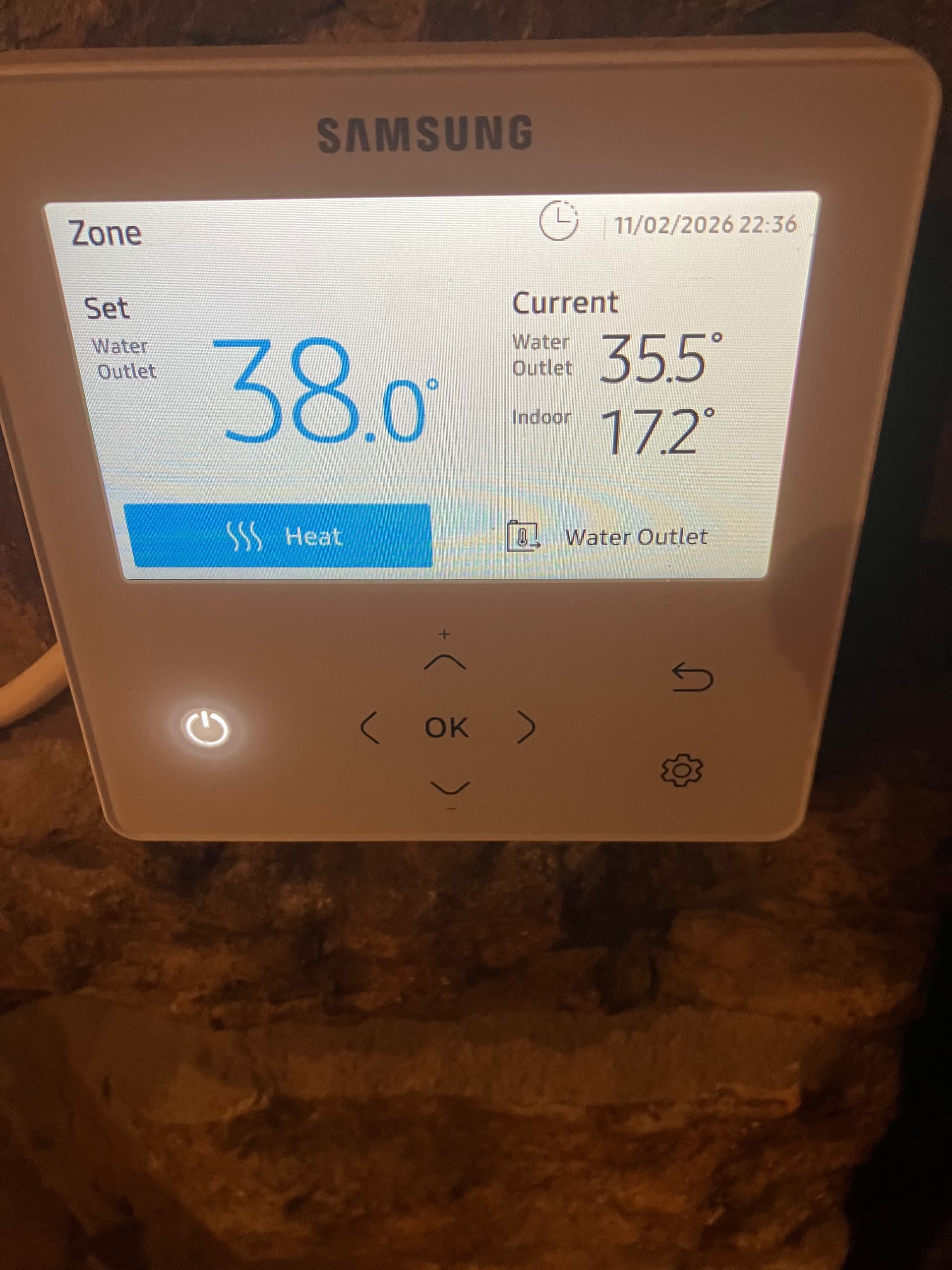

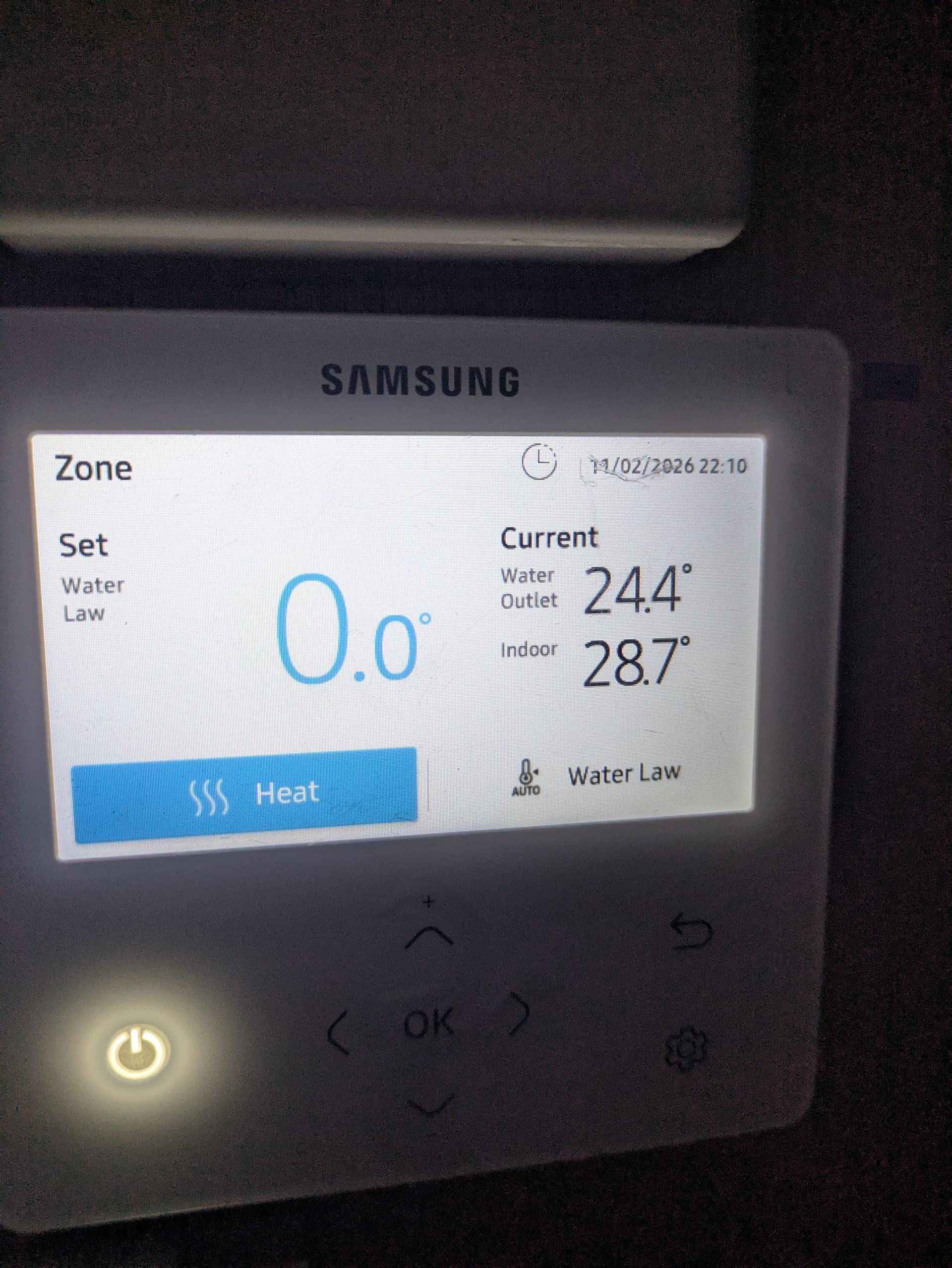

@Kate Your screenshot confirms that you are using water law. However, when I select Standard Temperature = Water Outlet (as you have done), I get a very different display, which allows one to adjust the water outlet temperature and doesn’t use water law.

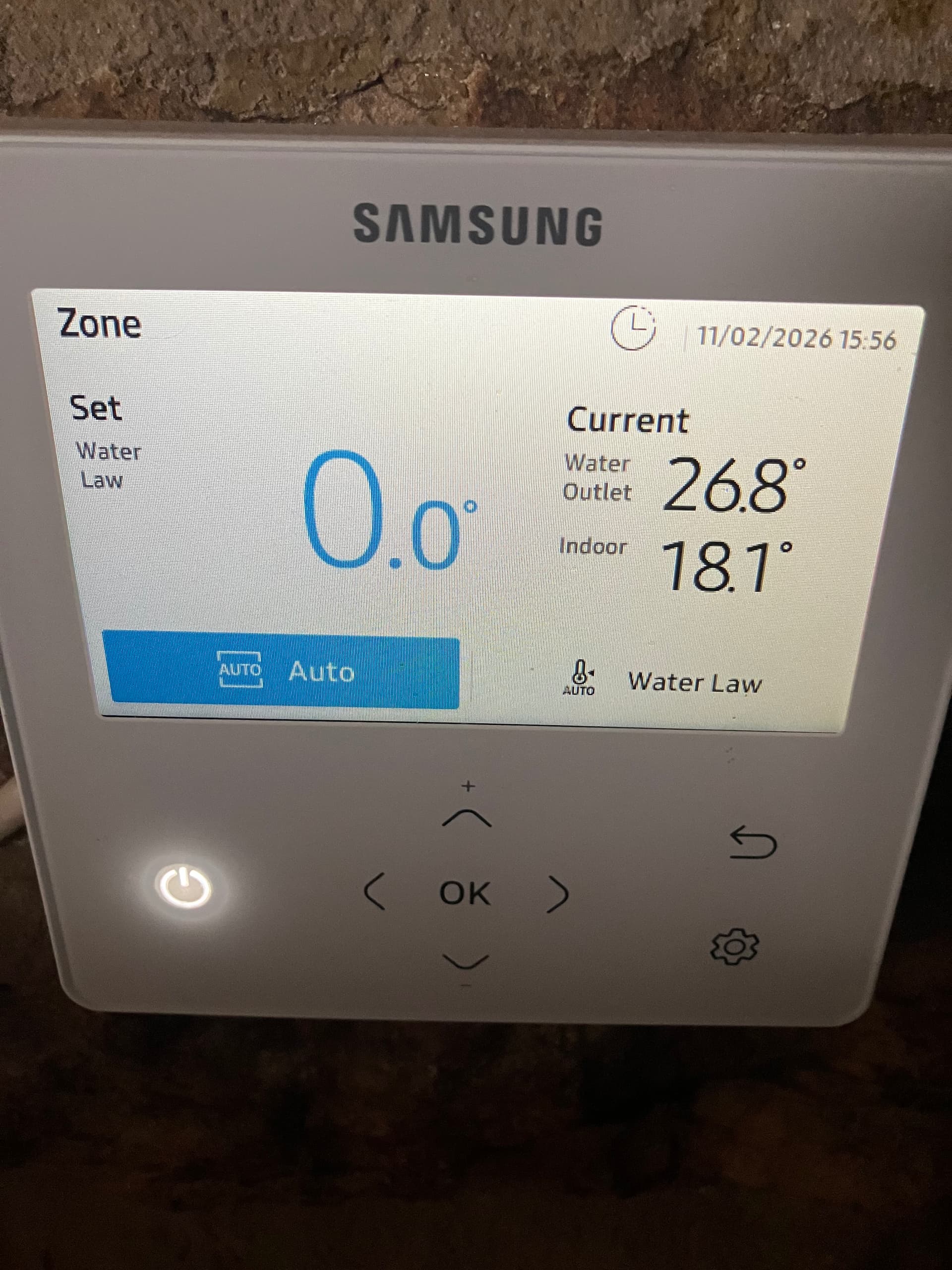

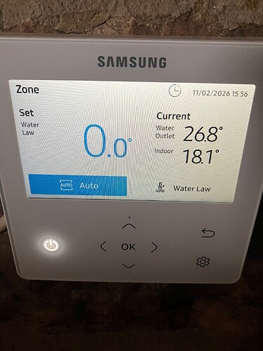

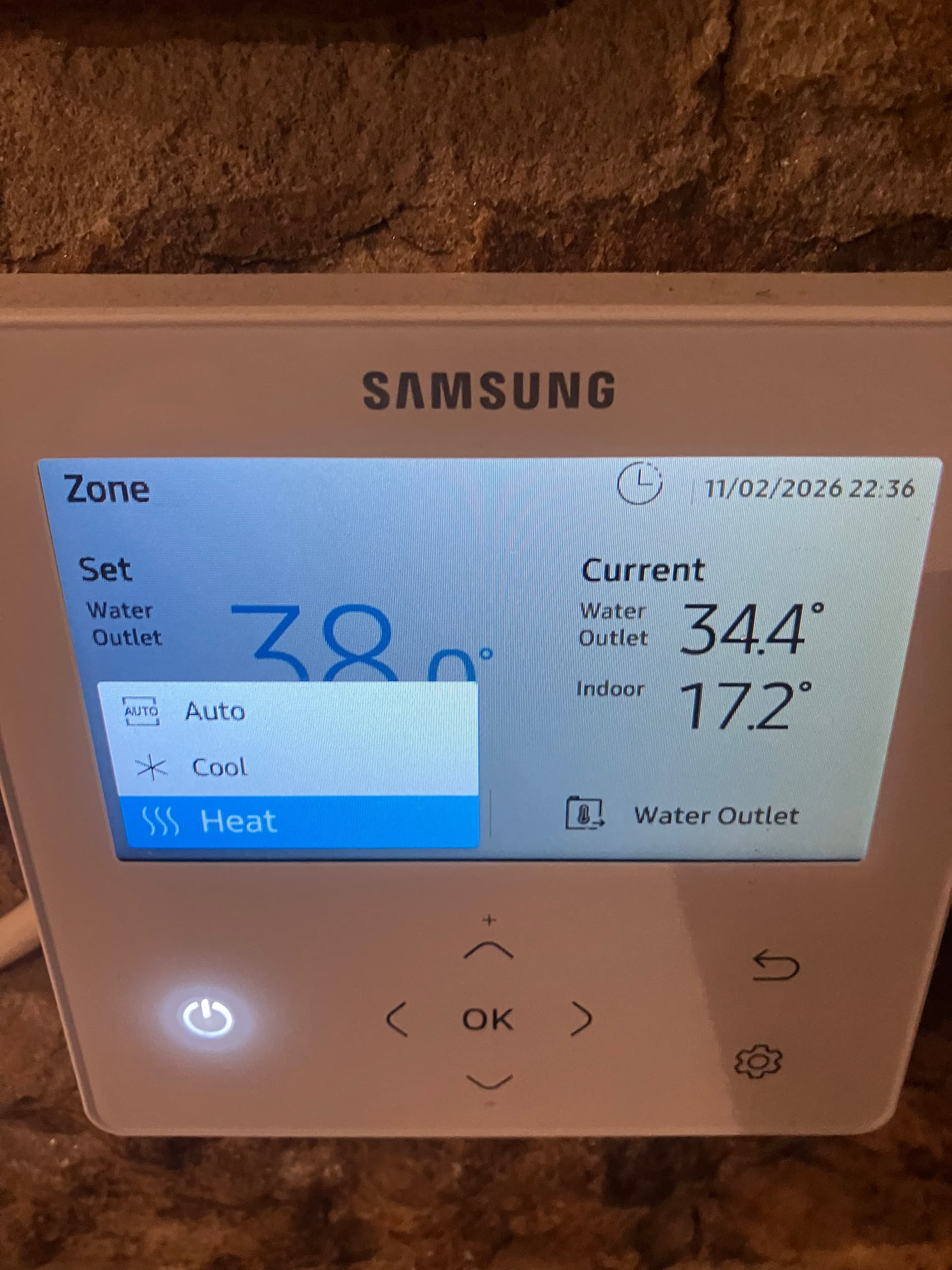

Just to complicate matters further, it is possible to change this mode to auto by pressing the Ok button as in the photo below.
A menu appears and you can then select Auto, whereupon the display changes again and water law is functioning once more as in the photo below.
Only a few people on the forum seem to use Auto, but they quite like it.

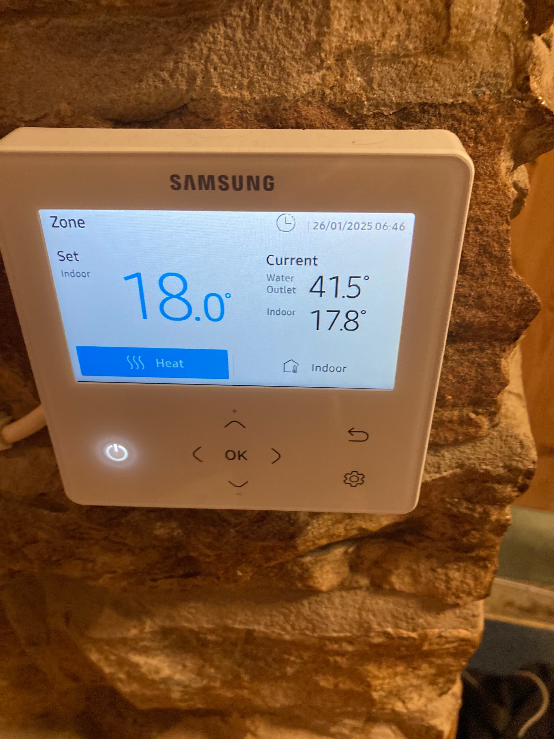

I prefer using the WRC stat (2091/2 = Not use & Standard Temperature = Indoor) as in the photo below.

Hi, after some experimenting I found that the 2093 setting does not affect the availability of Auto. Standard Temperature has to be set to Water Outlet and 2091/2 have to be set to 0 (Not use).
When Standard Temp = Indoor (my default setting) then Auto is not available whatever 2091/2/3 are set to.
When Standard Temp = Water Outlet then:

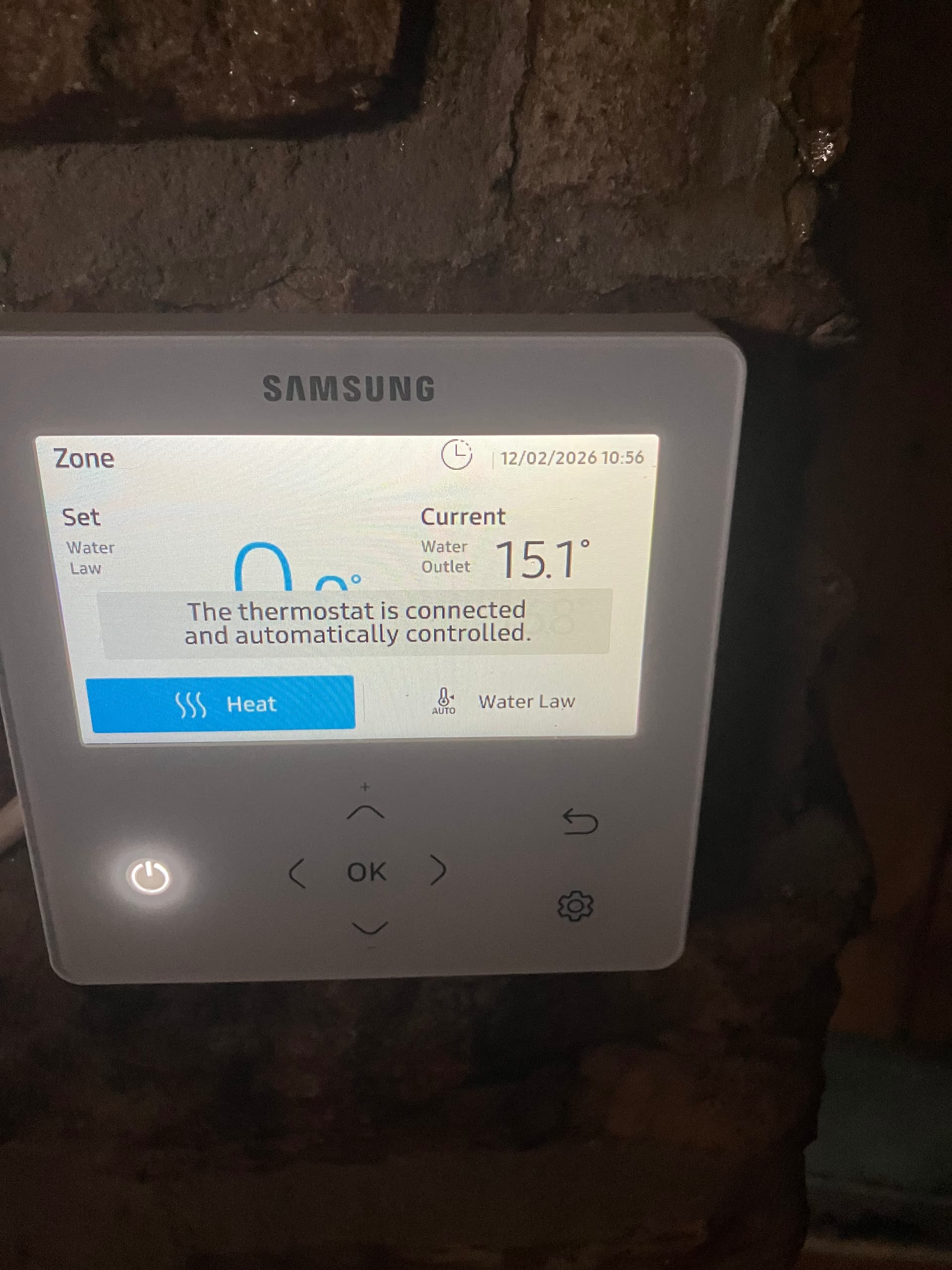

If 2091/2 = 2-4 then Auto is not available when pressing the OK button, but Water Law is active as in the photo below
If 2091/2092 =0 (Not use) then Auto is available irrespective of the 2093 setting.
In conclusion, to use Auto, Standard Temperature has to be = Water Outlet and 2091/2 have to be = 0 (not use)
