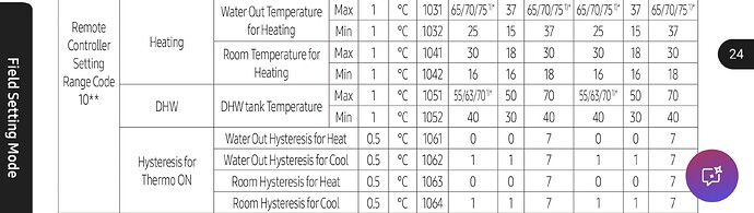

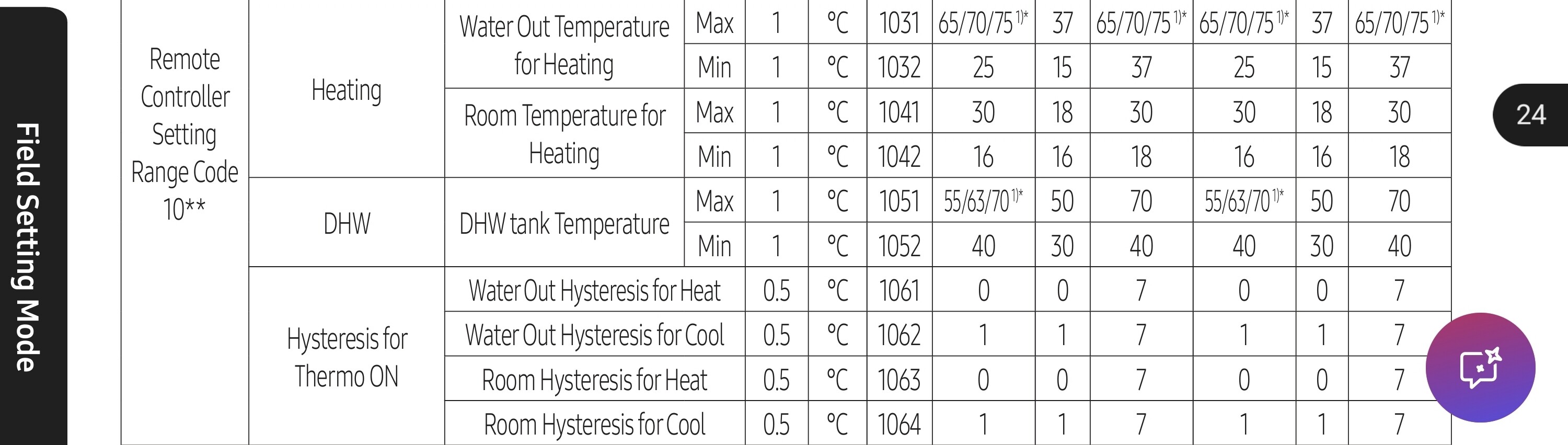

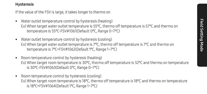

Hi Peter, since my last message, I’ve found a new setting that wasn’t available on the older models. FSV #1061 seems to add some level of hysteresis to reduce recycling. I set mine to 4 this morning (which seemed to have no effect), and set it to 7 (the maximum)this evening to see if this has any affect.
I have a homely controller, so have the standard temperature set to WaterOutlet in Indoor Unit Options, so suspect #1061 will work for me, while it wont for others if they are using the indoor temperature.
